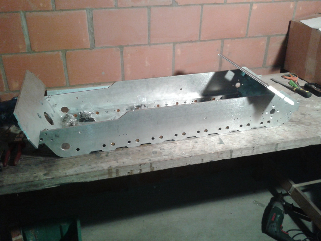

Hello,
Here are the first pictures of my panther
Tomorrow new pictures.
Regards Yves

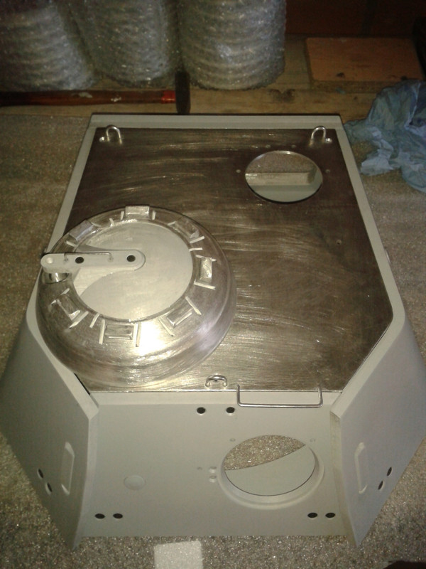

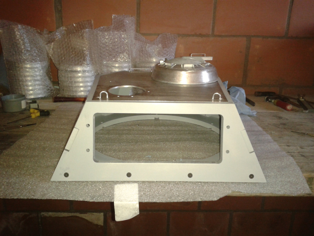

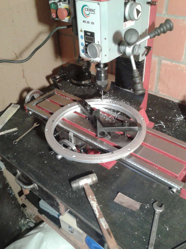

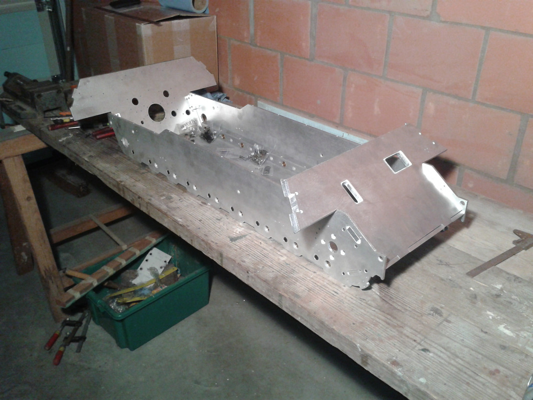

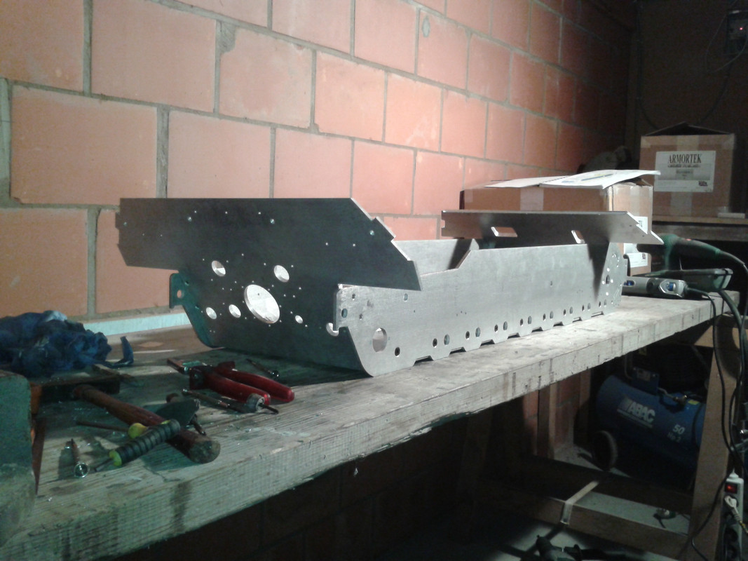

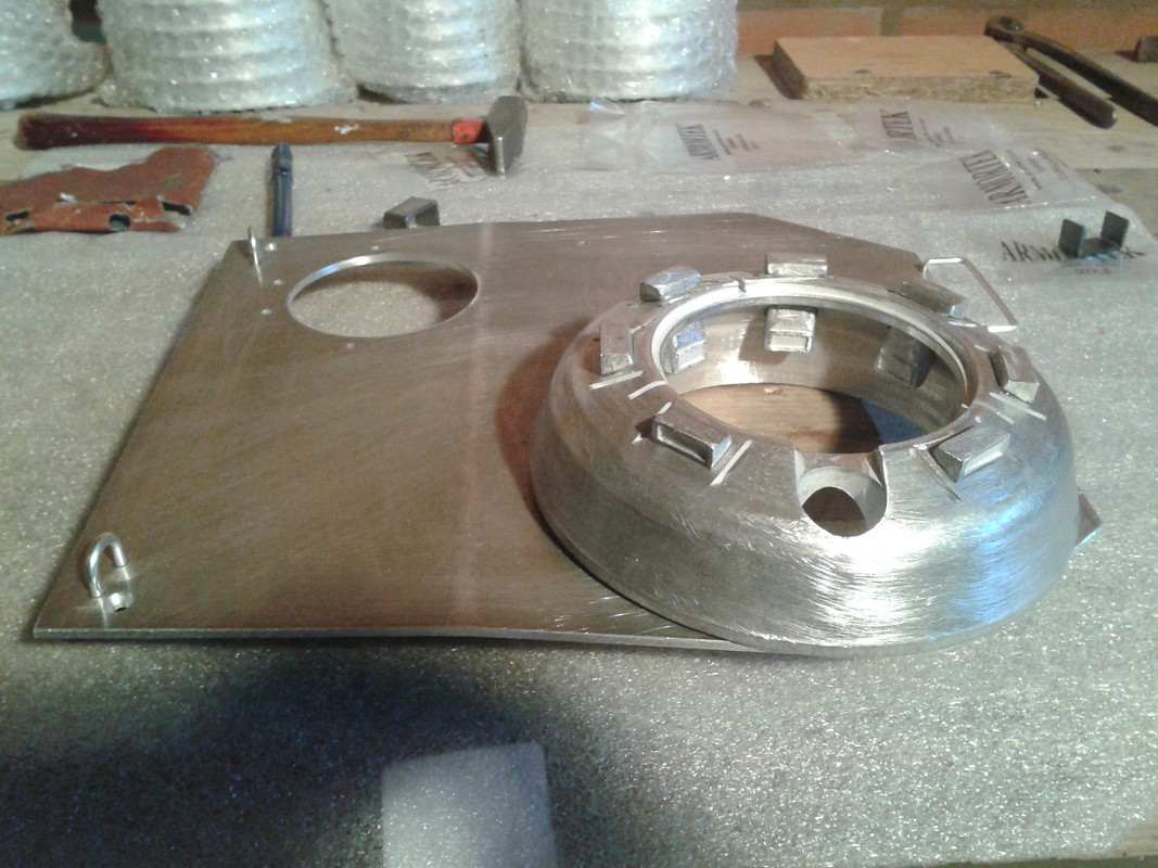

Hello,
Here are some new pictures of the work on my panther.
Did a modefication on the gear, spacer rings for turret rotation, i drill extra holes
to put the rings together, so if i wanted to loose the turret i have only to unscrew the 6 wingnuts.
I also countersink the bolt in the rear deck.
I put the turret parts in primer and put them back together.
Also started on the turret roof and copula.
Regards Yves

Post by Armortek » Thu Apr 13, 2017 8:47 am
Hi all
The standard kit design of the new turret bearing on the new Panther is the same as that used on Tiger 131. The bolts go in from underneath , through the spacers, bearing ring and gear and a nut is fitted on top. To fit the turret simply lower it onto the projecting bolts and secure with the wing nuts. There are cut outs on the underside of the floor to clear the first nuts.

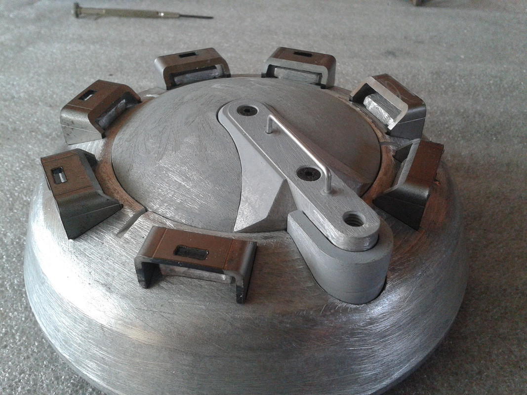

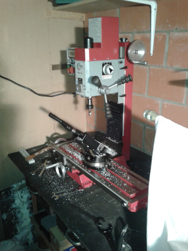

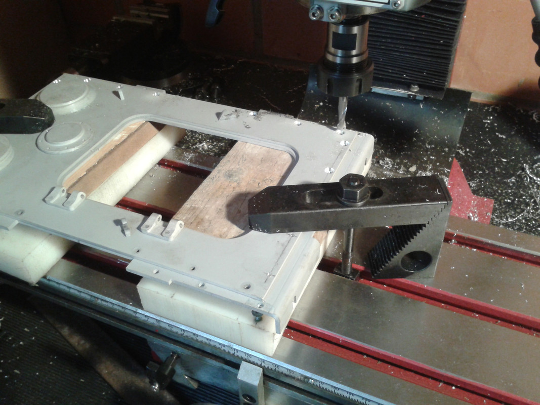

hello,
A few pictures, work on the scope covers for the copula,
with my mill machine.
Regards Yves
