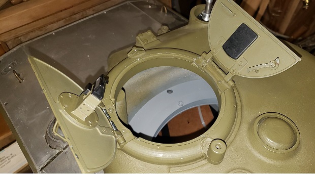

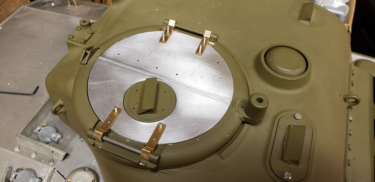

I decided to give my 2006 Sherman some attention. Its been neglected for too long. Perhaps I can finish it this year. :?

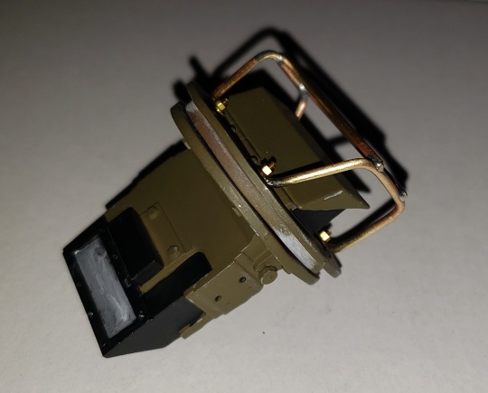

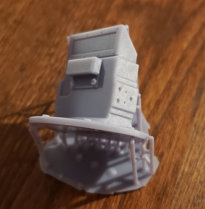

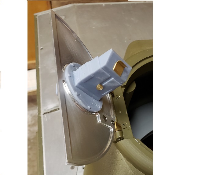

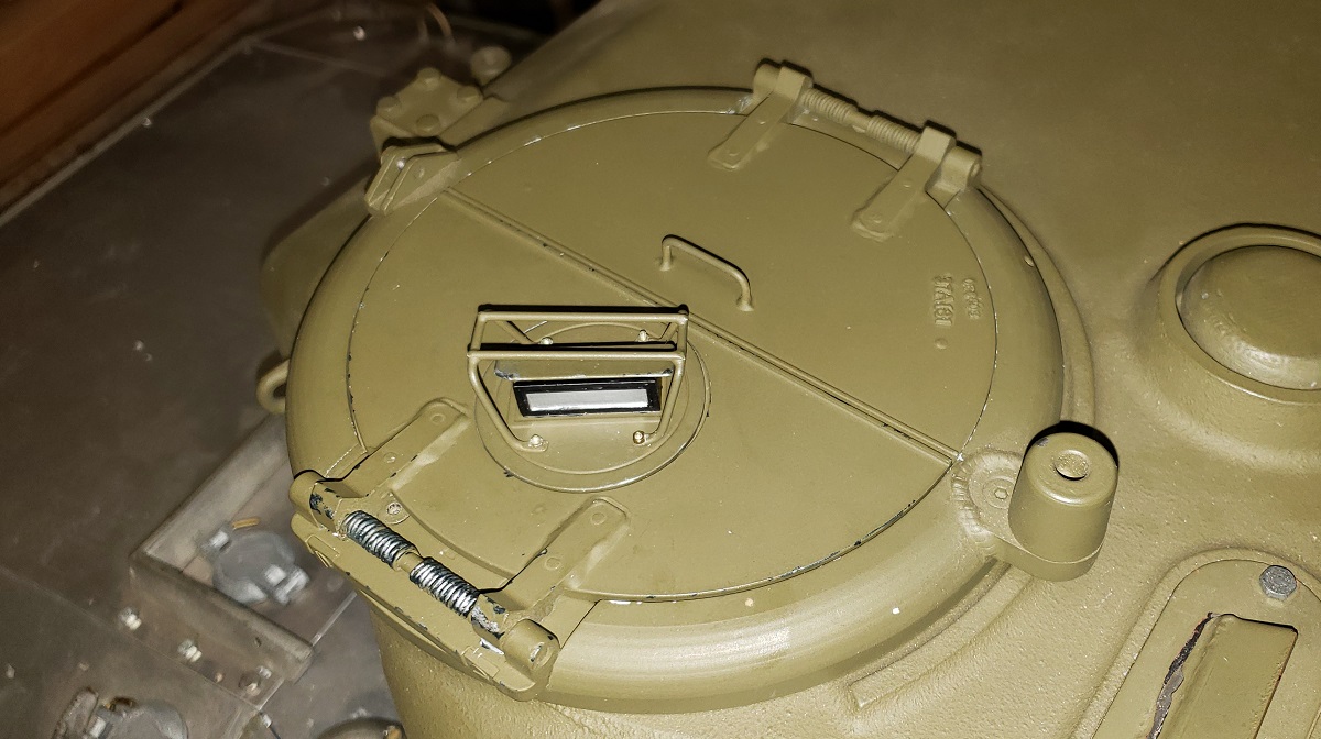

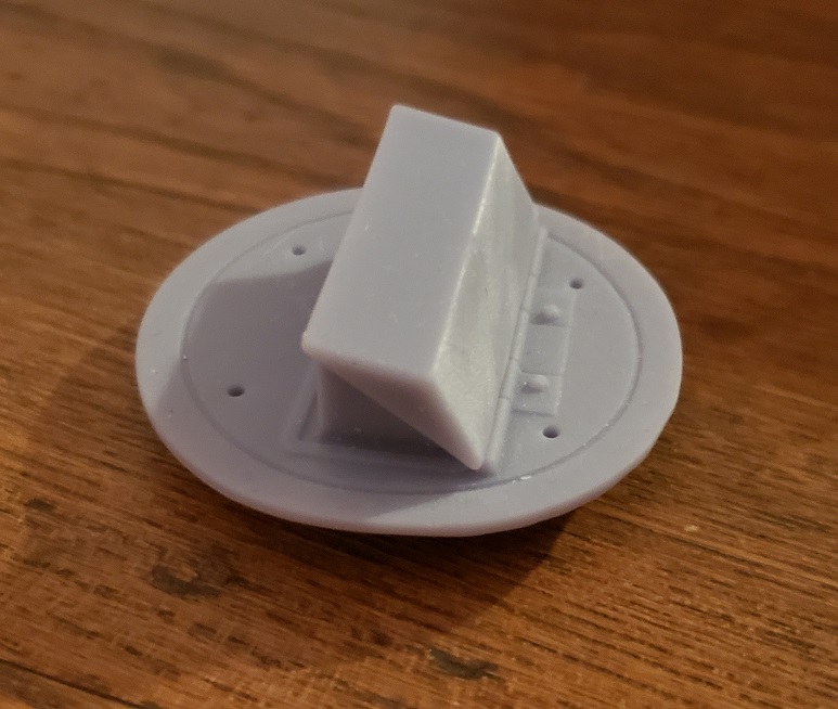

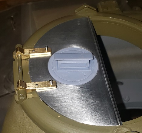

First up was some new commanders hatches from Alum. Along with some resin printed periscopes. Not 100% accurate but big improvement. Thanks for looking.

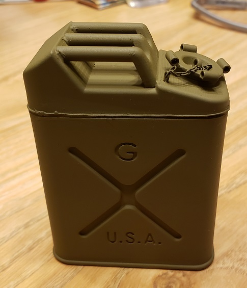

Printed some accessory gas cans...

That periscope looks great. Which printer are you using?

Hi Vince, thanks for looking. I have an Elegoo Mars. It does a great job once you get the knack of supporting the parts correctly. These parts are not even printed on the higher resolution.
