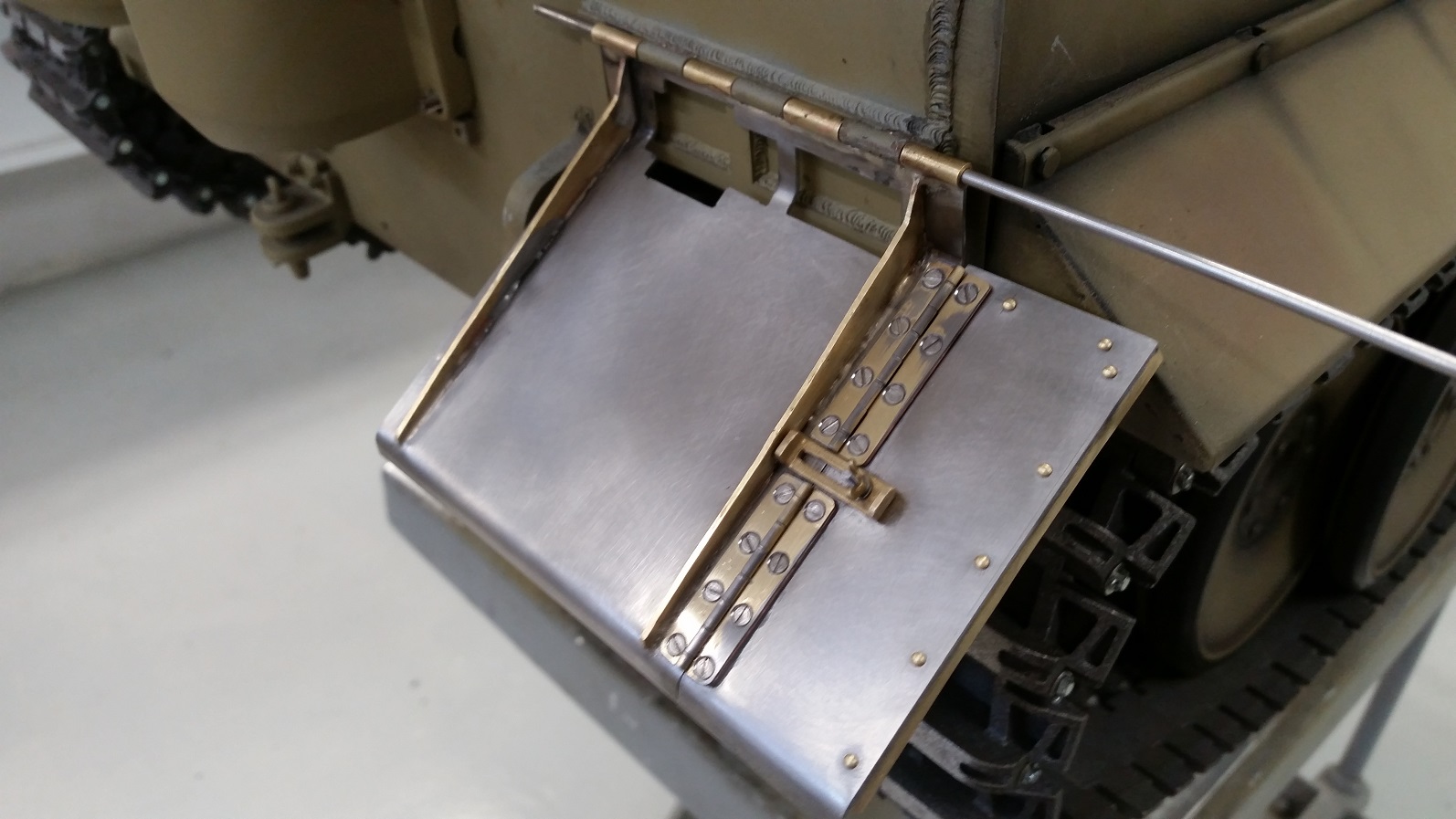

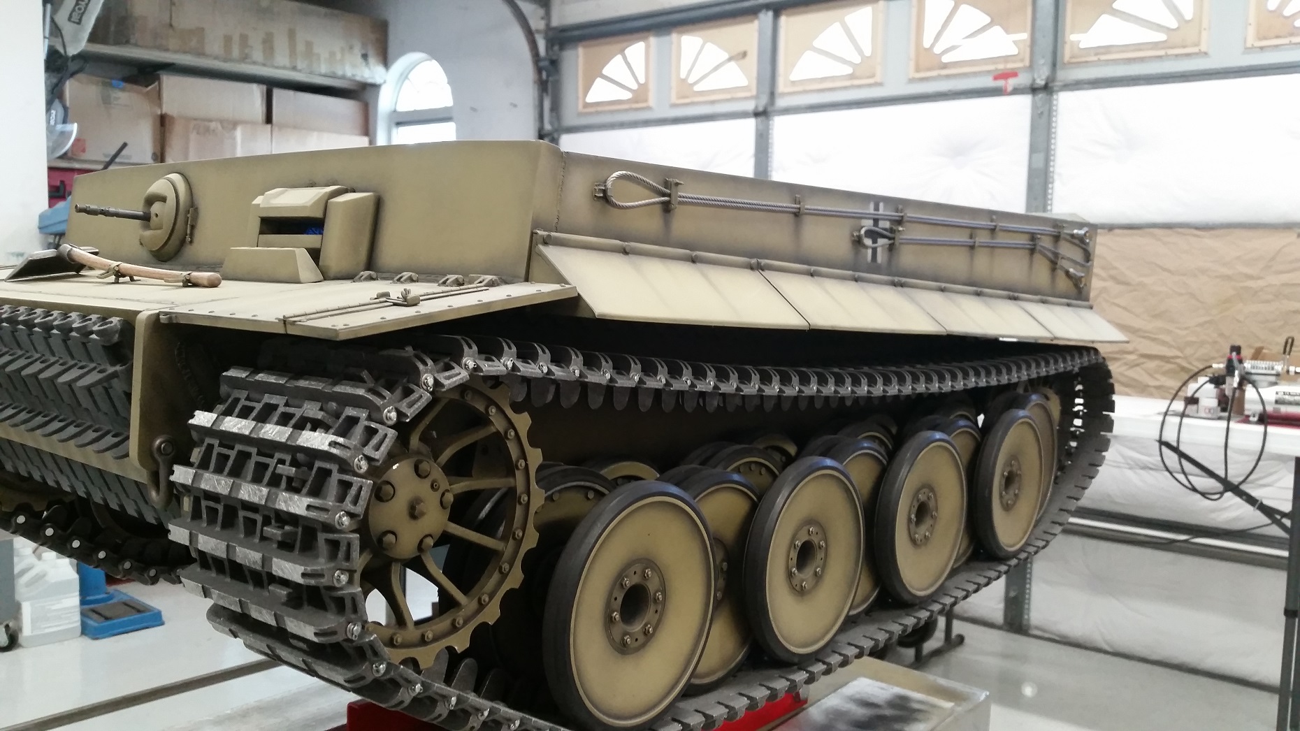

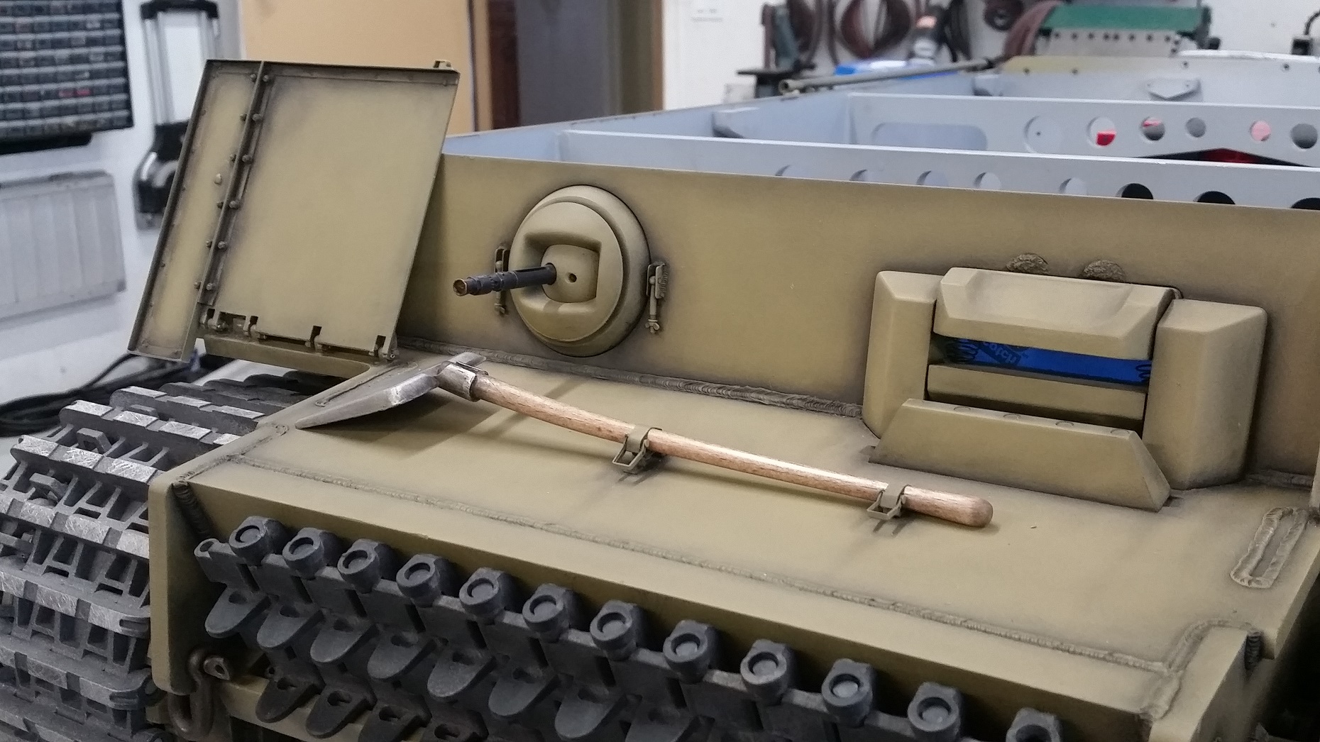

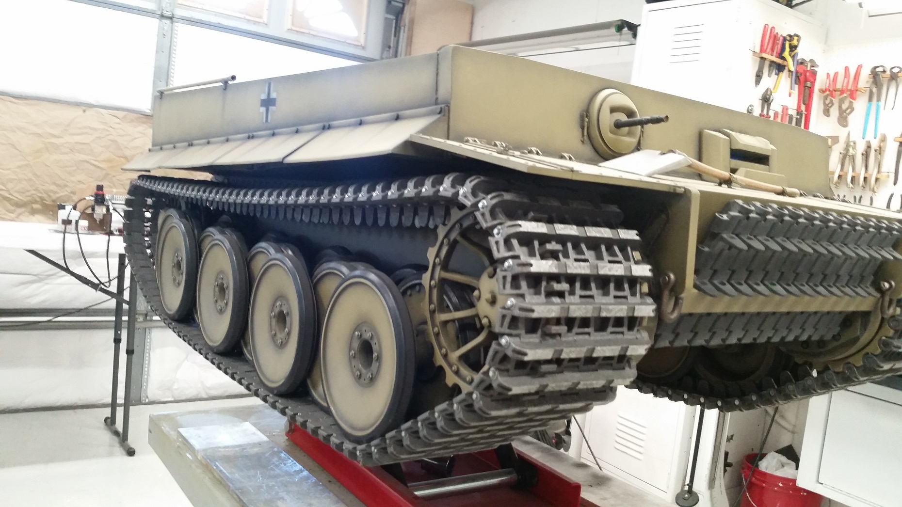

Front...sides done....started work on arse end....mud flaps 1st as most time consuming

I'm not sure of the etiquette. OK if I copy the way you have kept your electronics tidy? Mine looks like an explosion in a wire factory.
Lovely build!

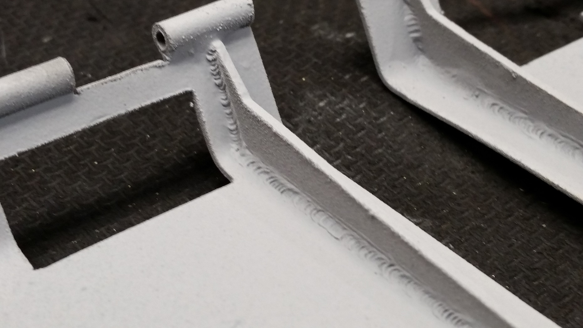

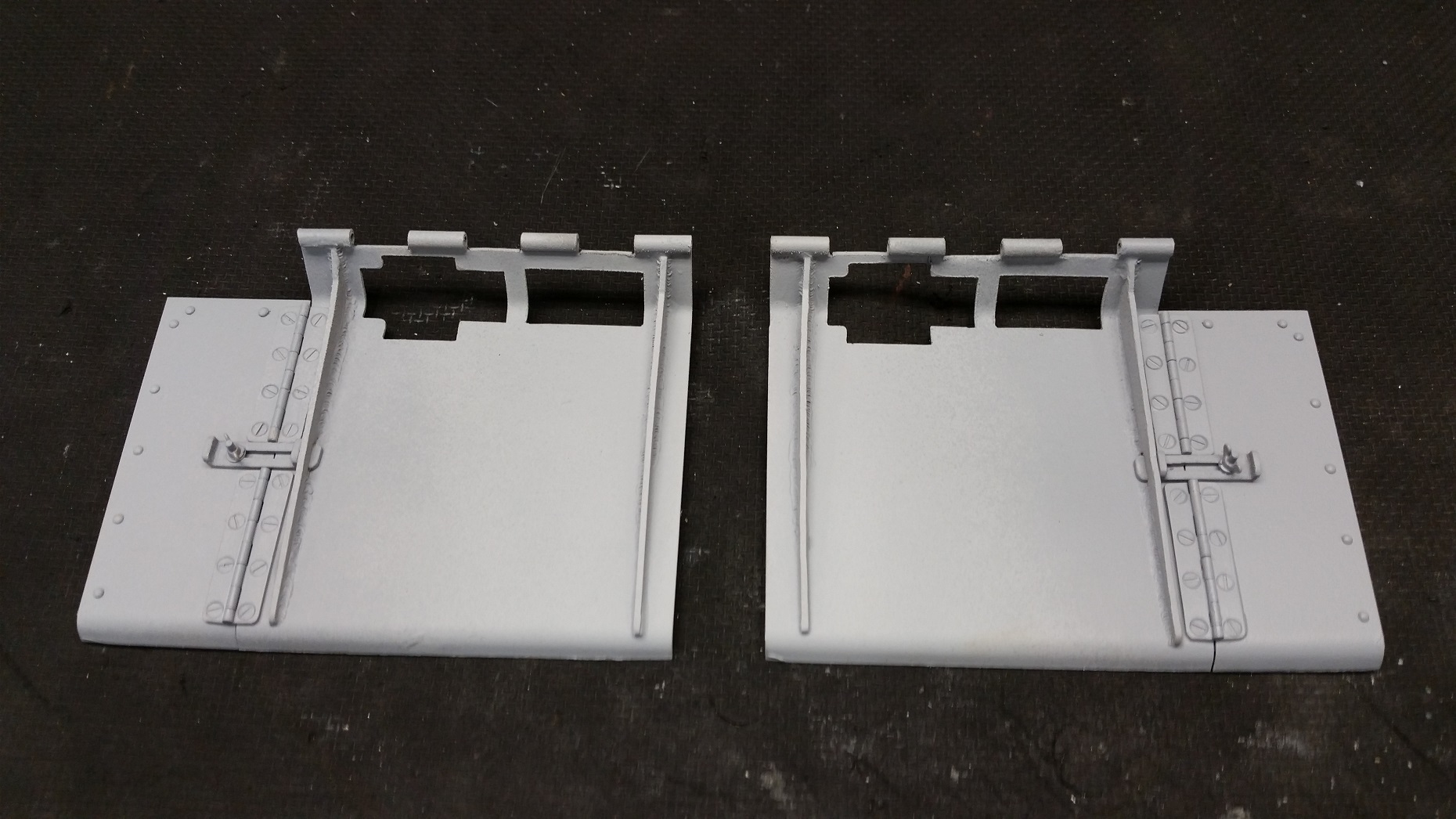

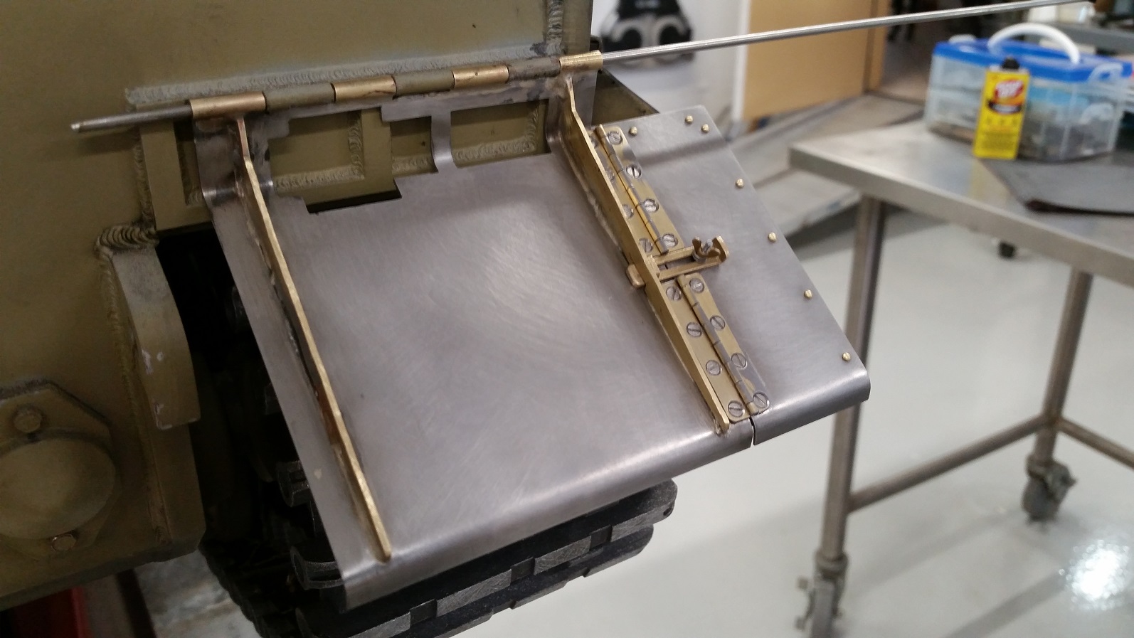

Rear flaps done ...hard or silver soldered.. much stronger...glad they are done as my eyesight sucks anymore ! wish I had the sight I had 30 yrs ago....such is age

I tried to replicate your welds. I got maybe two that were acceptable. I am going to take a fresh stab at it today. I did have some issues with mixing, a few welds just never gelled.
Any hints for working with the loctite? None of mine were even close to your quality. I am convinced it is the way to go. It is much tougher than milliput.
The only way I have gotten good looking welds with milliput is to make cartoonish deep welds and then sand them down once cured.

Hi Greg..I use the loctite for the small welds ( as on the rear mudflaps I'm about to post pics of) the larger welds I use A&B epoxy putty...trick with the loctite is waiting for the correct time to texture ...varies due to temp how well mixed etc...I start playing with it at around 2 hrs ..if I texture it and it (melds) back to being smooth again I give it another hr...hope this helps you

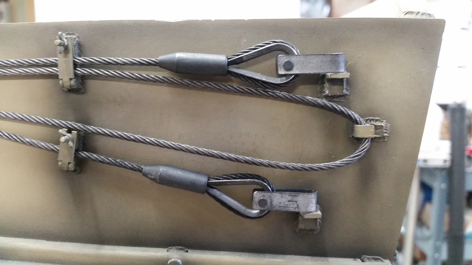

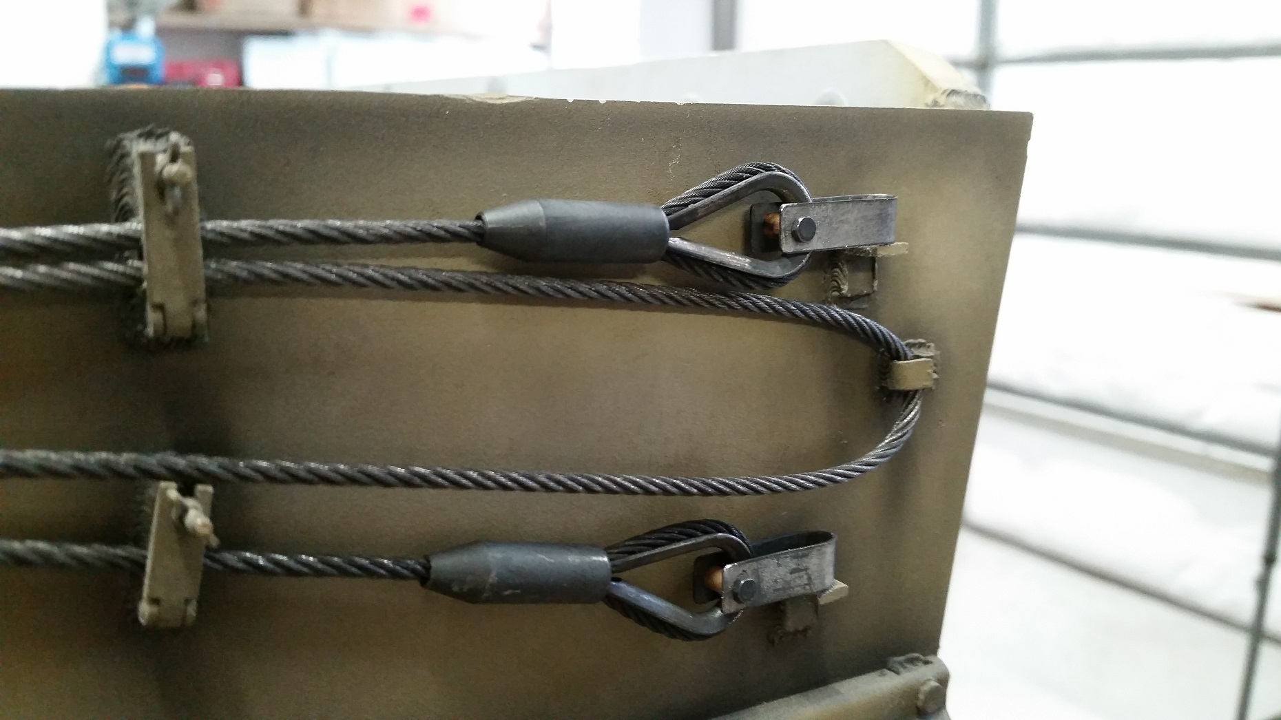

Added welds and primered rear mud flaps...I also messed around with weathering the track cables...I like using stainless steel as one it doesn't rust... two it silver or hard solders up well ....the ferrule on track cable was silvered soldered rather then swaging which doesn't look right...only thing about stainless is it's difficult to weather so I tried a product from Caswell...stainless steel blackener...I'm very happy with the results .. before and after pics...I will use again on the towing cables...

Awesome Fenders. I managed to get mine "close" to your quality. I cheated and got a resistance soldering gun. I highly recommend it.

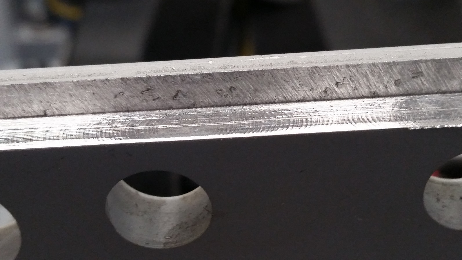

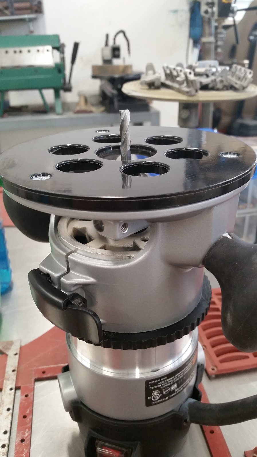

When I started building this kit many yrs ago there was no talk of splitting and lowering the rear deck so that the grills would sit flush...I've been on the fence about doing it as I've done so much on the rear end and would need to do it all over again...I took the plunge...rather than remove the deck support I milled the rear support in place using a router with a 1/4 " 3 flute milling bit...worked well and saved much added work.. had to remake and install sq. head bolt mounts for muffler shroud and air filters.. was tough getting the old ones off and drilling new holes 3 mm lower .. now working on rear plate
