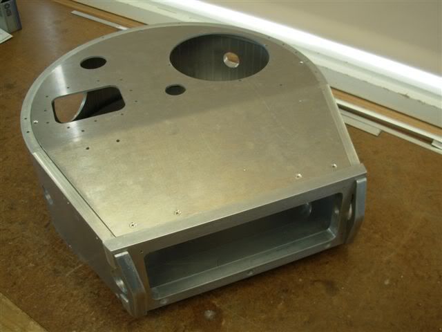

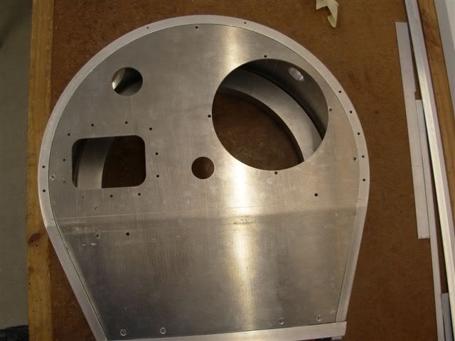

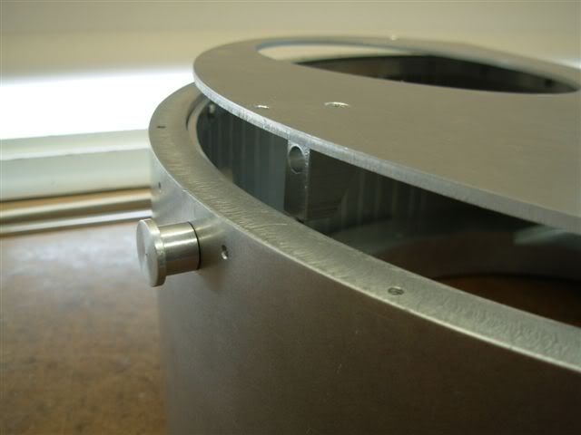

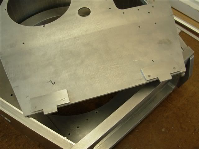

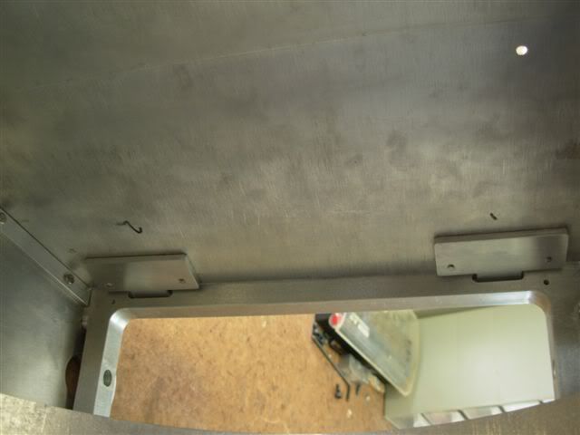

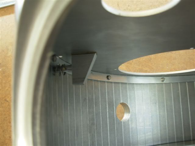

I started my 2010 Mid Tiger 1 kit number 019 this week . For a change I'm building the turret first , here are some photos . I've added a 3mm x10 mm shelf inside the turret rap . Milled two slots in the front inside plate for the roof tungs that are bolt to the turret roof front edge ... Dale
In this last photo I ended up with about a 1.2mm gap all the way around the turret roof this was the best i could get it to fit !! how did the other mid tiger owners go with their gap??

Nice to see you back at on another Tiger! These additions are excellent and a good idea for any builder, not just Tigers. Great to see you back,

Thanks Bob. This kit is going to be great to build after my early tiger . Just finished my spring loaded lifting lug , quick release latch ..Dale

Thats also a good idea to secure the turret roof,
i used magnets to secure the roof.
I see that you are using a spring on the back of the turret wrap,
gives that no problem to pul back the turret lug if you put the
stowage bin on? I wil post you a picture of the turret roof.

Thanks Yves and Brian . I did this on my early tiger it works well , there's enough room when the turret bin is on to pull back the spring on the quick release ...Dale

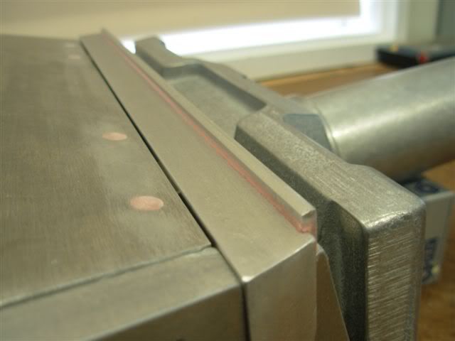

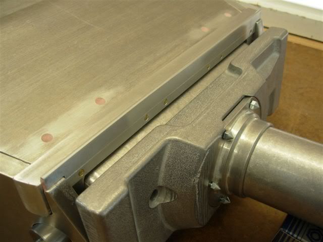

My Last day of my holiday today . So I had one more go in the shed .. Here are some photos of the wipers on the front bulkhead ..Dale

Dale jordan wrote: In this last photo I ended up with about a 1.2mm gap all the way around the turret roof this was the best i could get it to fit !! how did the other mid tiger owners go with their gap??
...Filled with a false weld, as in the real on the rest.

My gap was much smaller - ranging from zero to 1 mm. The instructions call for attaching the mounting sockets to the roof first and then pulling tight from the sides. Done this way, the turret wall is in fact pulled tight around the roof.

Good to here from you Paul ... I found the cast turret was fine . Just hat to belt sand the outside square and move the vison ports . \The good thing about the cast turret was that it had a machined shelf for the roof to sit in . I would cut out a new alloy roof for it !! as the kit one rusts to much and the loaders hatch needed moving forward .. Paul after five years have you pick a start date ? Dale
