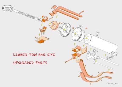

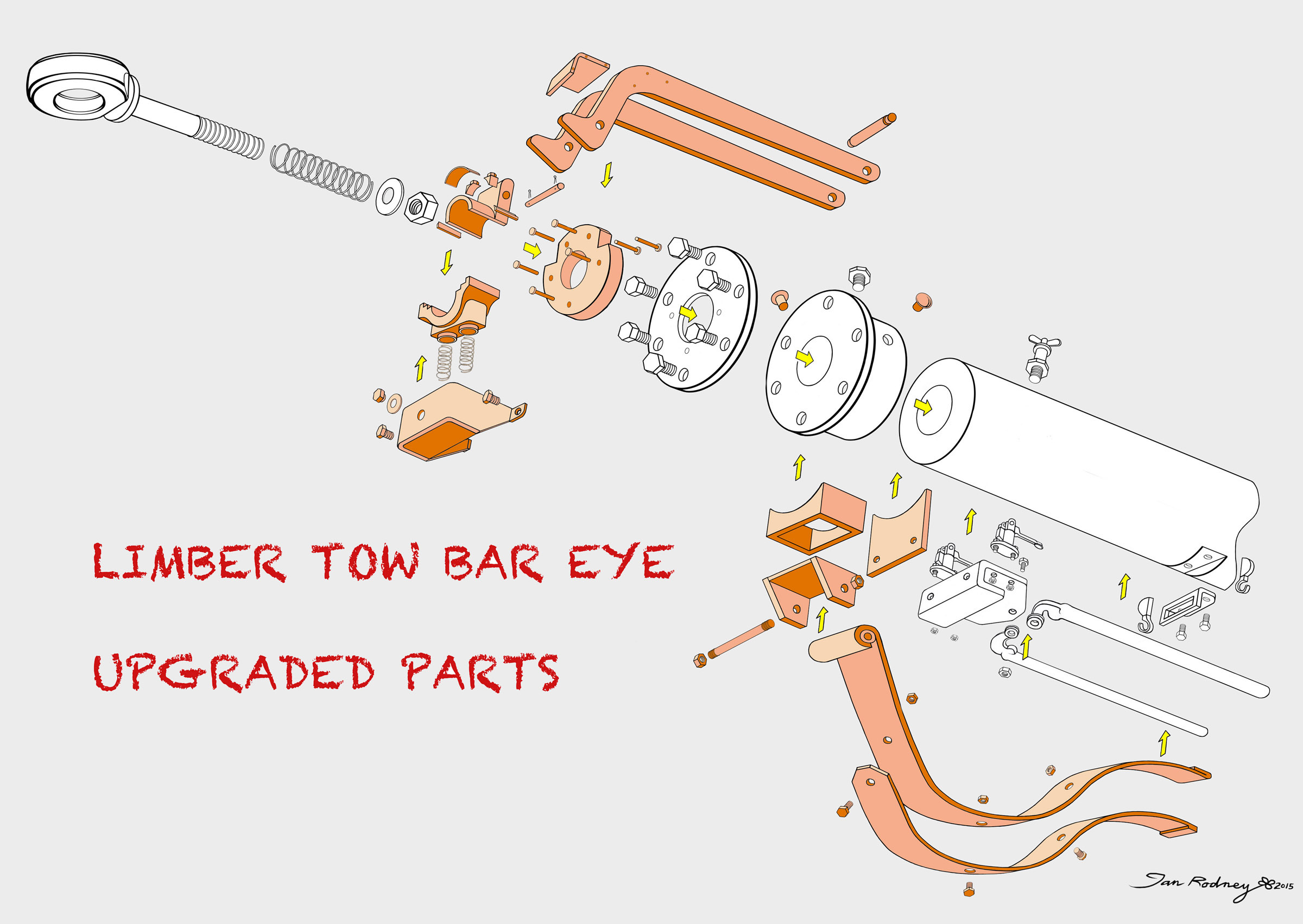

….and now the coloured technical limber tow bar eye drawings…..
Ian

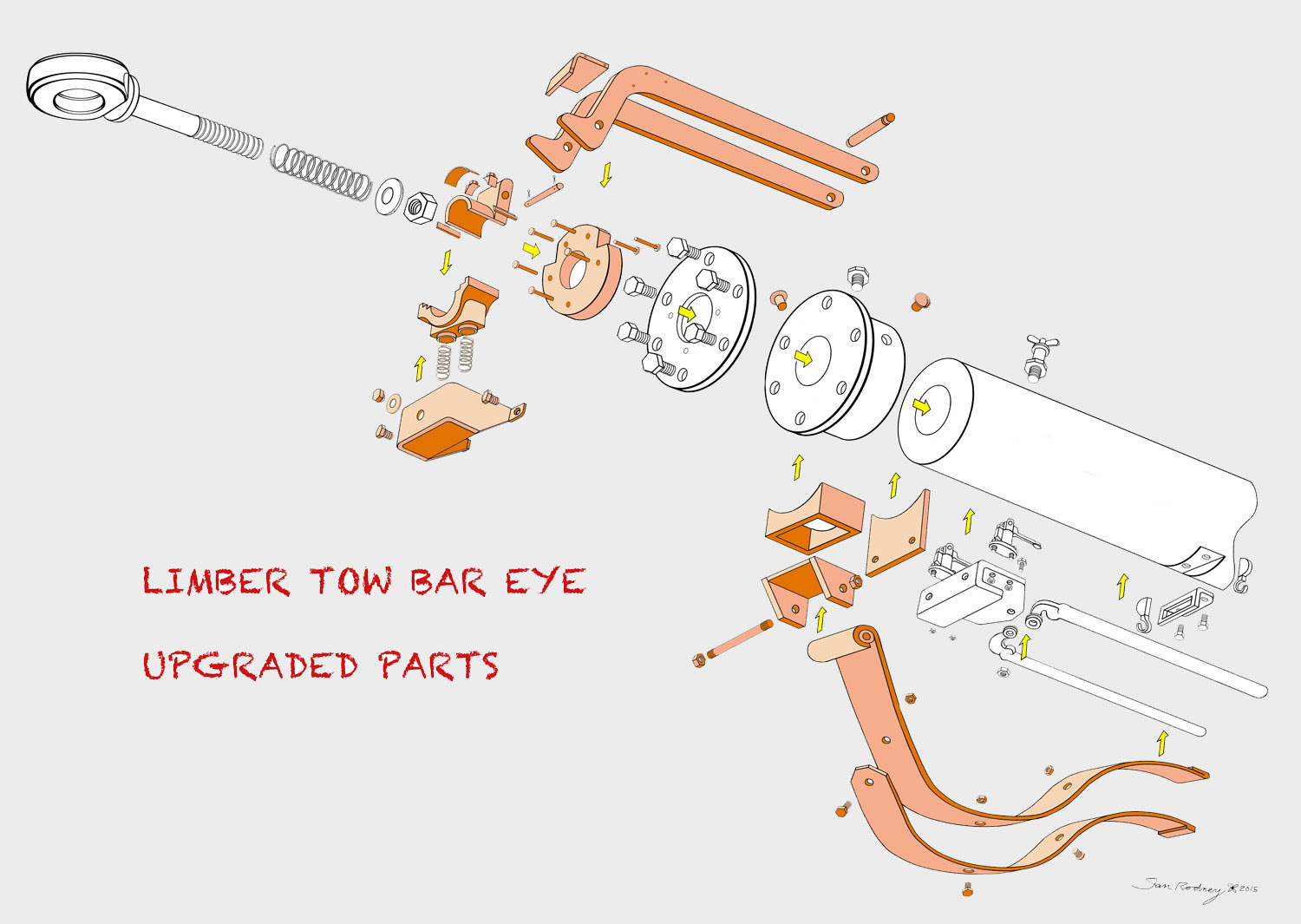

……..just replacing one of my coloured working drawings!!
Ian

Absolutely stunning! What do you use to make these technical drawings?
I am still looking for a convenient way to record the measurements on my research topics. Also for possible later use for example to CNC-machine the part.
Up till now I just add them to the photographs I made of the subject, like below..........
Marcus

Hi Marcus,
I created these technical drawings using PHOTOSHOP…..but all made first by created free hand drawings, then the drawings are scanned in on a scanner, then save them on my mac. Next build up the images on top layer by layer using the tools to create what you see, although using Photoshop is good at certain sizes, but becomes very pixilated if blown up to large, and no use if your looking for fine details to work from!
I could have used a ILLUSTRATOR package which gives a far better cleaner sharper lines, and retains it's sharpness when blown to any lager sizes. Although Illustrator is good it takes time to make drawings using this package. But if I was wanting to produce drawings for publication then I would use Illustrator, saving the art work as PDFs. But even though I have made these drawings using photoshop, I could still save them as Illustrator drawings, but would need to re-create them using Illustrator.
I like using Photoshop, and as you can see does the job well enough for making my technical drawings.
From what you should me in your photograph is a good way of measuring up the parts you want to re-create to make. I can possibly use this same way of creating a photoshop version and create my drawings on top of photographs. Just all depends on what packages you are use too!
I have never used CNC- Machine cad drawings etc. Something I would need to learn to use. But I have seen a good few CNC-cad drawings on the Forum, and look good too.
Anyway glad you like my techie drawings!
Ian

Ian, I'm hooked on your blog, it's always full of inspiring new stuff. I've never seen Photoshop used to create such professional exploded drawings. I have used the technique Marcus describes, to good effect but there are pitfalls in basing a part on 2D imagery, the evidence is in my rejects bin.
With my Cent, I've the huge good fortune to have Allan Bowers make CAD drawings for some critical assemblies. He's a master with Autocad but I suspect you need a lot of determination and time to learn such a full capability package. If you're looking for a freebie programme to experiment with, you could do worse than the package offered by RS Online. It's called Design Spark Mechanical and is available for download here:
http://www.rs-online.com/designspark/el ... mechanical
Google do a free CAD package too but I found it was orientated towards architecture whereas Design Spark is definitely for engineers. Worth a try.
All the best and keep the good stuff coming.

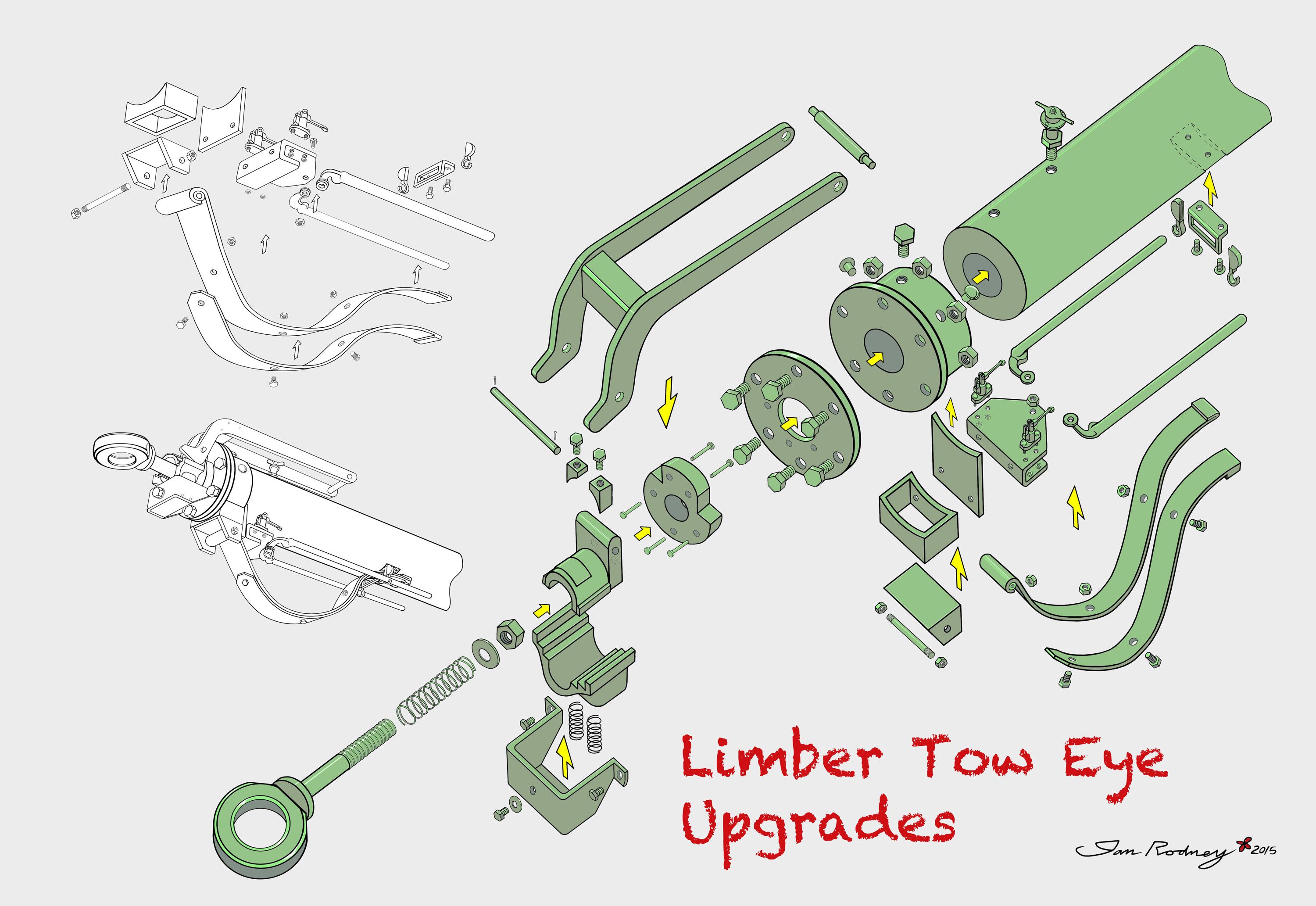

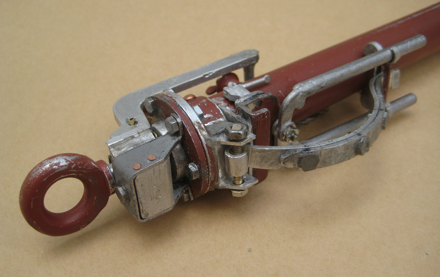

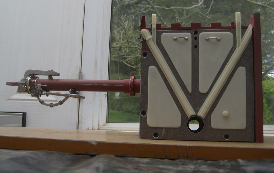

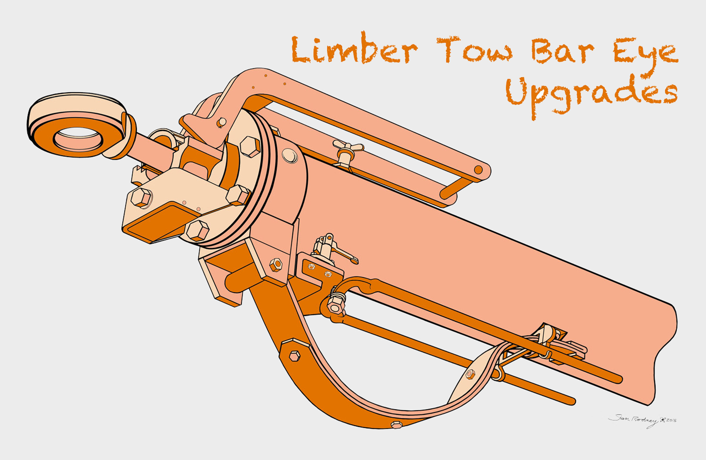

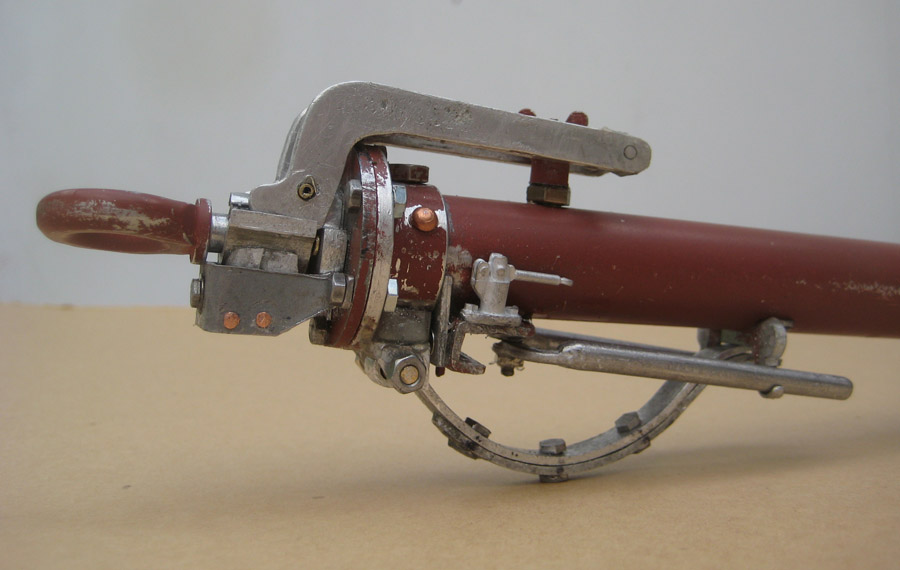

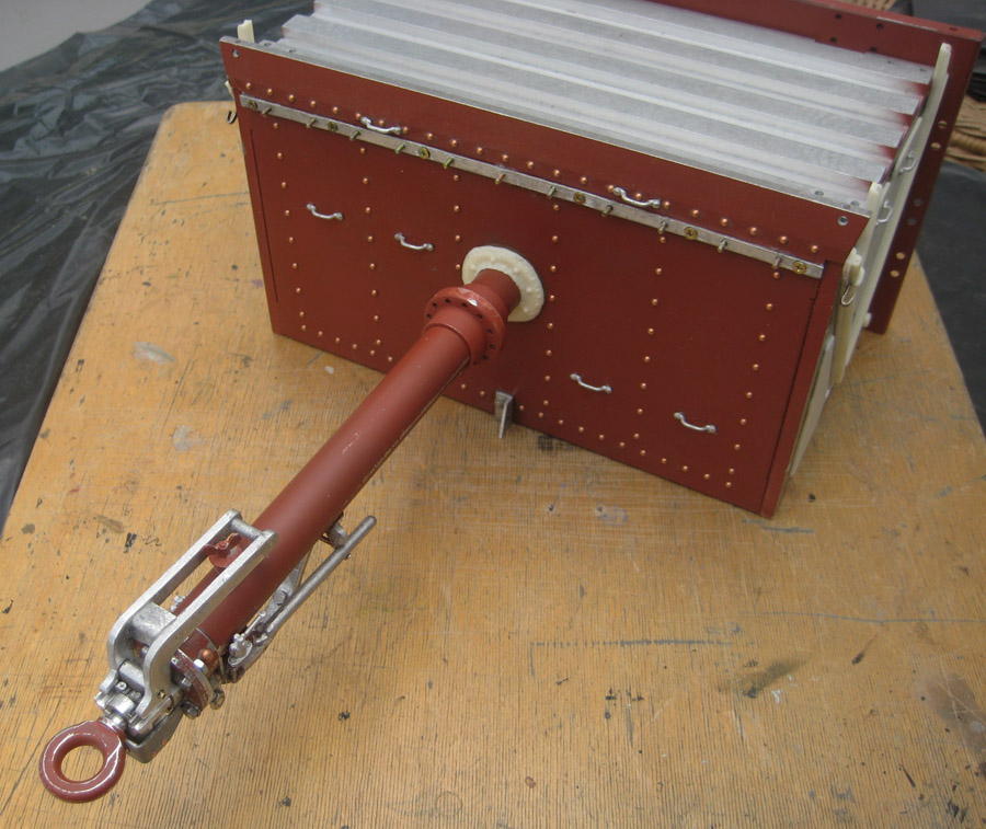

Hi Guys,
Back again with one more techie type drawing of the Limber Tow Bar Eye area, but from a different perspective angle. + a few pics to complete that section of my build. Time to move on and continue with the rest of the limber kit!
Ian

Hello Ian.
Brilliant mate love it the whole thing is just great well done. :)
All the best Paul. :wink:

Thanks Paul,
That's just me, when I think of more upgrades to add I sometimes end up with working techie drawings, which of course slows me up getting on with the rest of the Limber kit!
But haaay I enjoy creating these illustrated technical drawings for all to see, and if it gives other Limber kit owners ideas, then all the better…yes…..
Ian

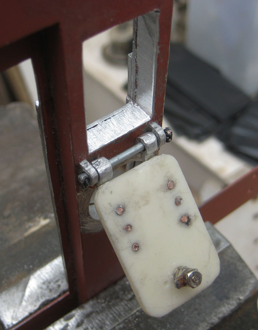

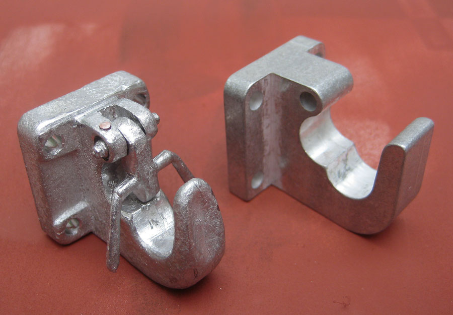

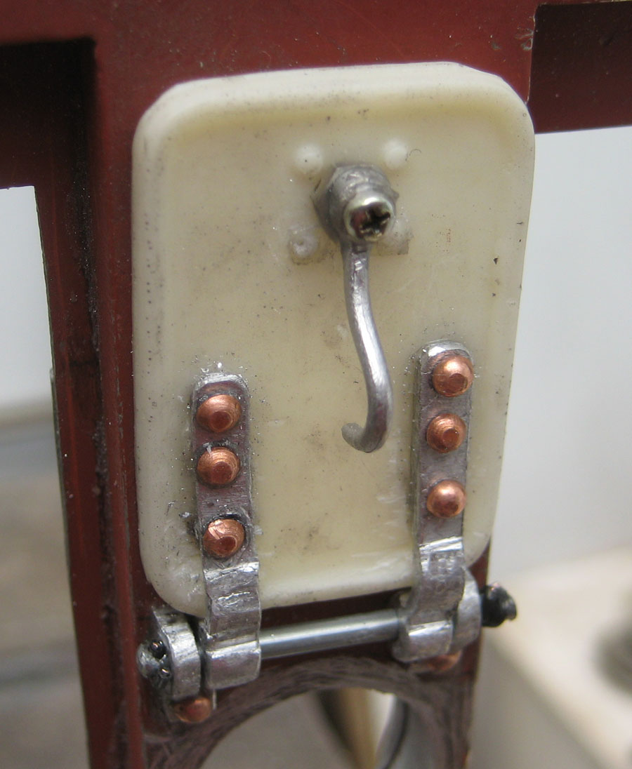

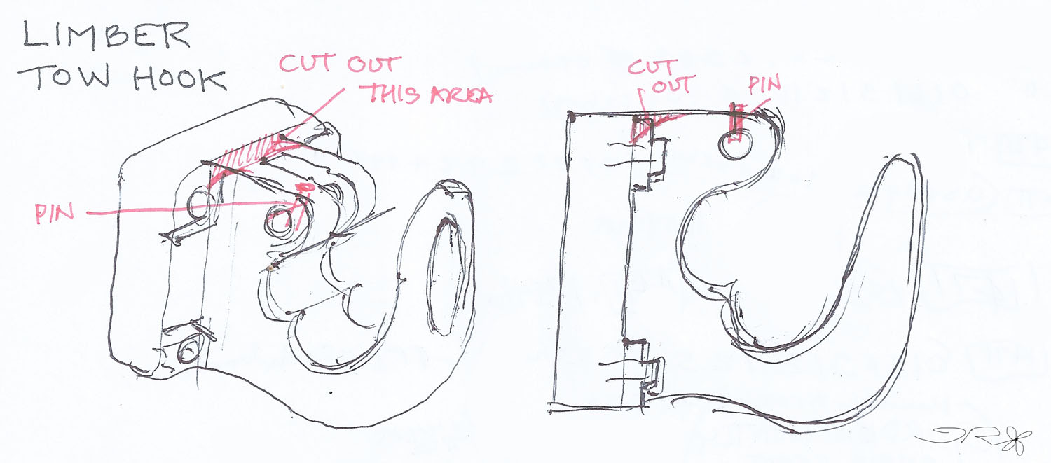

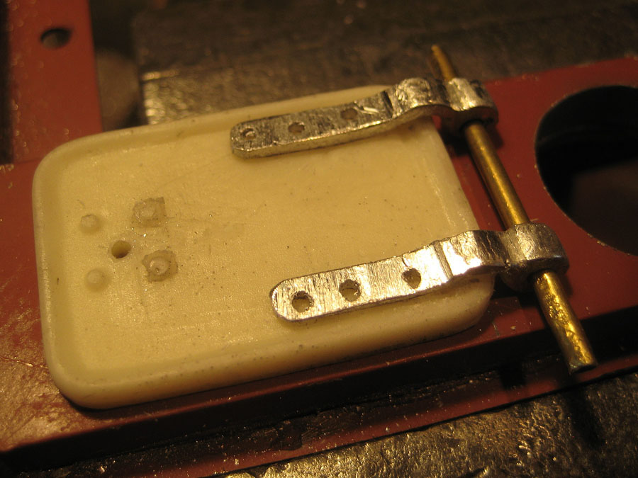

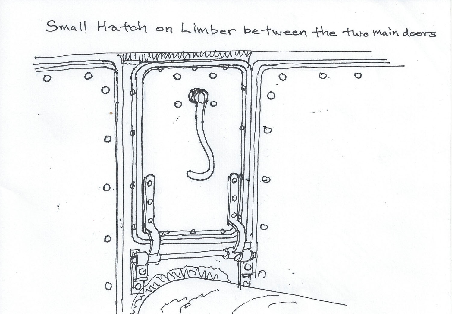

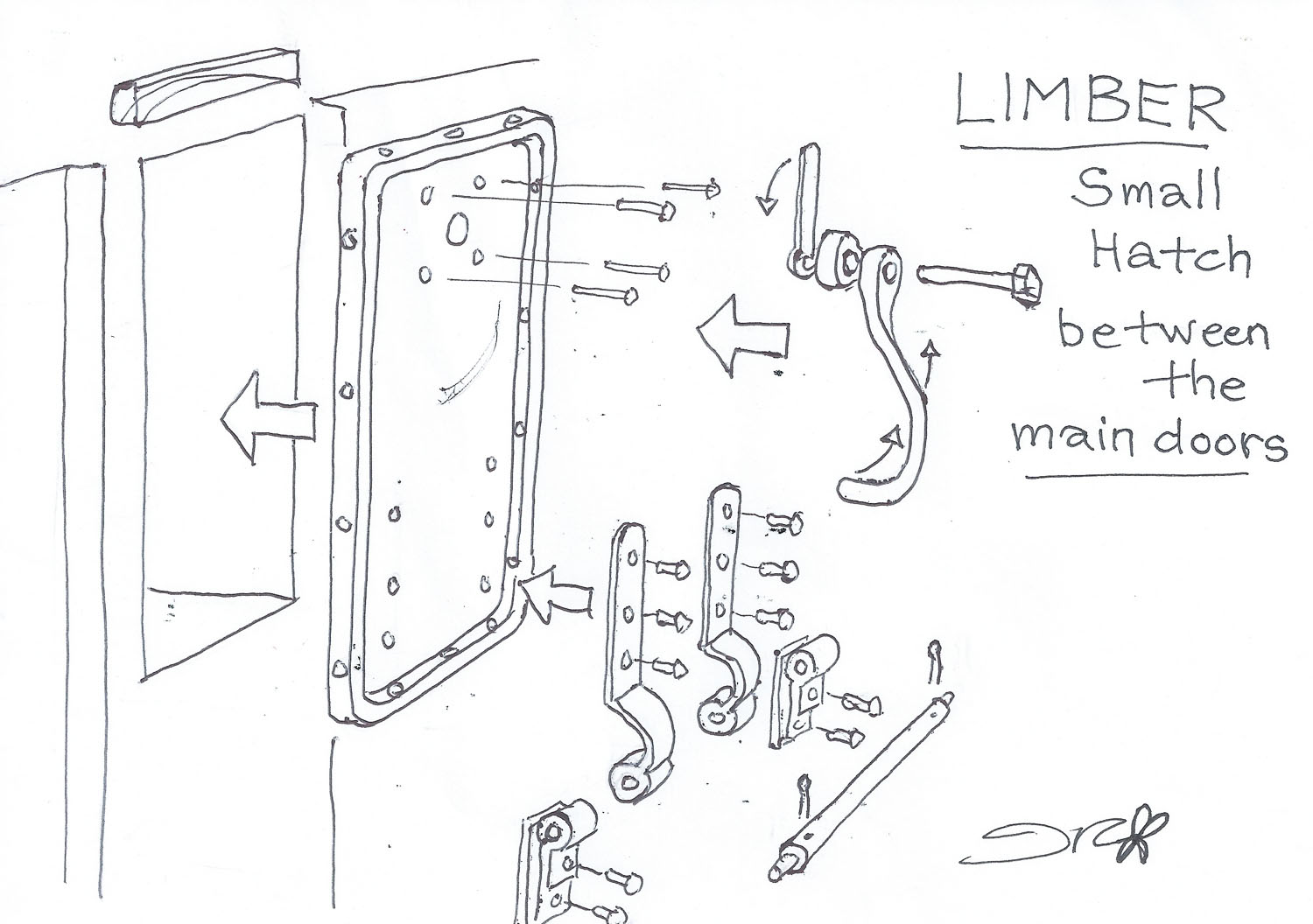

Finally moved away from the Limber Tow Bar Eye set up and did some work on the limber doors and tow hook at the back.

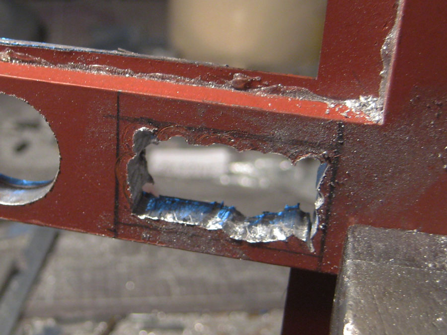

First of all I drilled out and cut a opening space for the small working hatch door, then using Dave's Armorpax upgraded of the small door hatch that sits between the two main doors at the back of the limber I made some alterations to Dave's small door and added new hinges and a working door handle, which turned out not to badly!…I did not want a static one!…...at least I have a working hatch that opens and closes now.
I have still to make a shelf that sits behind the small door, to store what ever the limber artillery men kept inside!

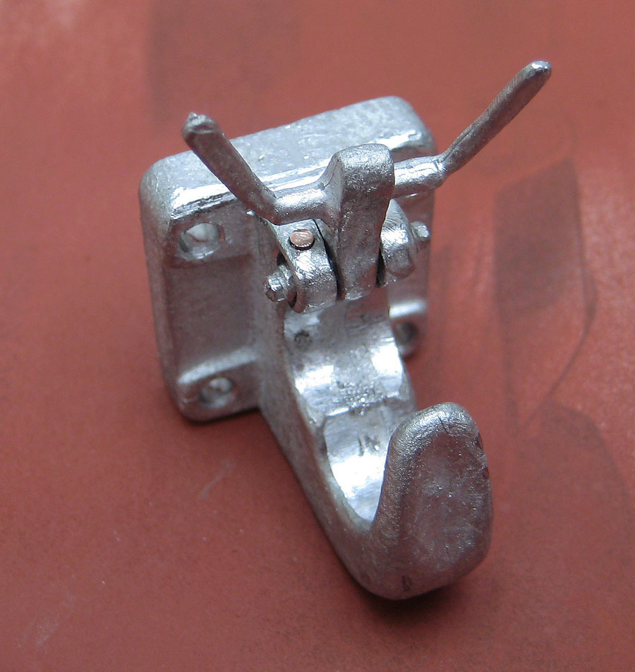

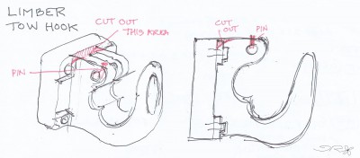

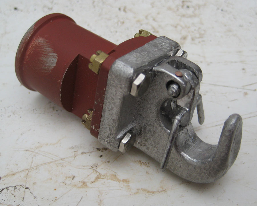

Then I turned my attention to Dave's limber tow hook, and made some small improvements by filling cutting away an area on top of the tow hook and added, drilling out a small hole to retain a pin that holds the tow hook together, apart from that changed four ordinary nuts that holds the tow hook onto the tow block to some of Steve Winston's castellated nuts.
Until next time…….
Ian
