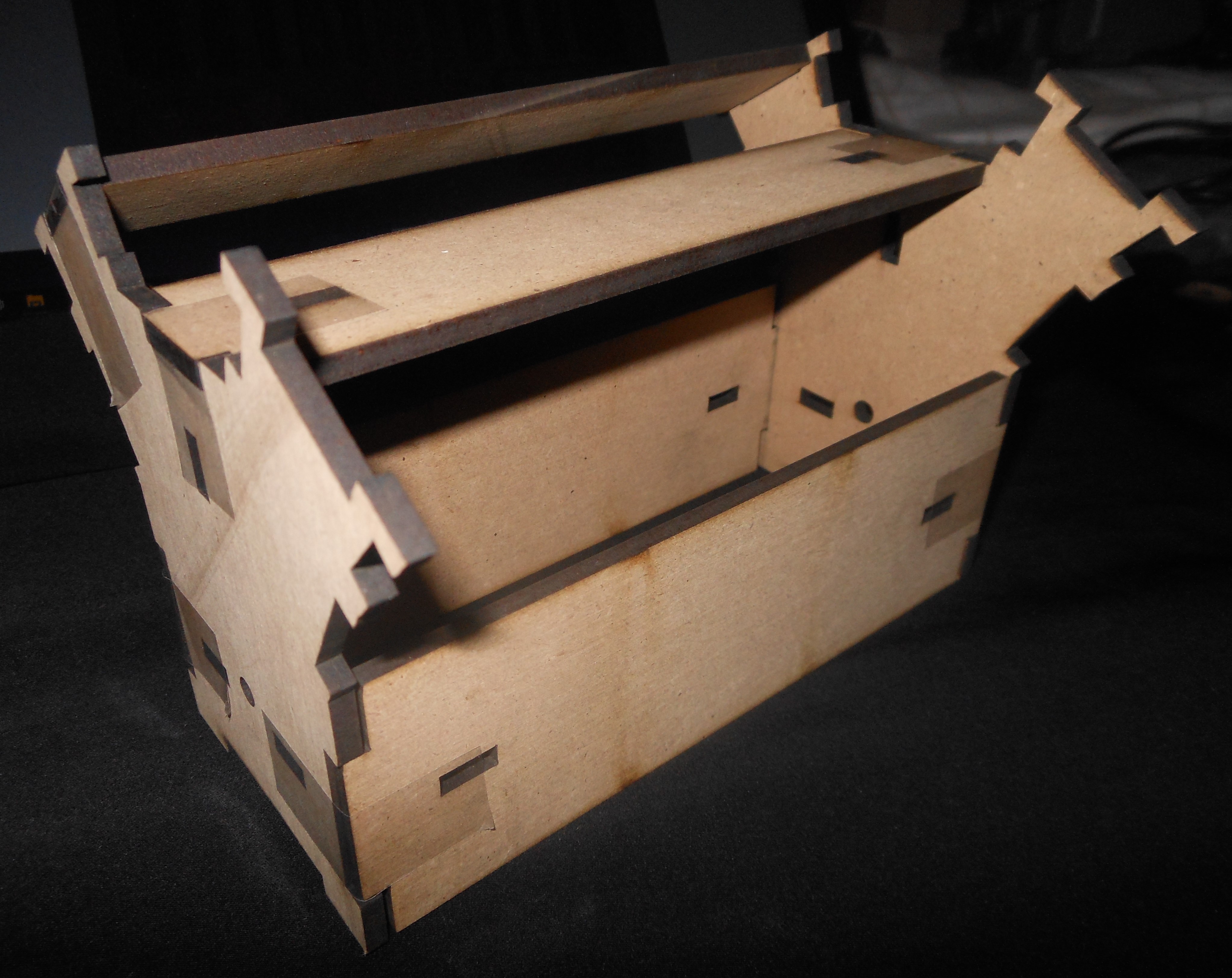

2020 will see the delivery of the new King Tiger and Jagdtiger kits. Based on the P45, I made the P30. In this build of the new engine, I will try to be more complete in the instructions, also making use of the photos of other modelers, who have assembled the P45, to which I would like to thank you in advance. I use the translator, so if something is unclear, please ask. As I have always said, assembly is not difficult, you just need a little patience. I started the assembly today, so it won't be fast.

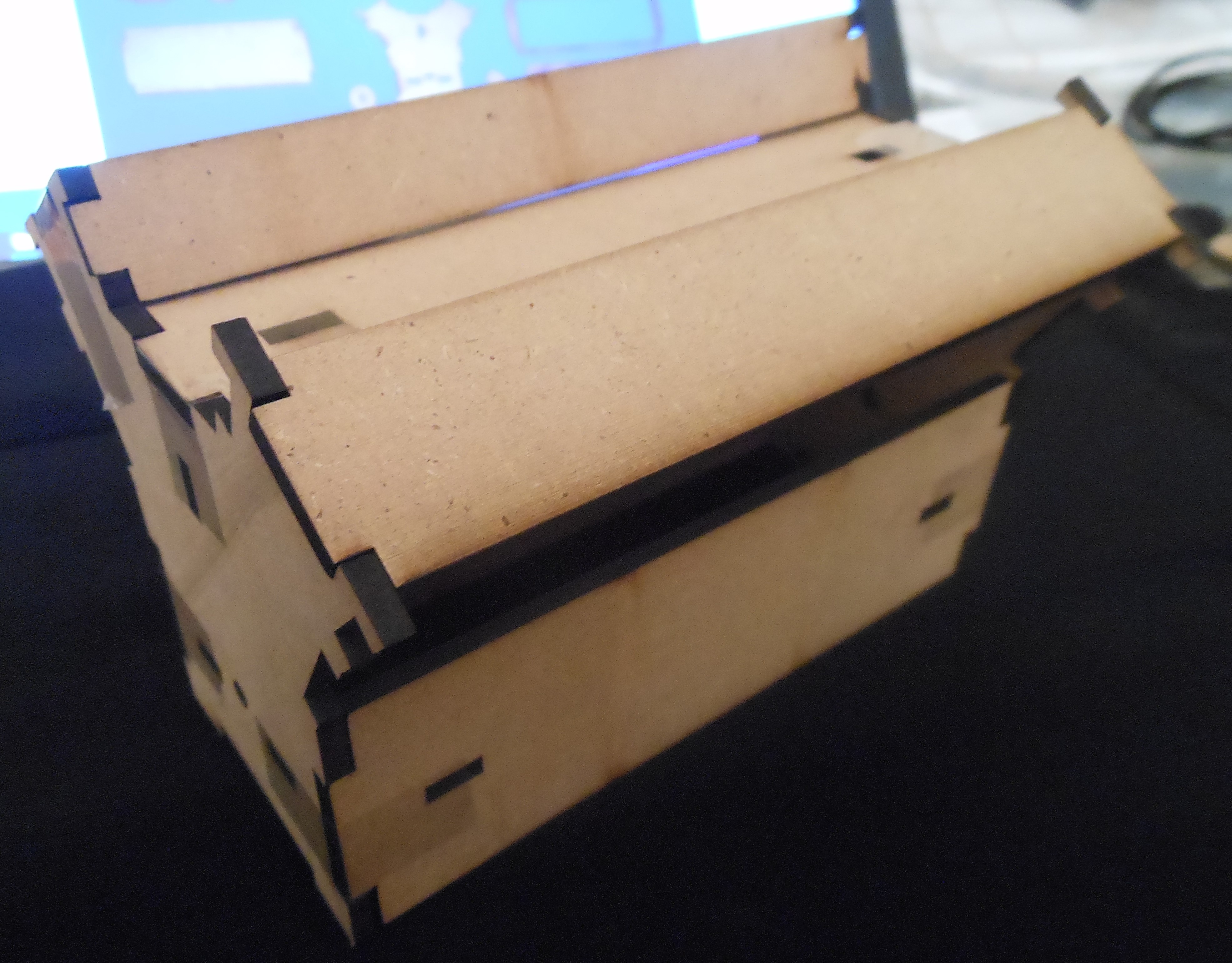

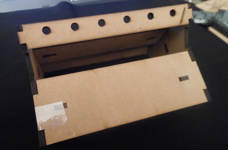

The first thing to do is to mount the MDF skeleton. I use the vinyl glue that I also apply internally as if it were color. This is important to have a solid foundation on which to build the engine.

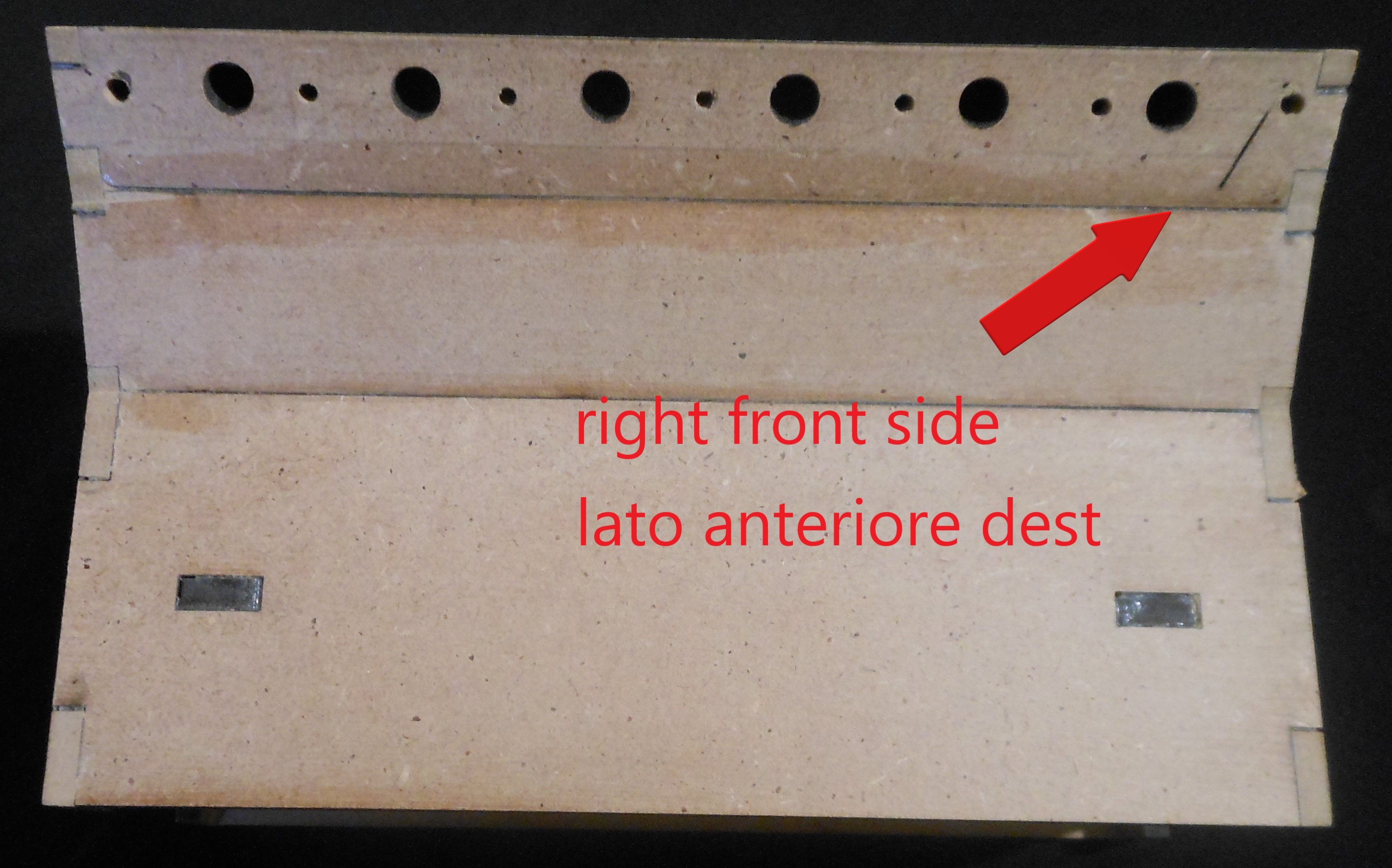

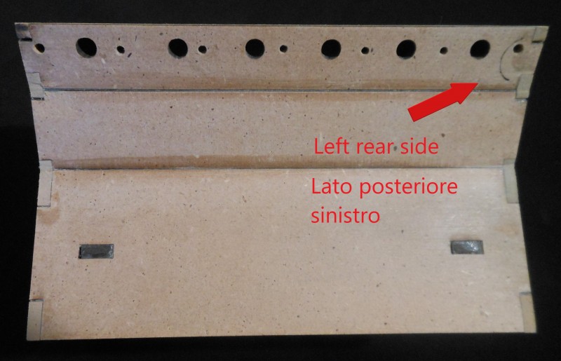

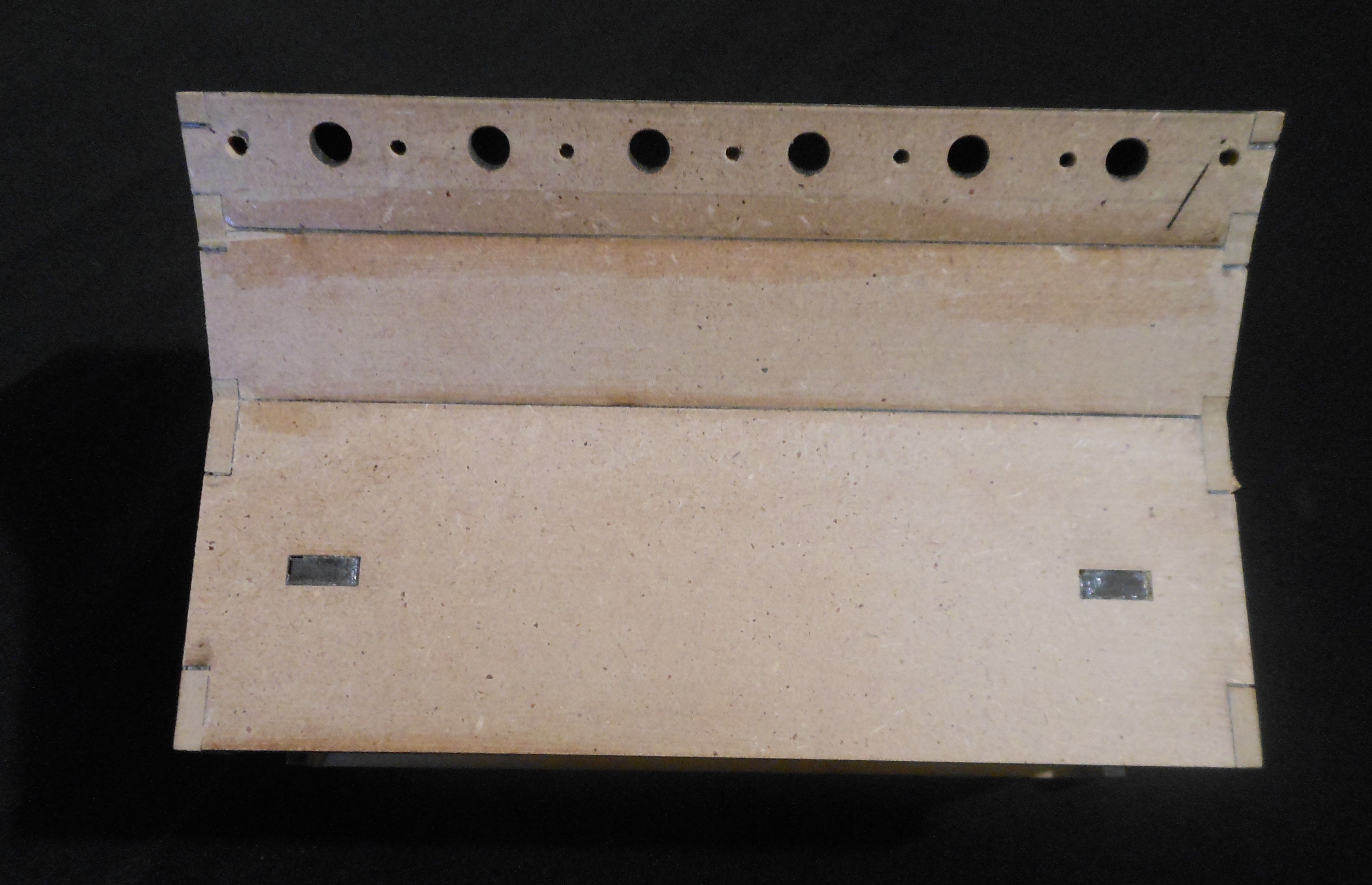

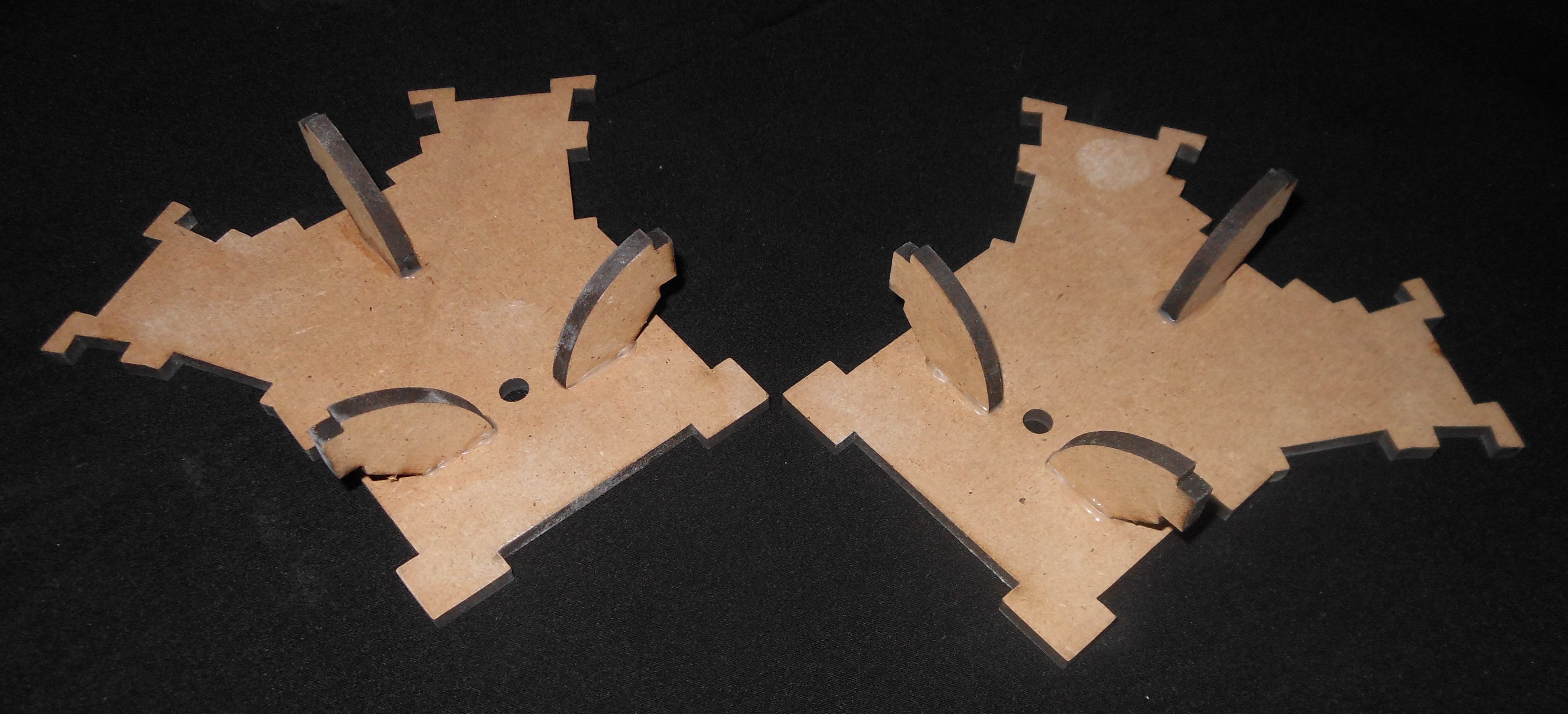

The engine skeleton has a symmetrical geometry, the right side and the left side must be identified.
Very simple, you can see it from the photos.

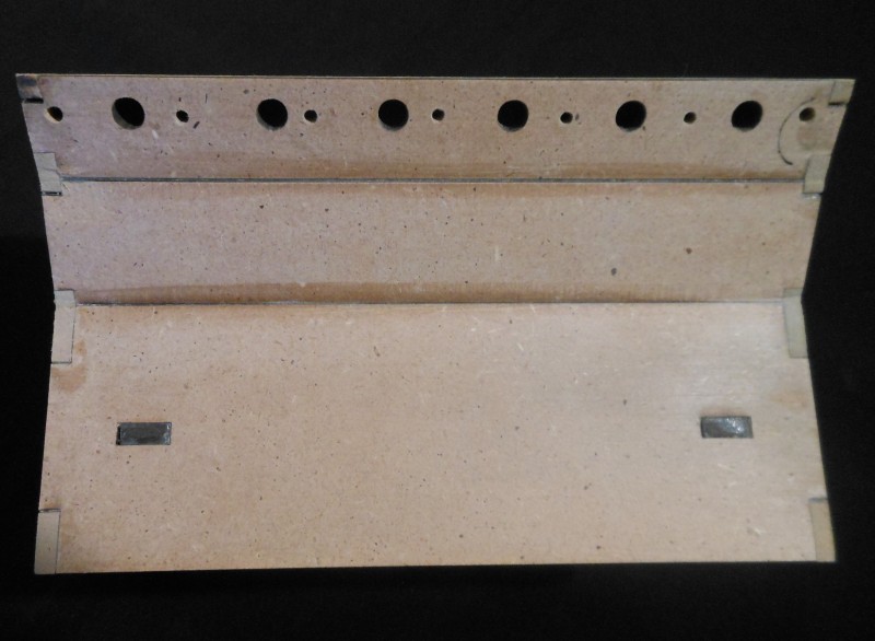

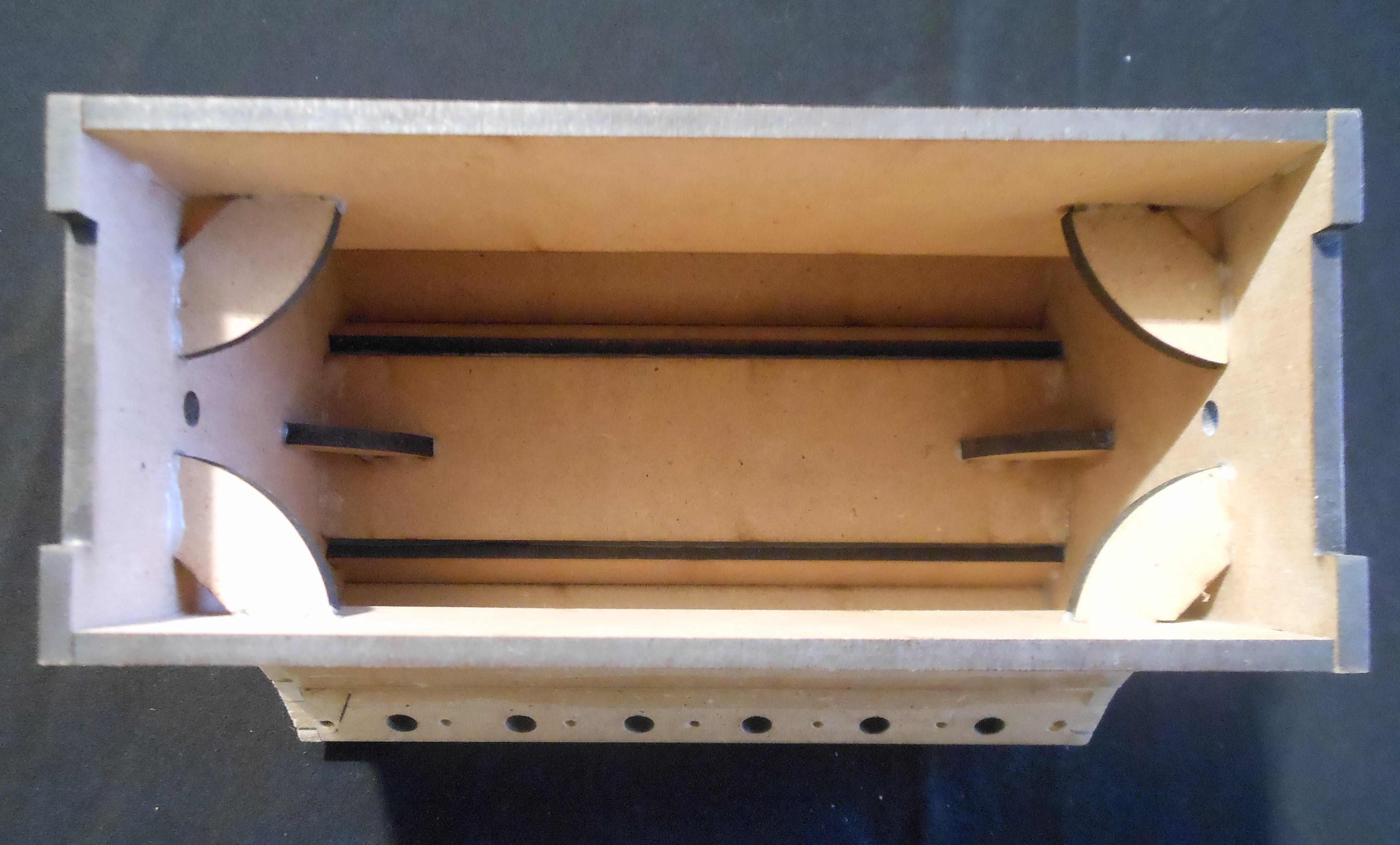

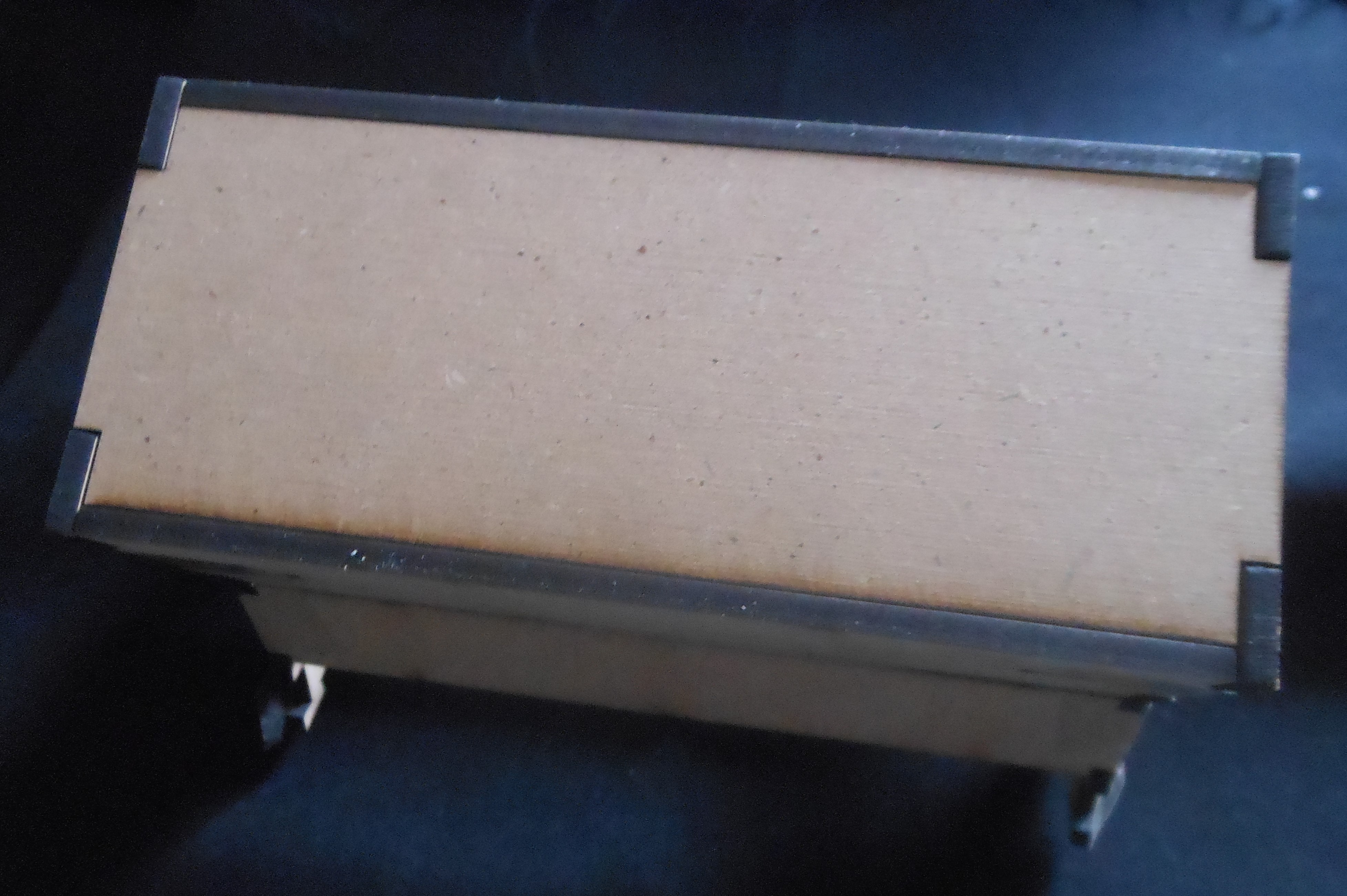

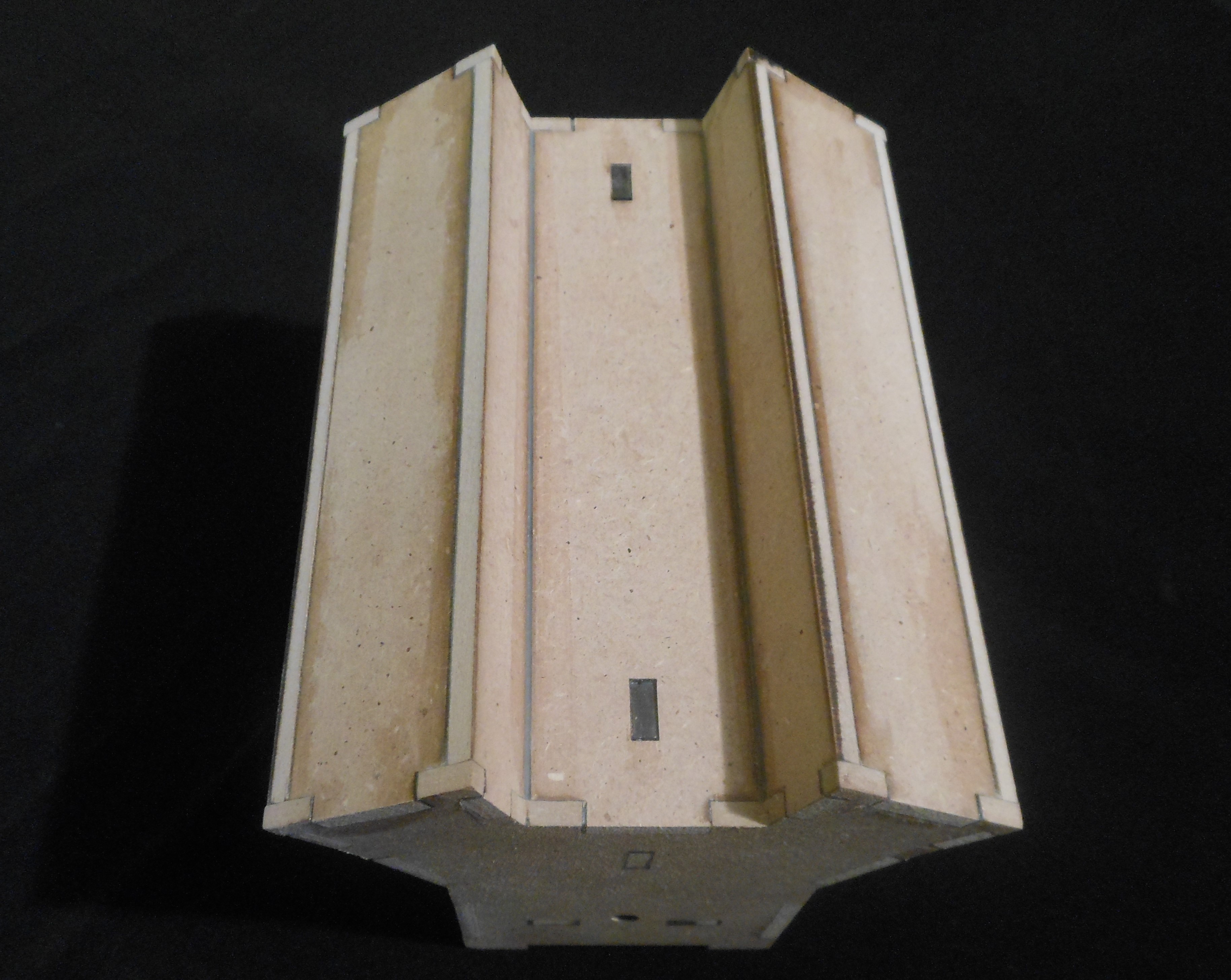

There is the possibility to close the lower part of the engine, I suggest not to do it, but if you want to close, only after completing the assembly.

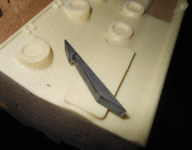

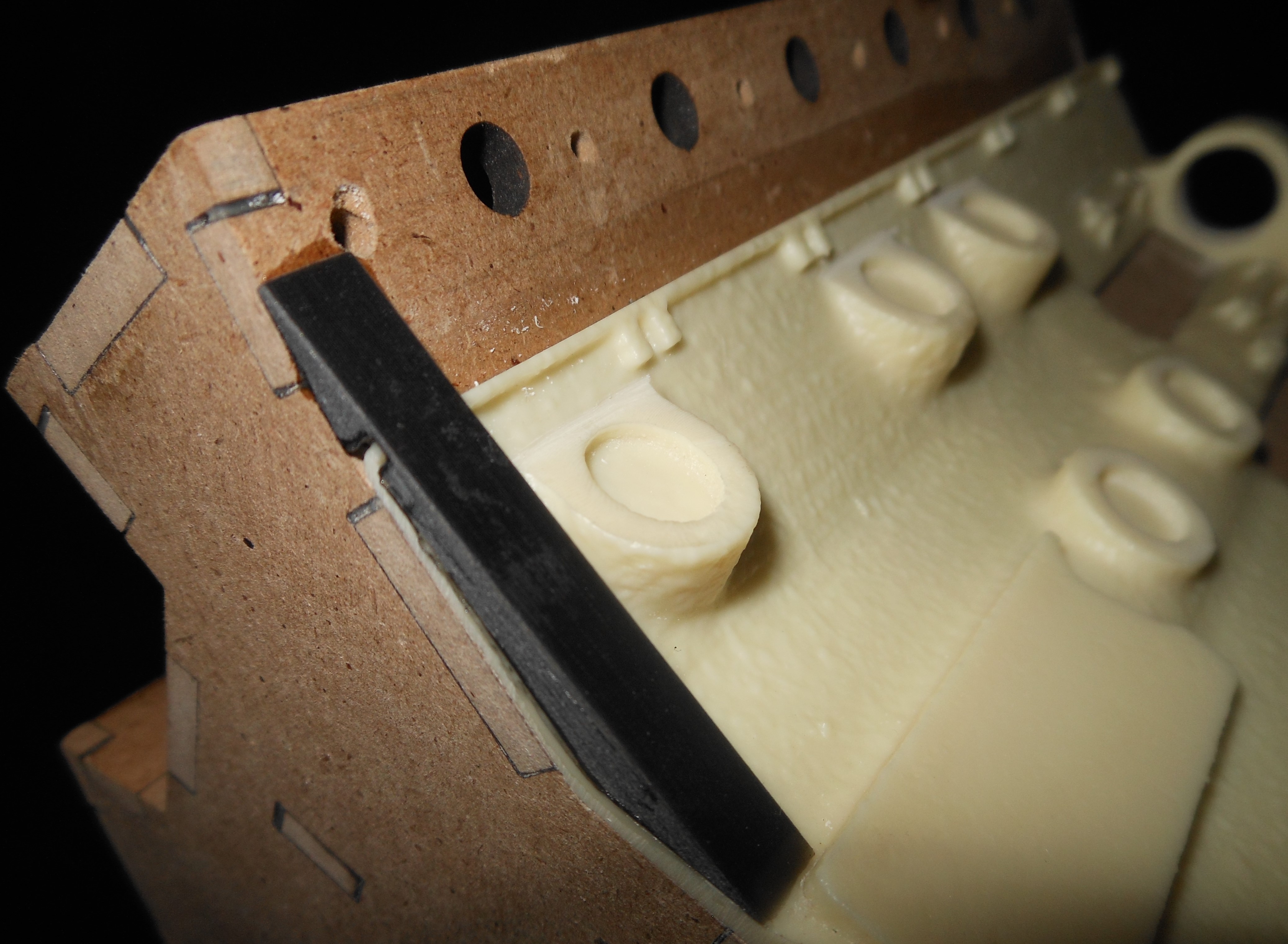

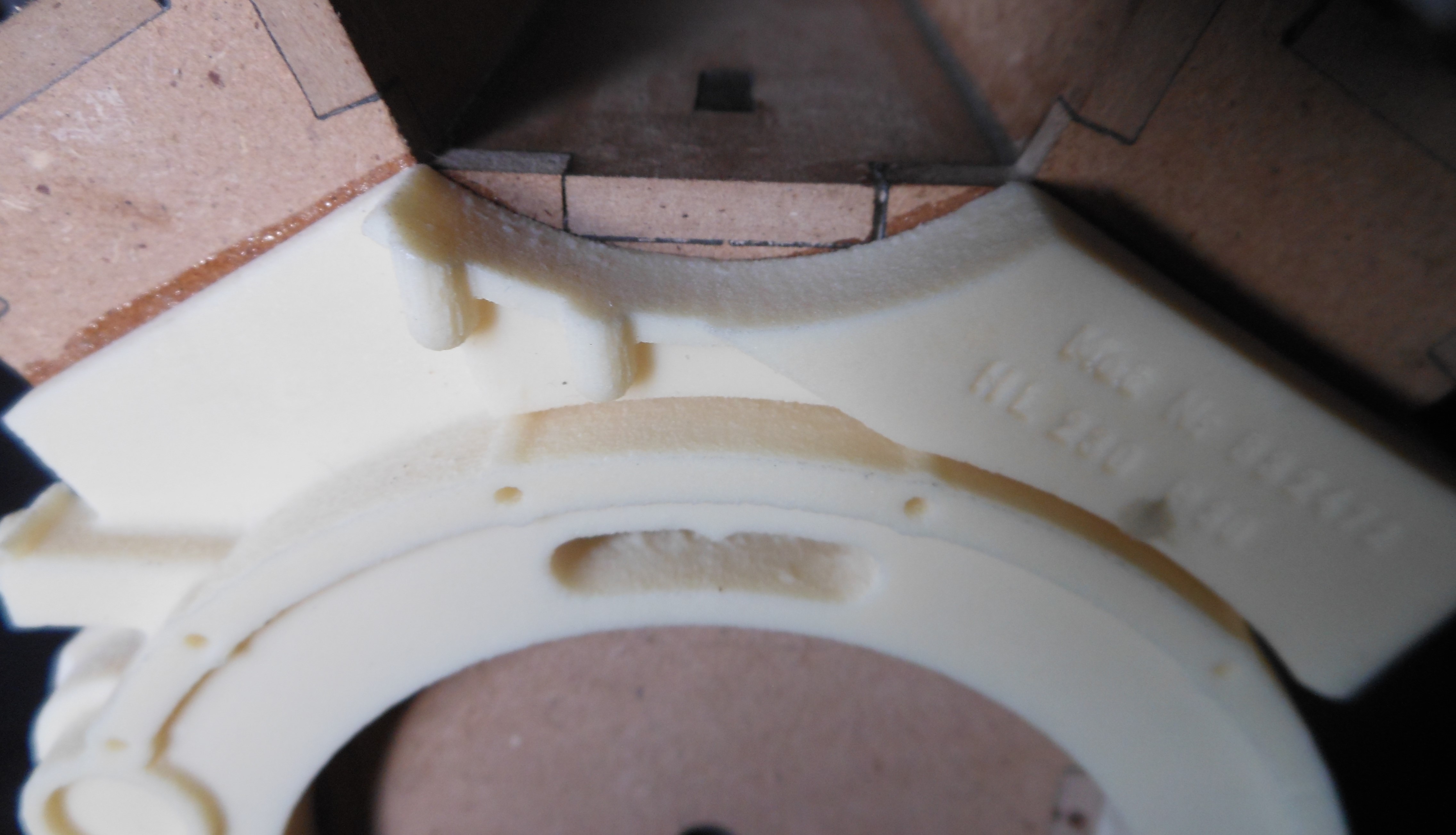

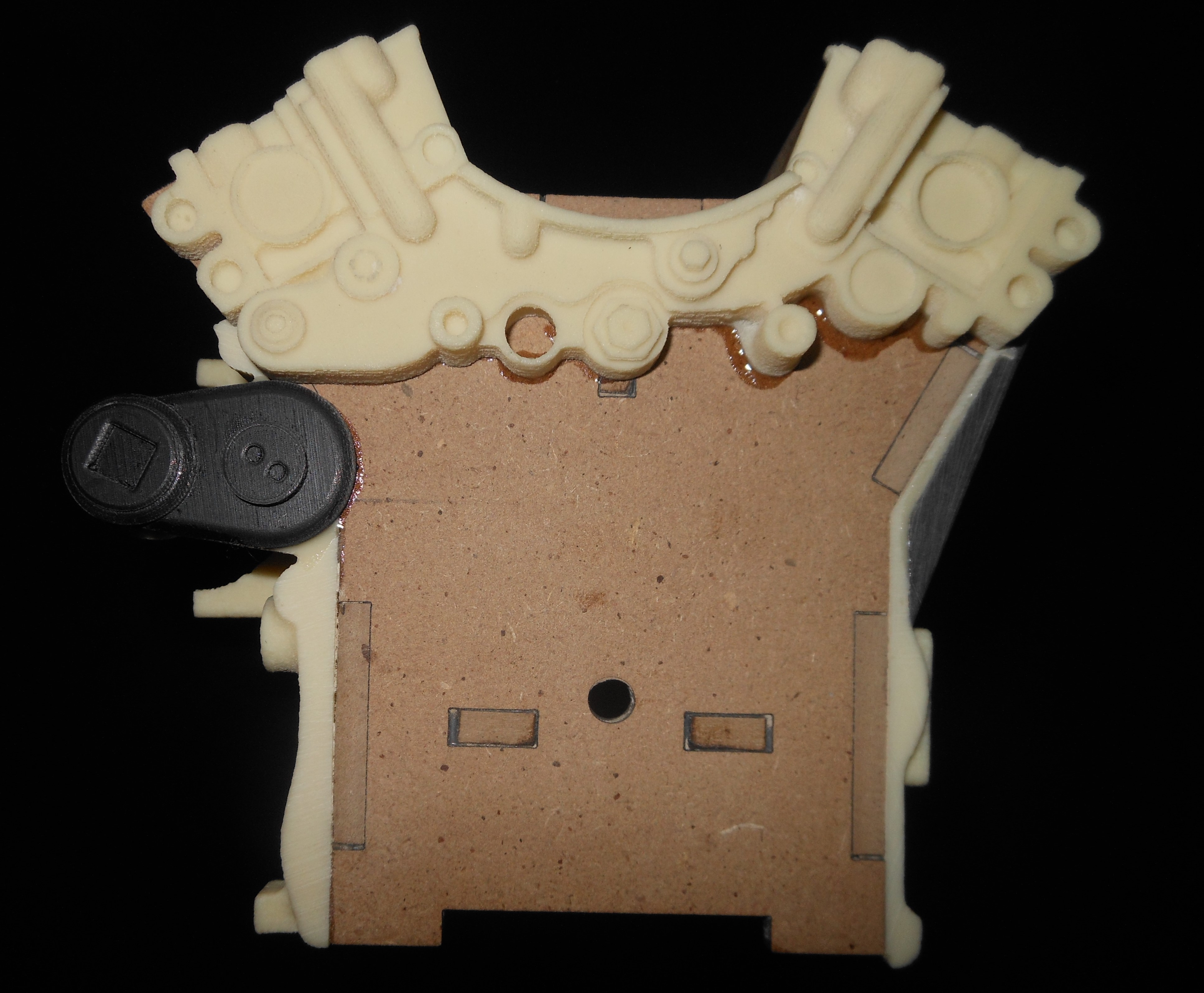

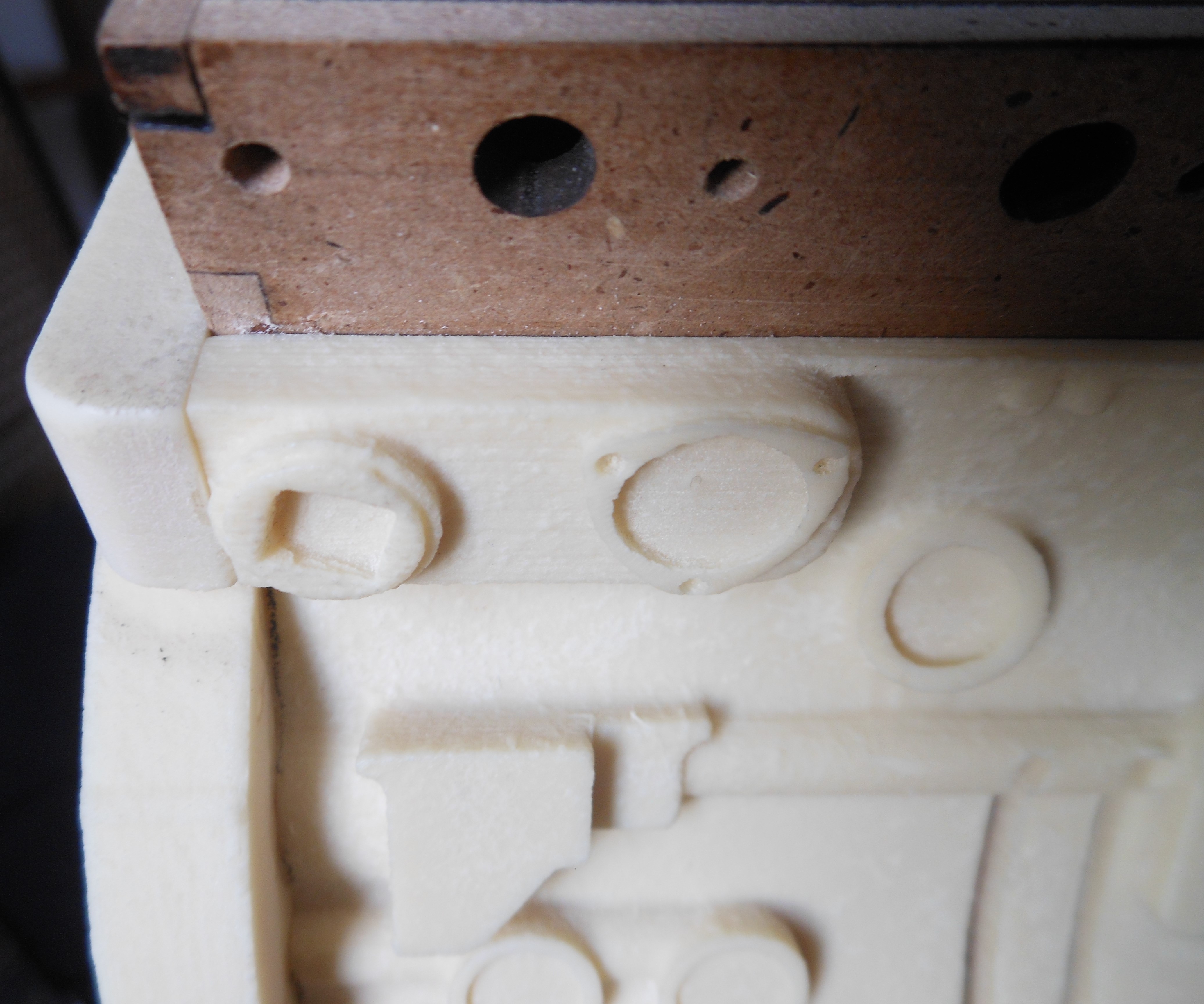

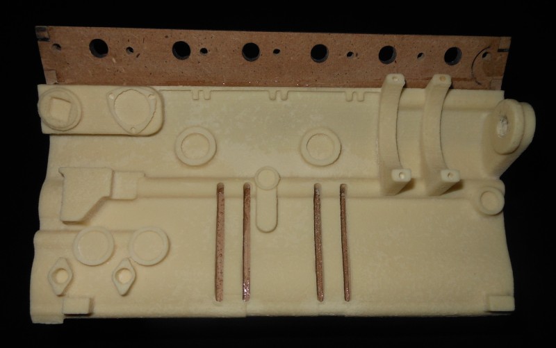

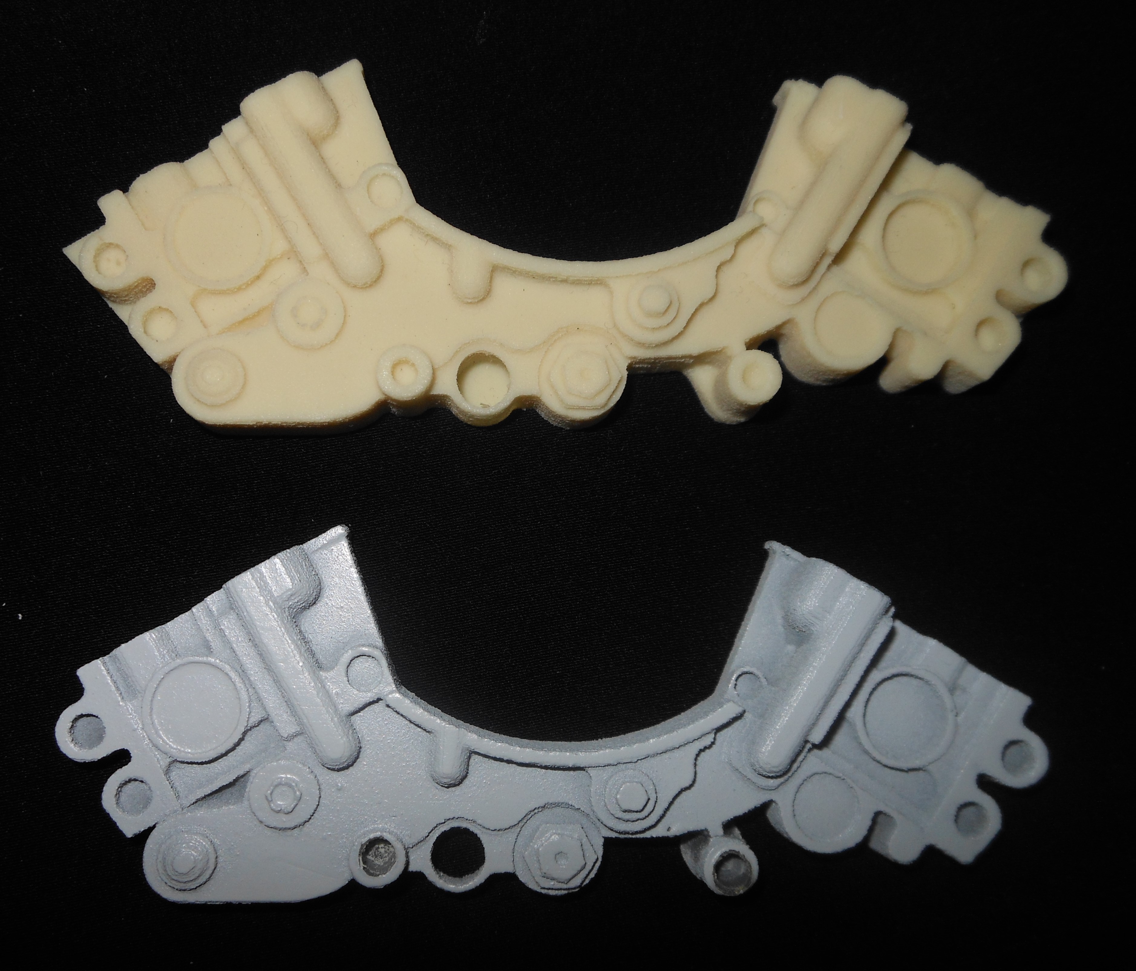

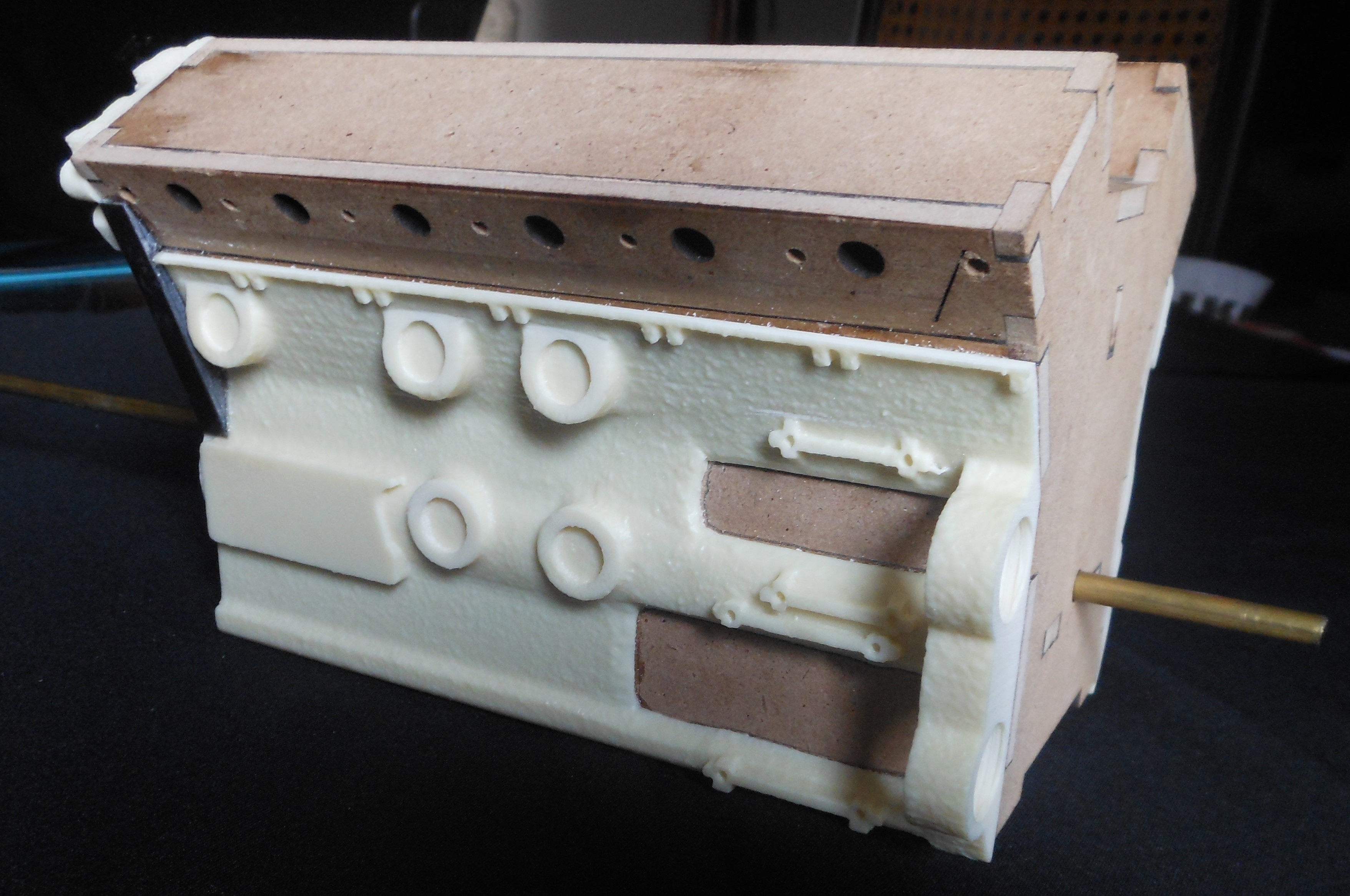

Now, after checking that the glue is dry and that everything is aligned and solid, we can start the actual assembly.
I use epoxy glue, because it gives me time to reposition the pieces in case of errors. However, I highly recommend trying 1,10,100 times before gluing, be sure the pieces fit properly. Once glued, it will be impossible to remove the pieces without damaging them.
right side
left side

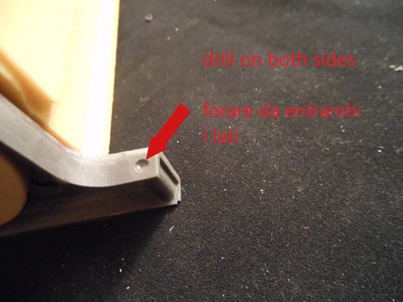

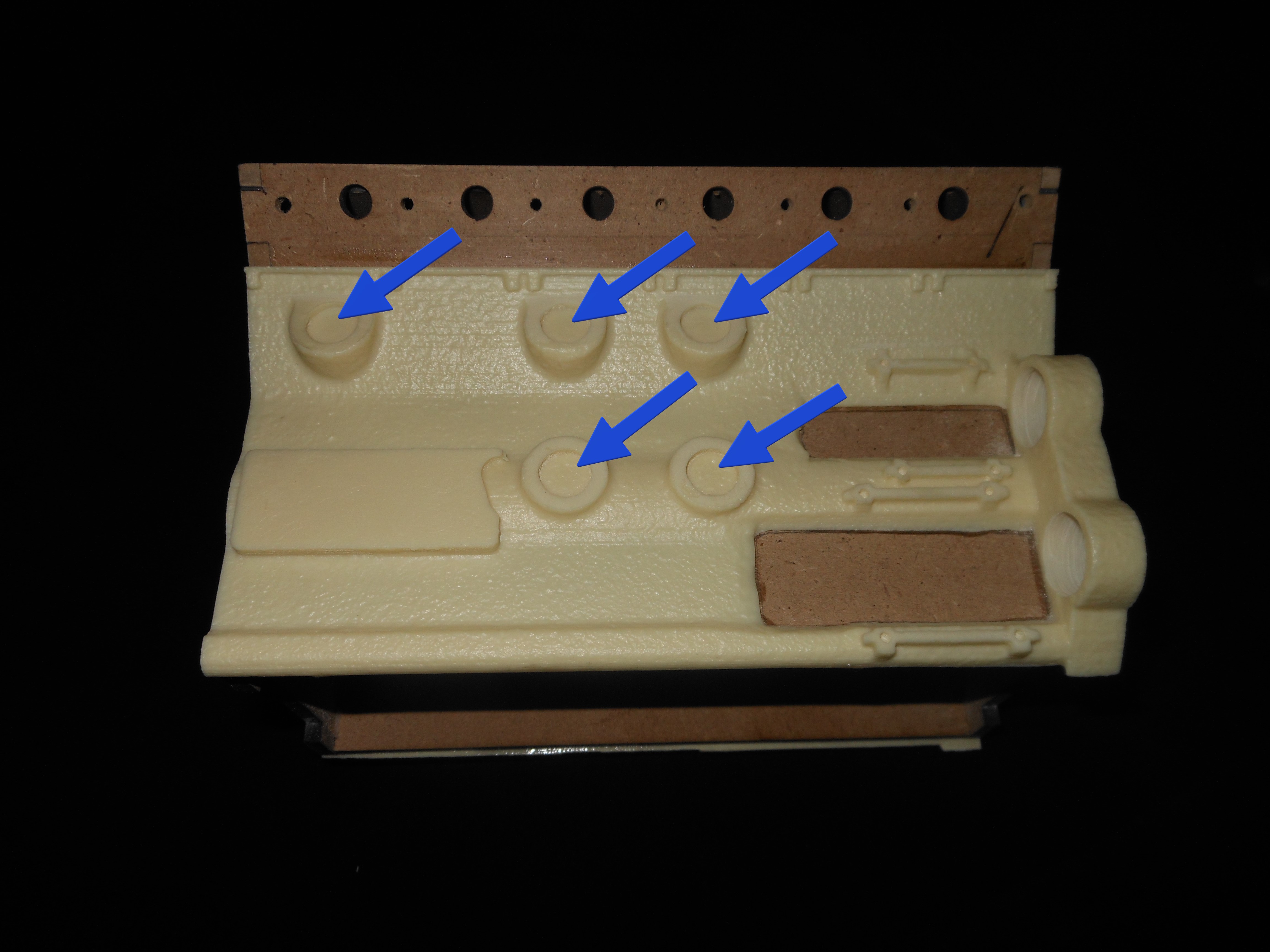

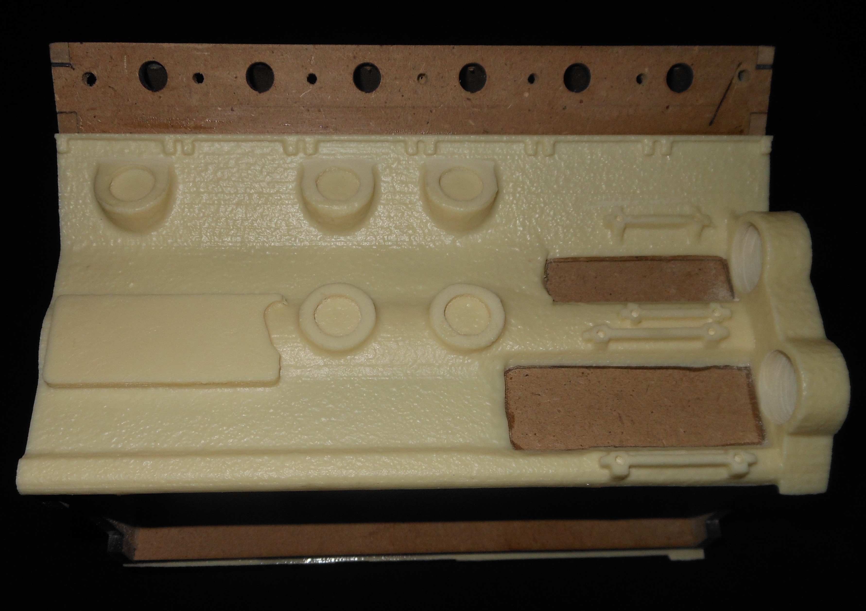

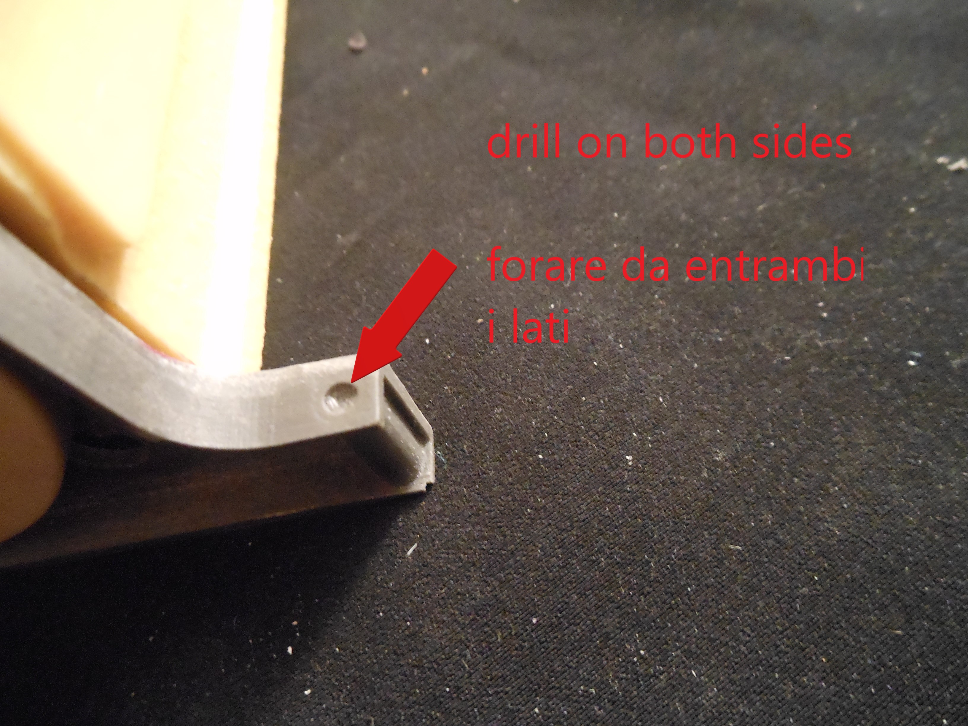

I designed the engine empty to be able to insert something inside. If it is necessary to circulate air, these parts can be drilled on both sides. When it is painted and placed the holes will not be noticed.
puncture only the internal part

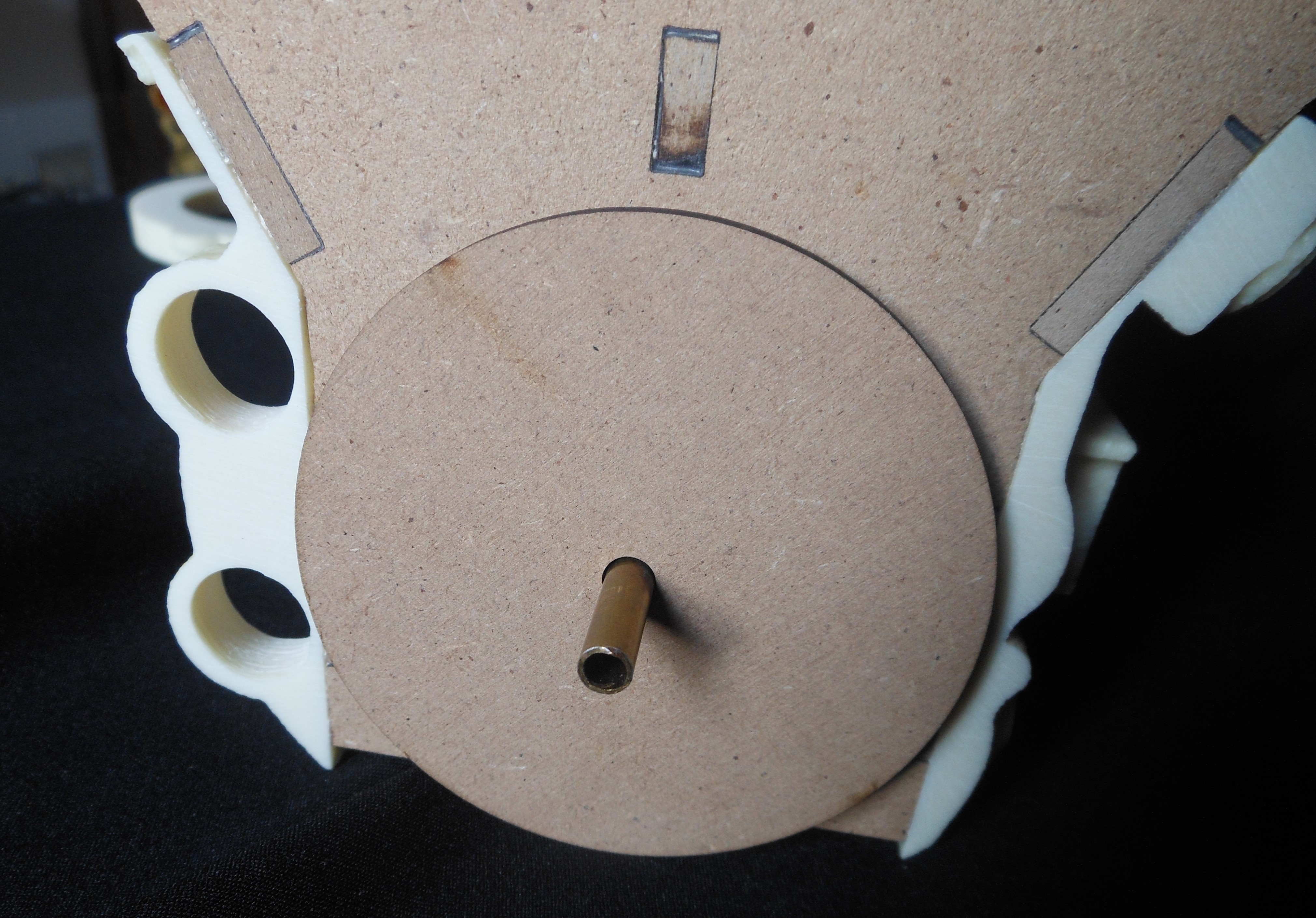

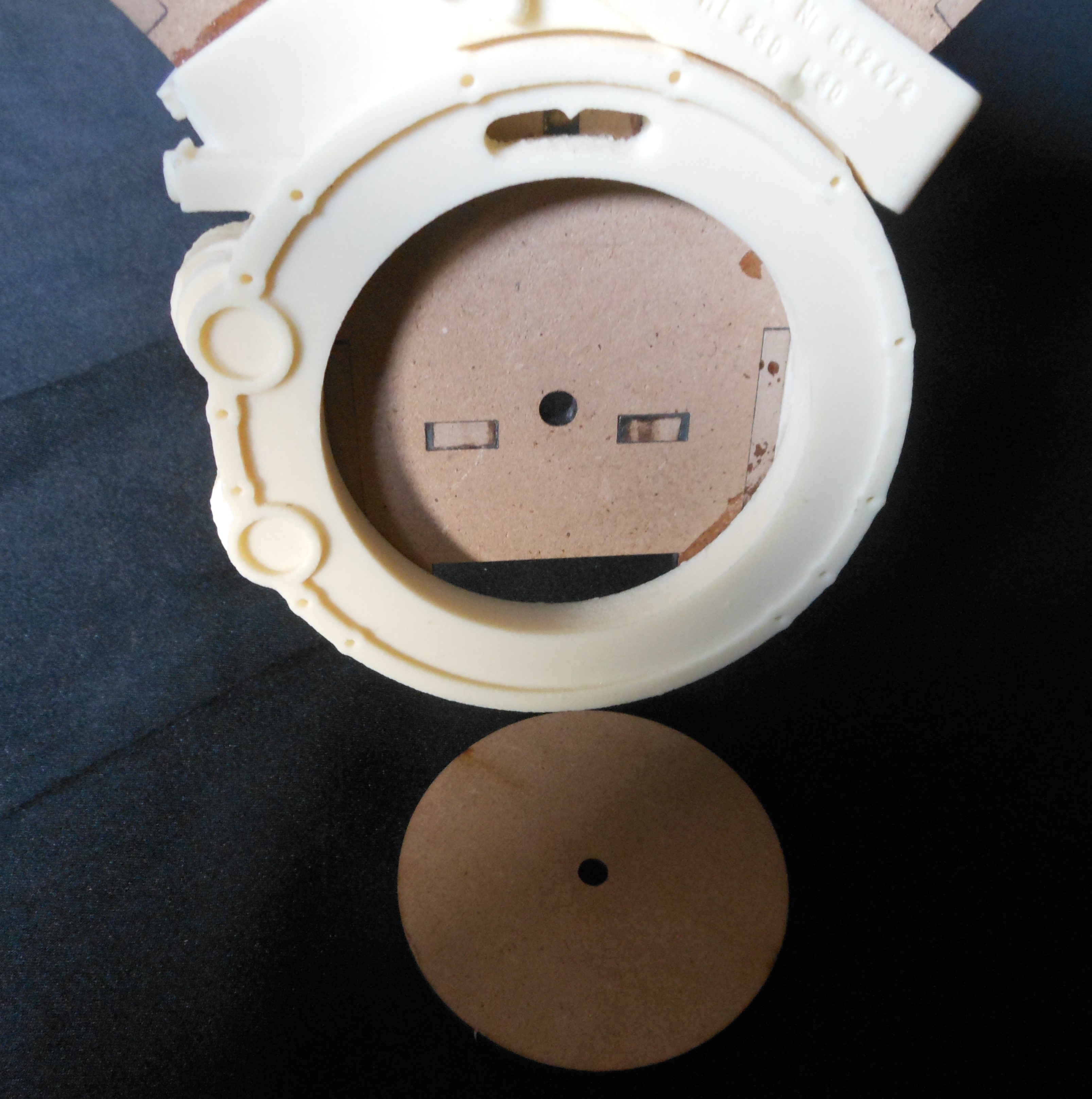

Post by Ivano Costantini » Mon Jan 06, 2020 6:24 pm

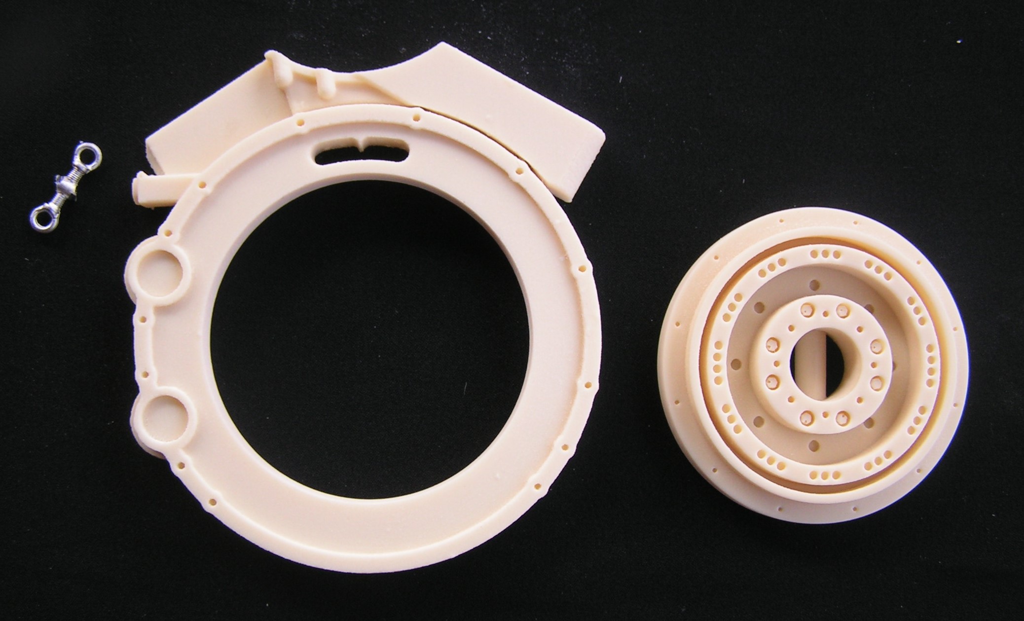

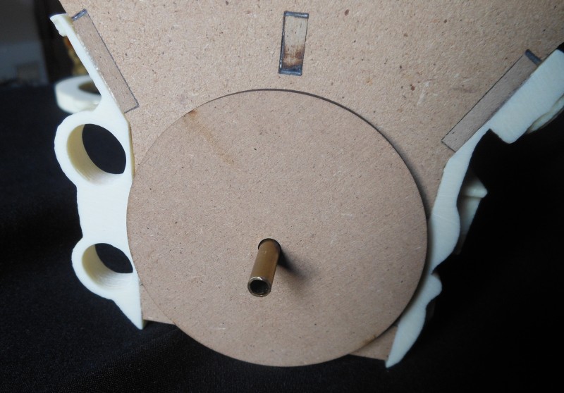

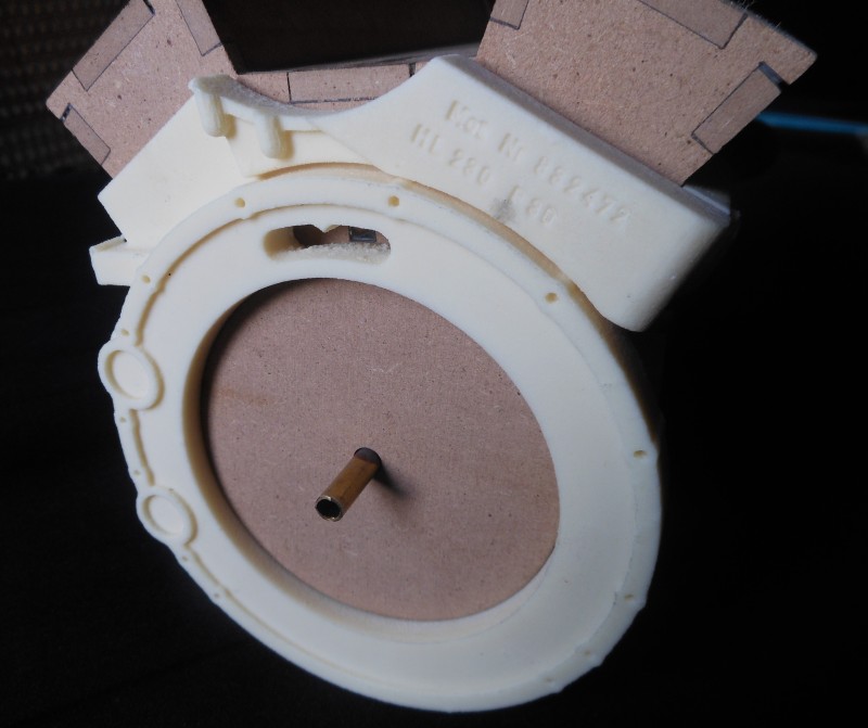

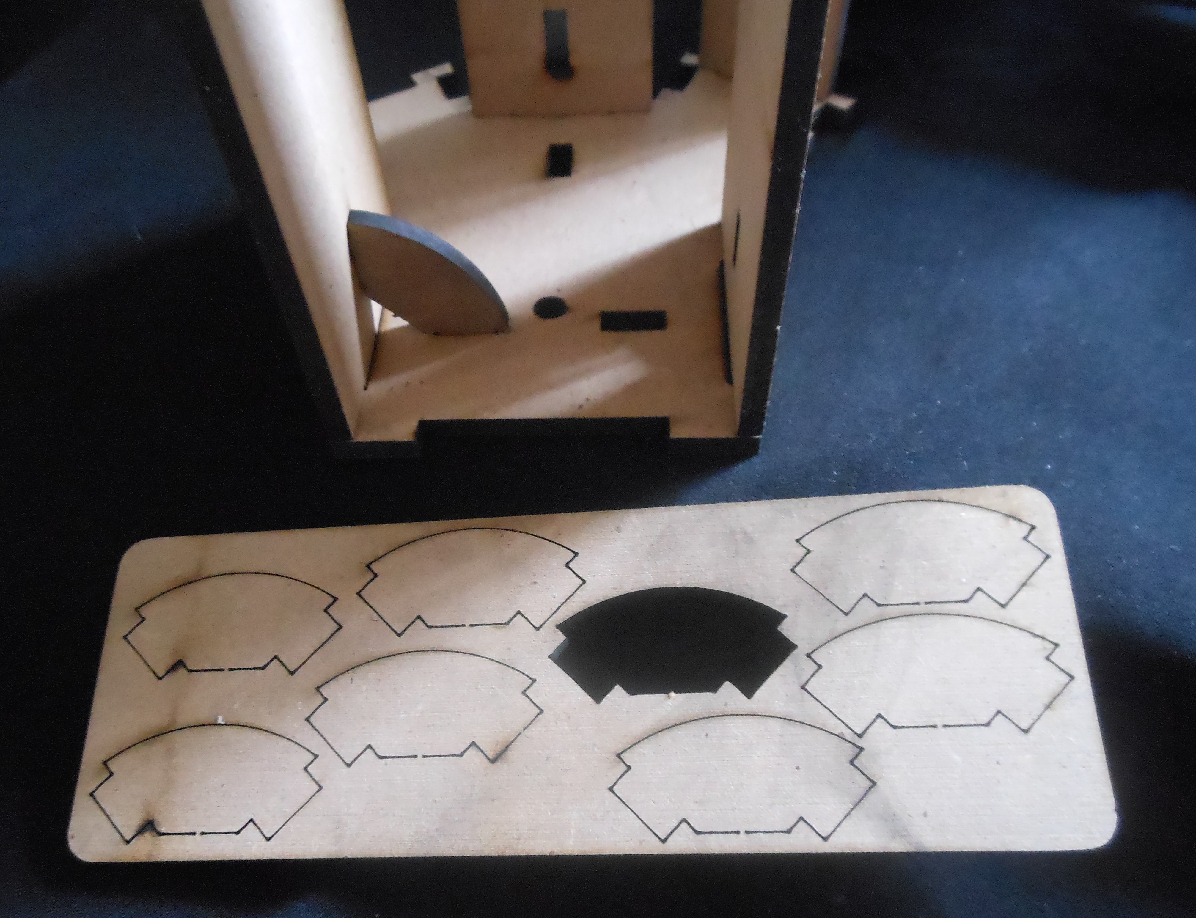

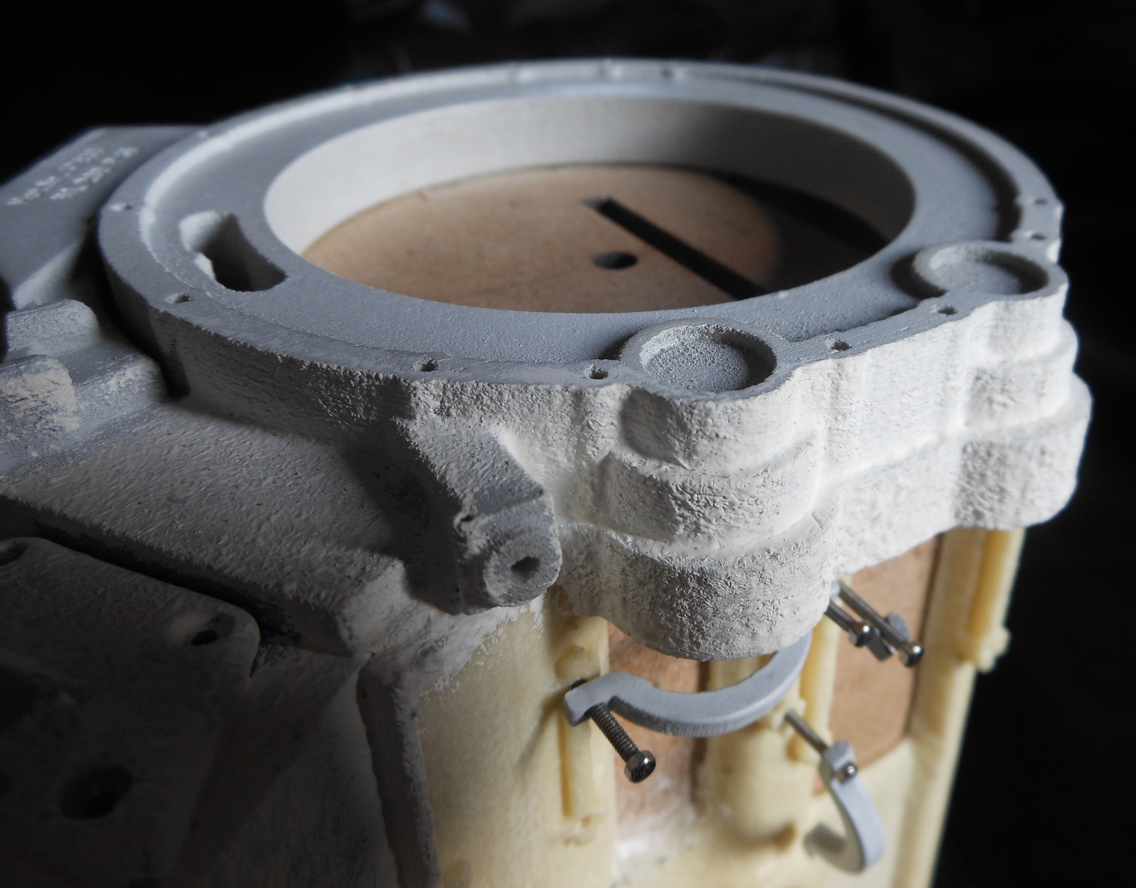

For the front and rear sides, the two MDF discs can be used for centering. However always check, remember that it is a handmade product and it is not always accurate to the thousandth, there is the thickness of the glue that can influence it, so it may be necessary to position it a little off-center (3 - 4/10)
Do not paste the disc
Ivano Costantini
Posts: 322
Been Liked: 283 times
Re: New engine for King Tiger and Jagdtiger

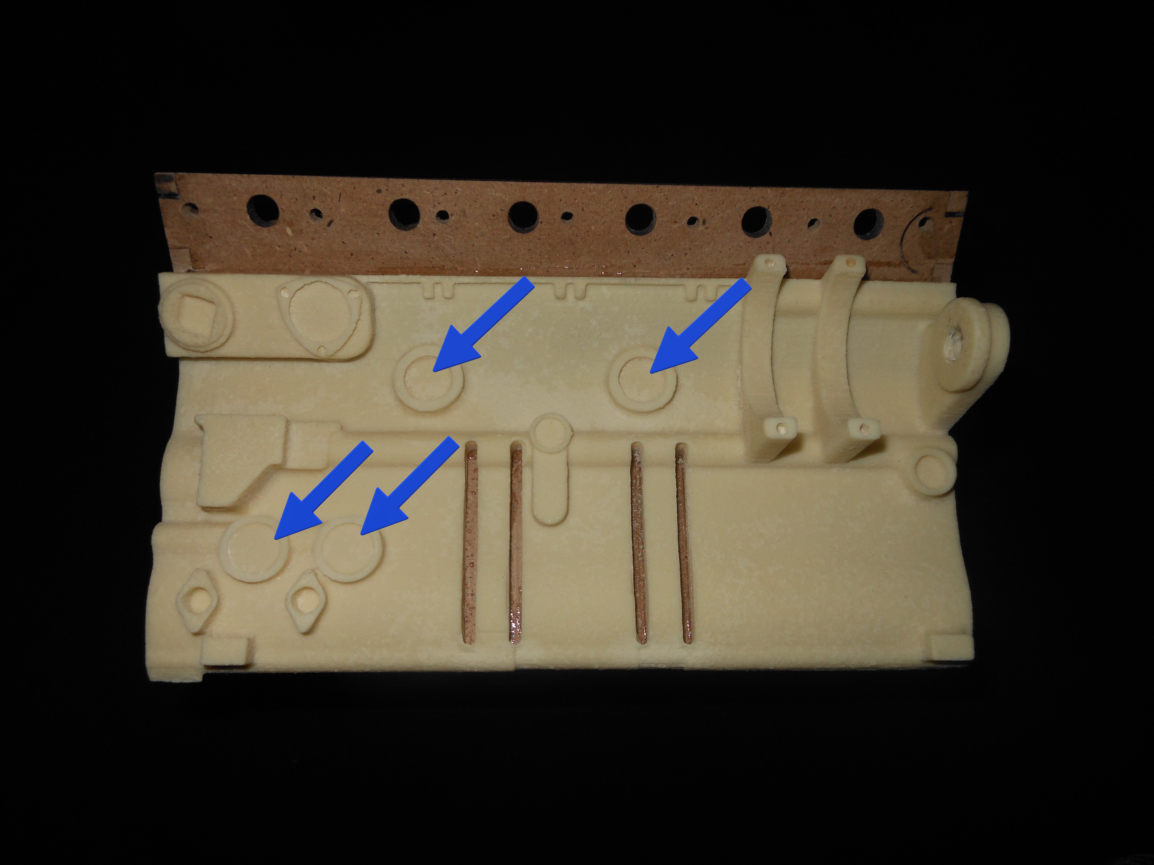

Post by Ivano Costantini » Mon Jan 06, 2020 6:31 pm

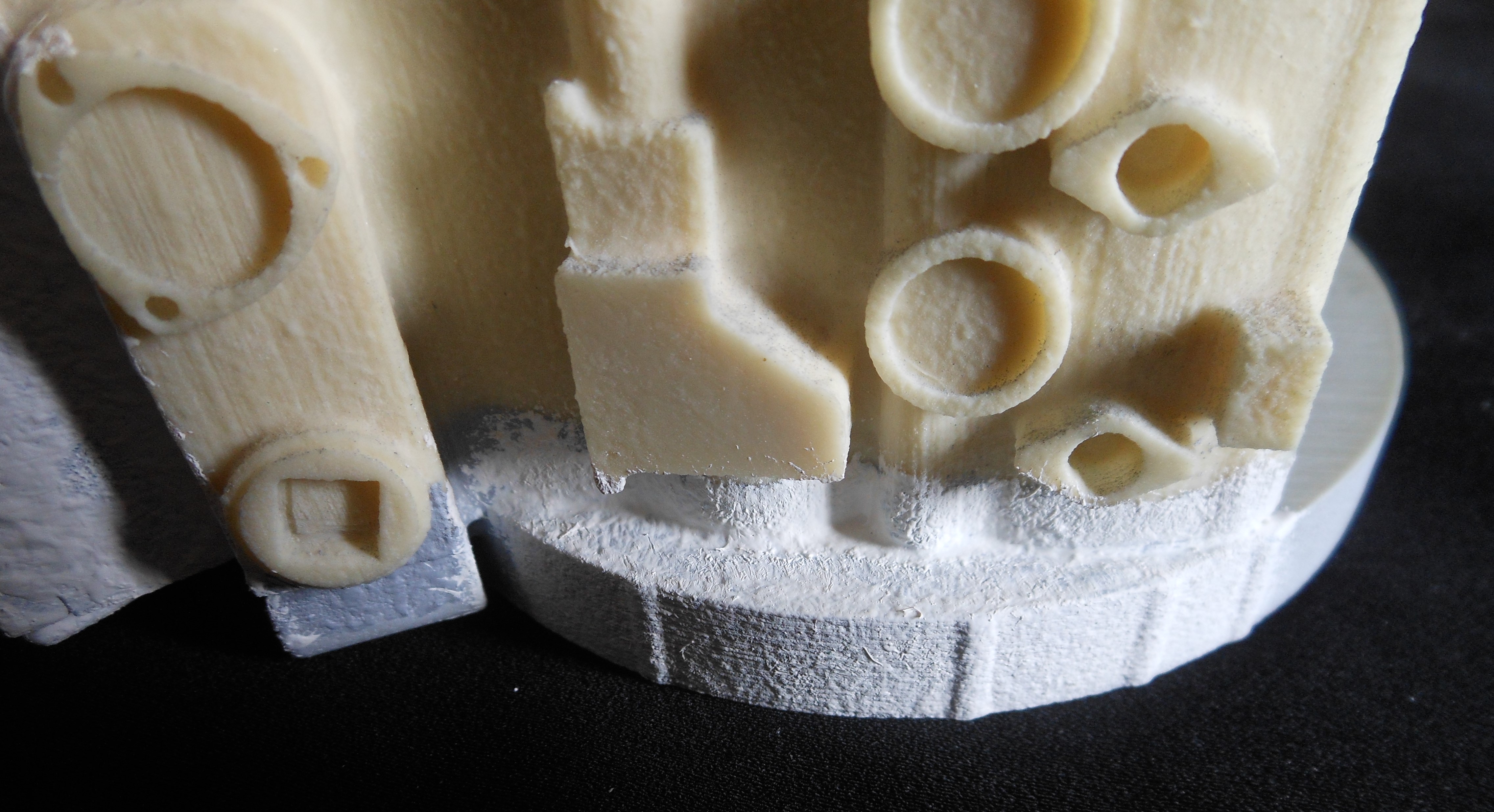

Always check that everything is fine before pasting
If necessary, fill the level differences with sandpaper or a little bit of putty
To hide the joints, and texturing the MDF parts that remain uncovered, I use a product called by us "cementite"

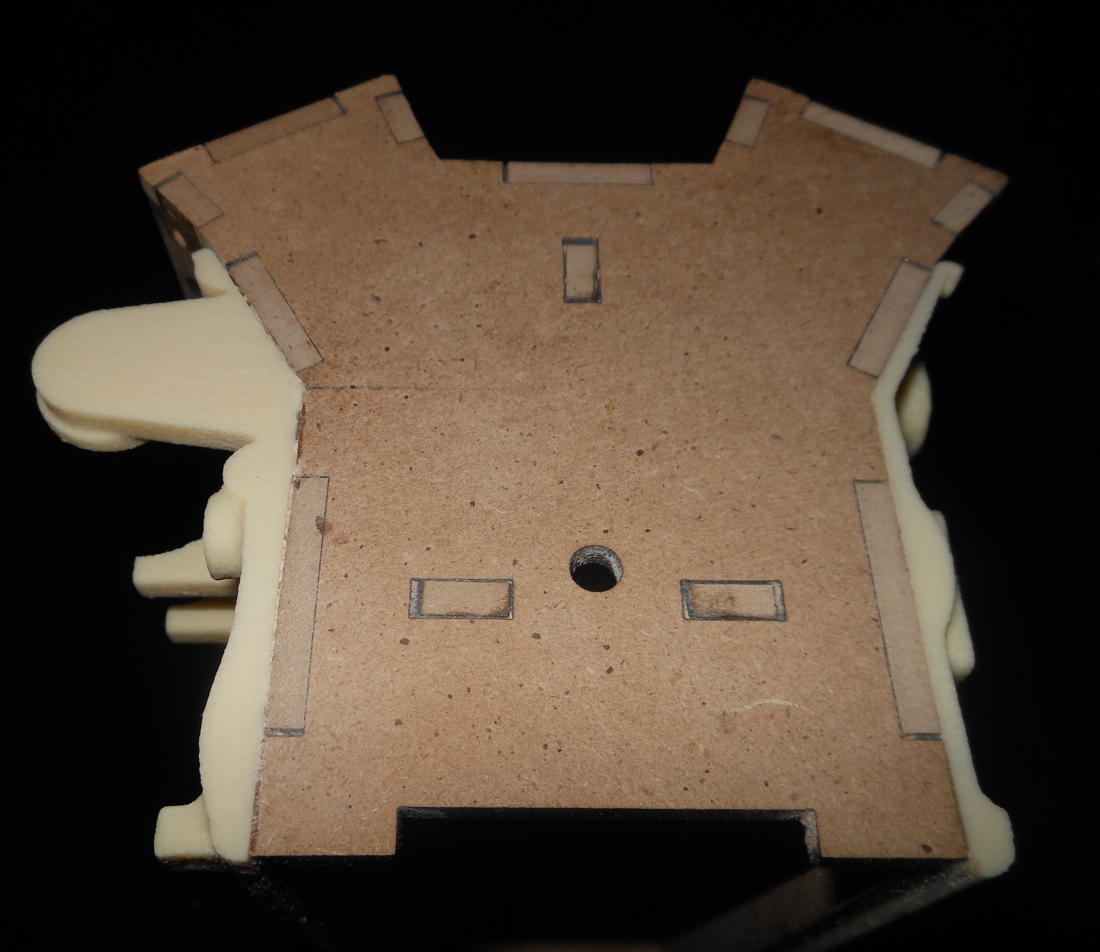

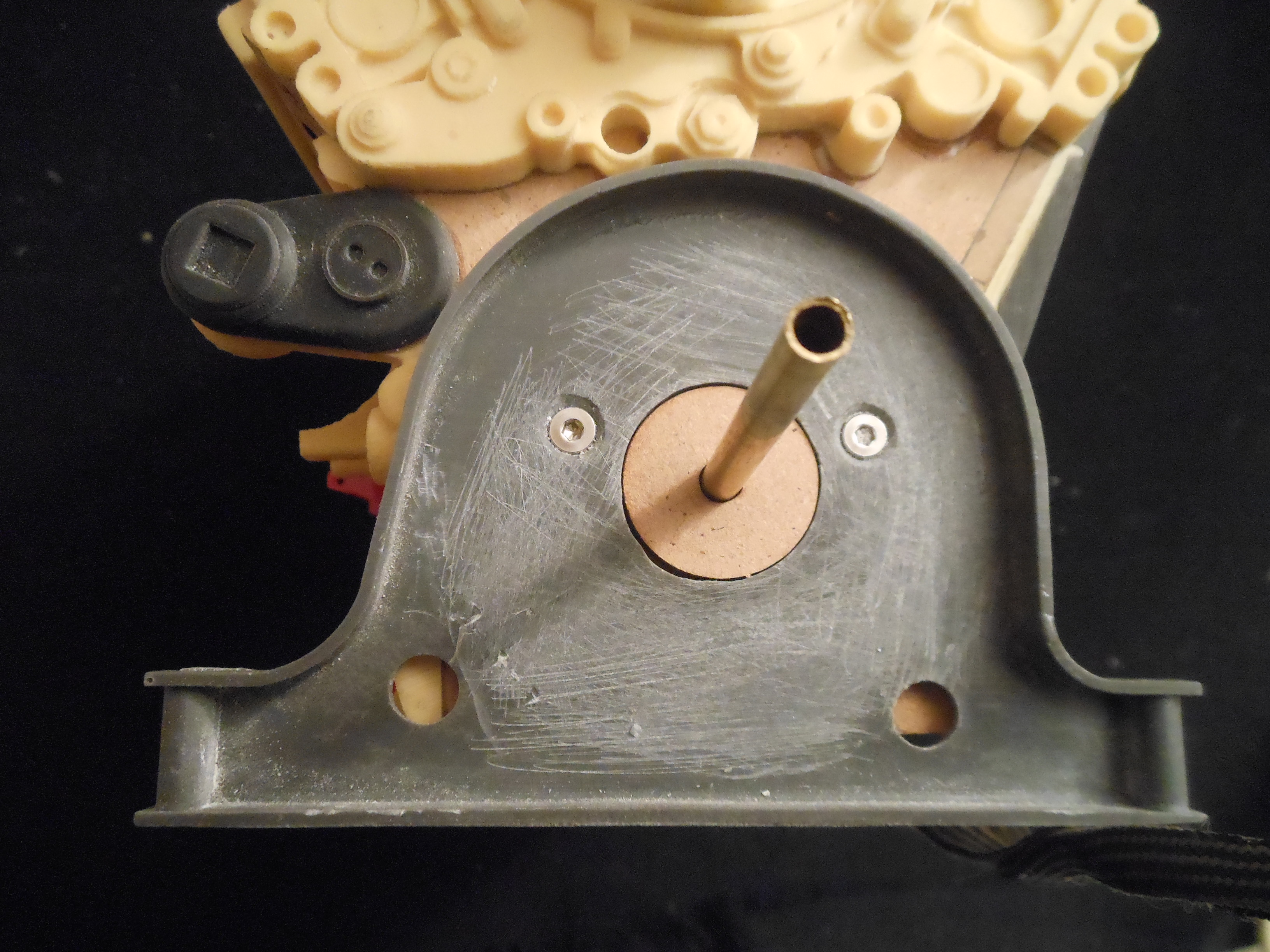

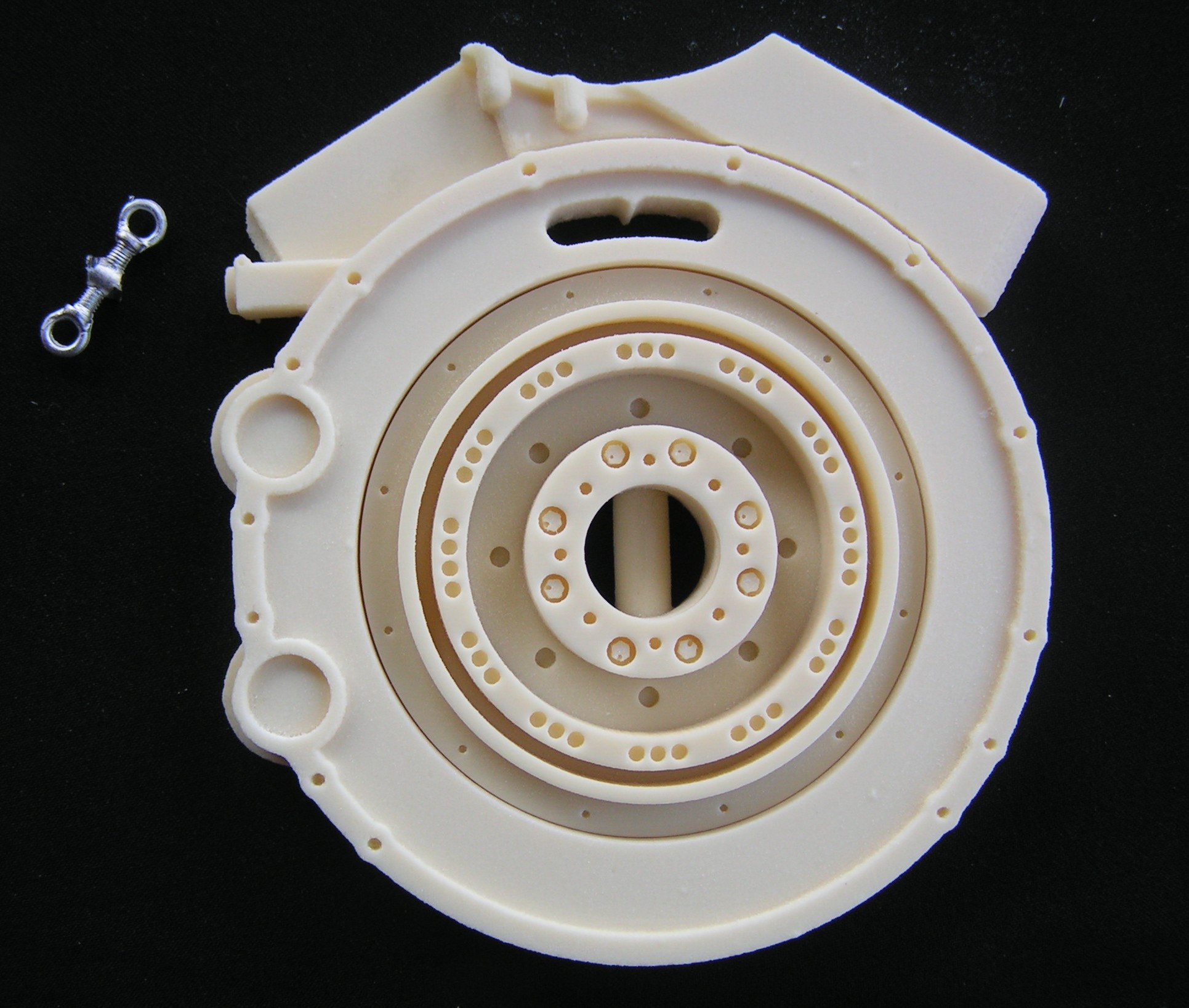

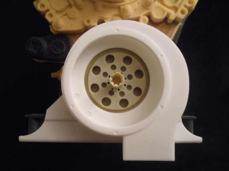

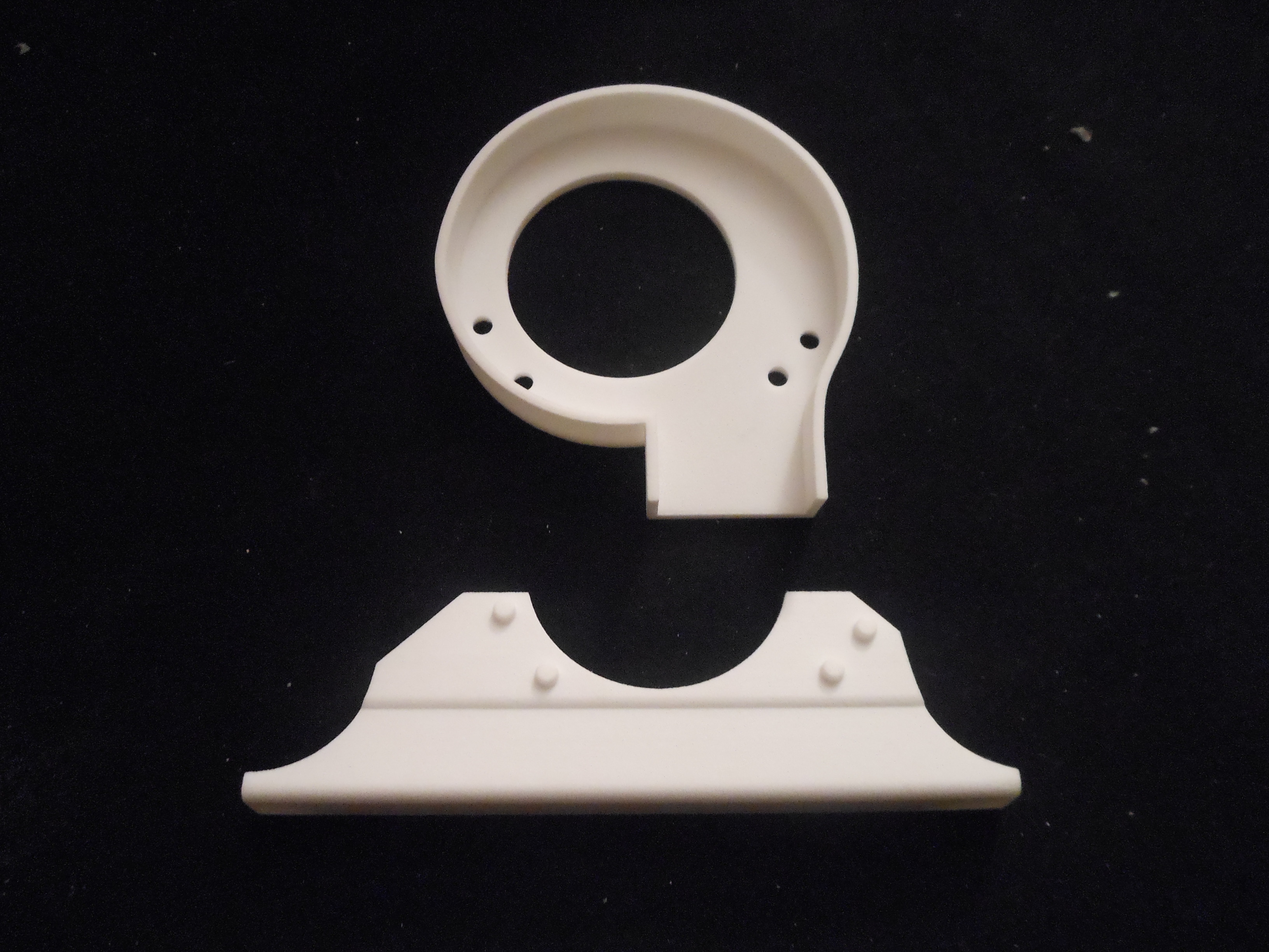

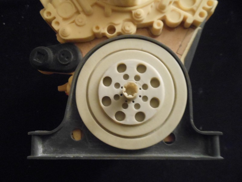

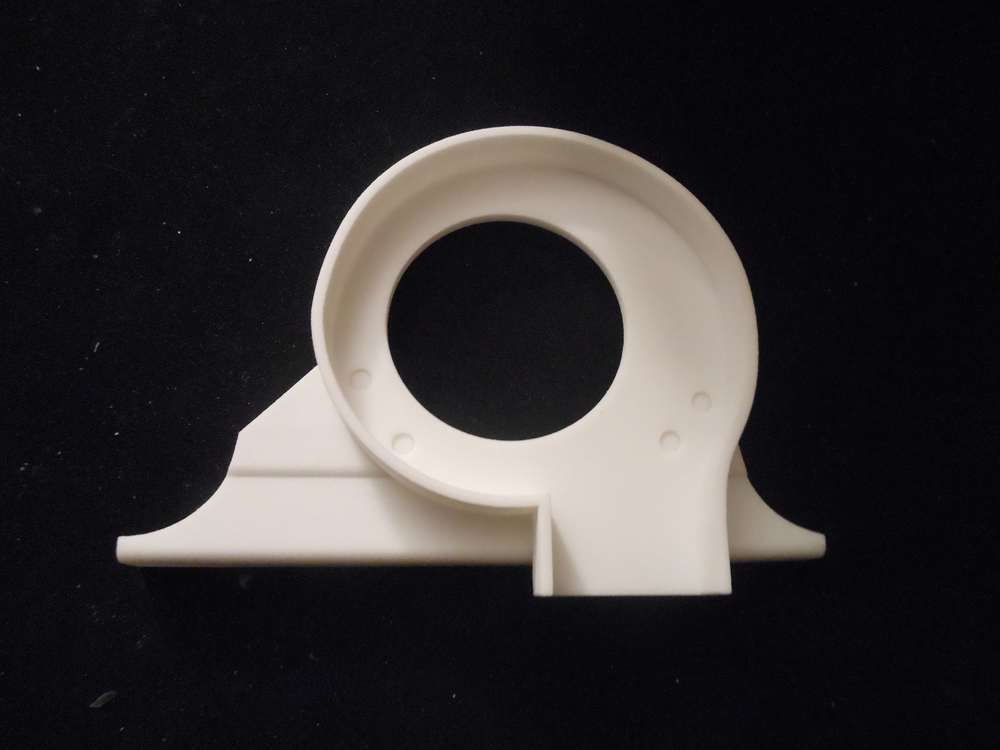

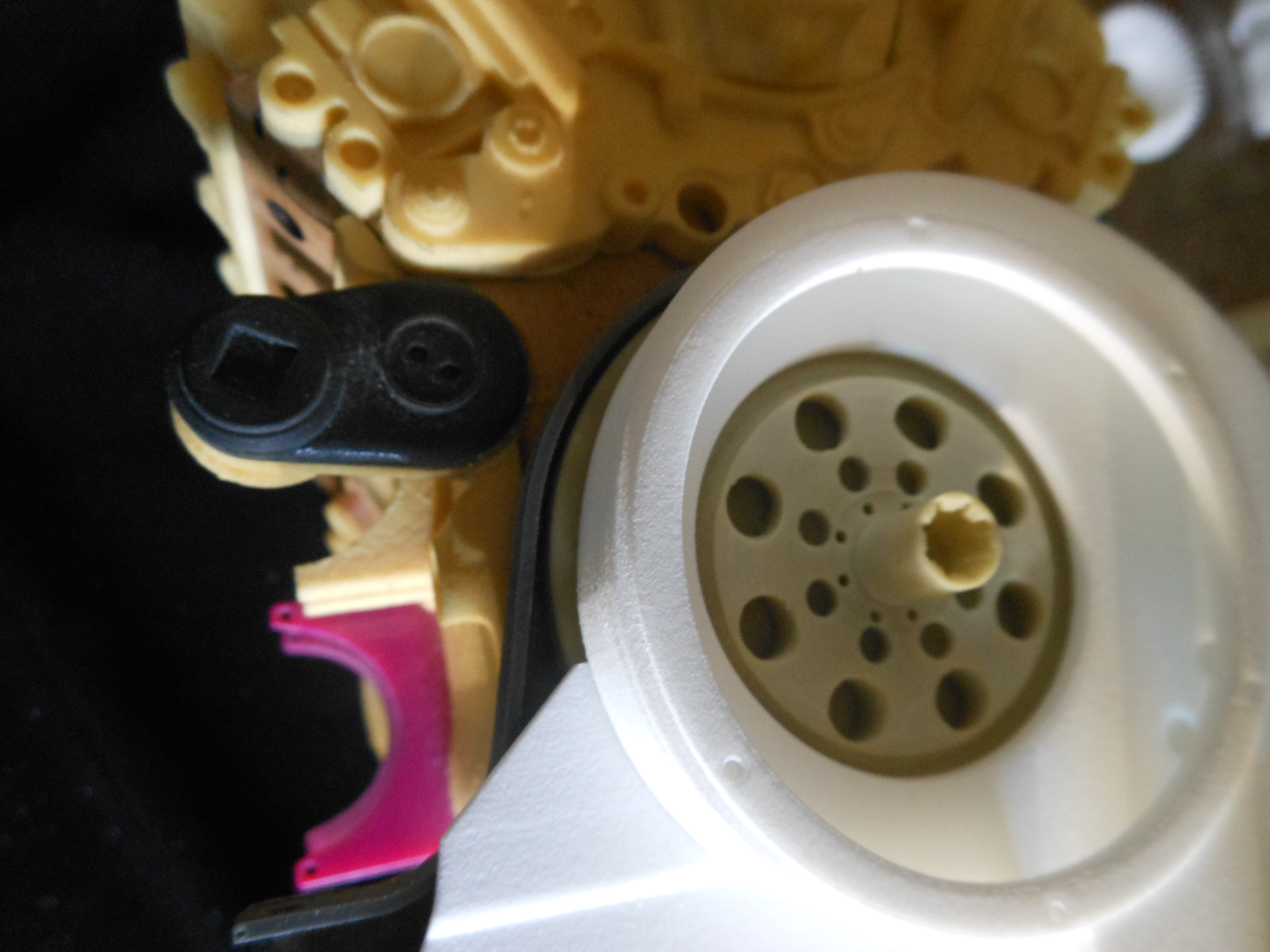

The P30 differs from the P45 in the presence of the sirocco fan on the back. After this first assembly phase and before continuing, I suggest painting the internal parts. But do as you wish
First of all, drill the base of the motor support. I forgot to do it, you must not forget it
Glue the two parts of the fan together
With the help of the small disc glue the support to the engine skeleton, I also put two through screws, for safety, but it is not necessary.
Glue the engine flywheel onto the support.
It should be positioned so that it is in the center of the box containing the fan

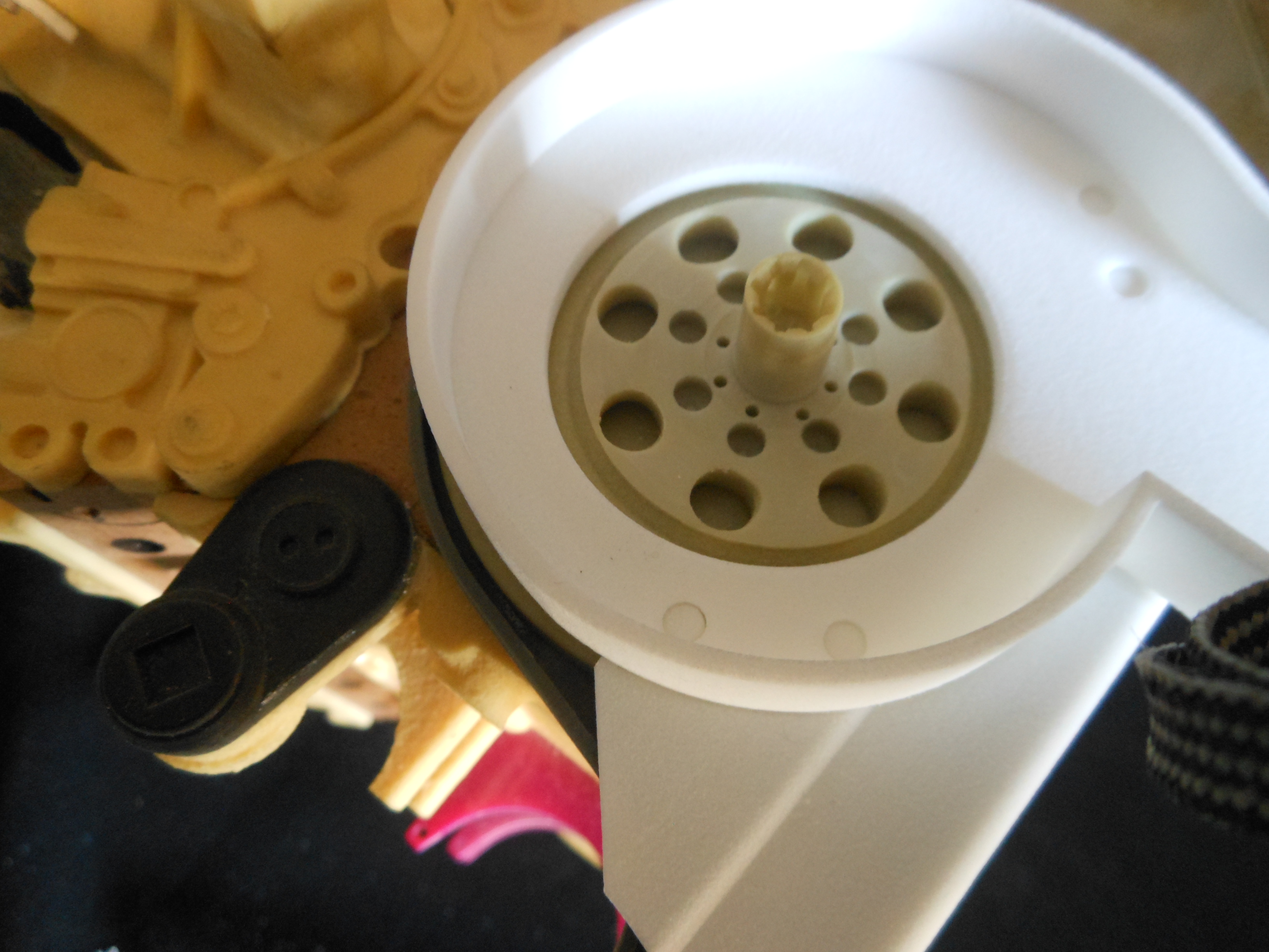

You may have noticed that all the sirocco fan is not aligned with the engine mount or the flywheel, IT IS CORRECT
Maybe in my description I say trivial and obvious things, but for newbies I hope they can be useful. Please, if it is not clear what I am writing, tell me. I remind you that I use the Google translator
