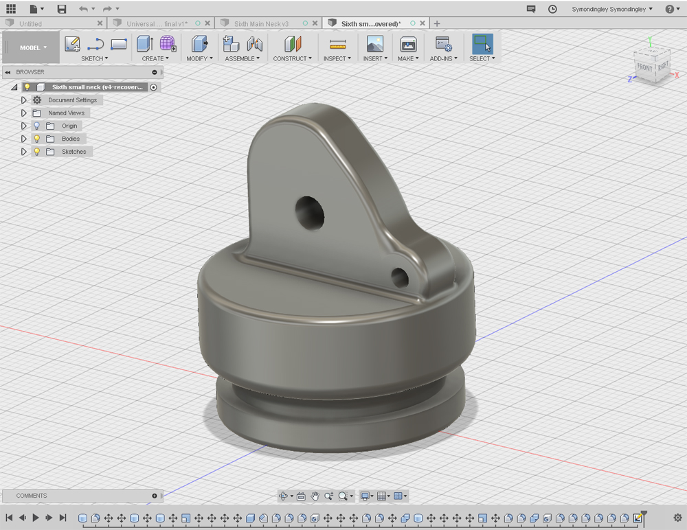

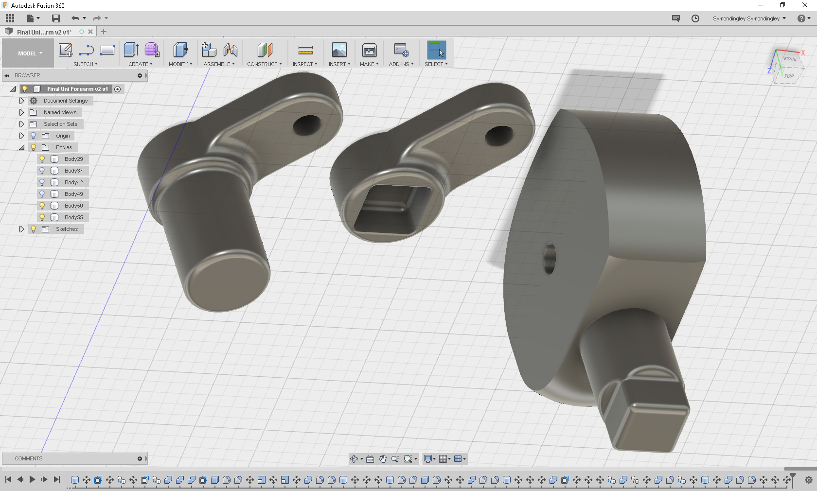

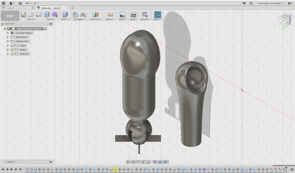

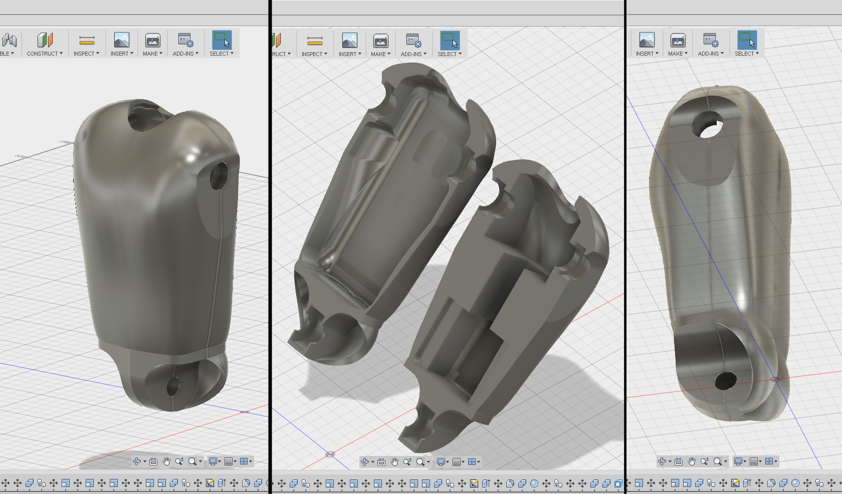

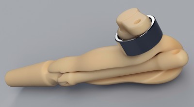

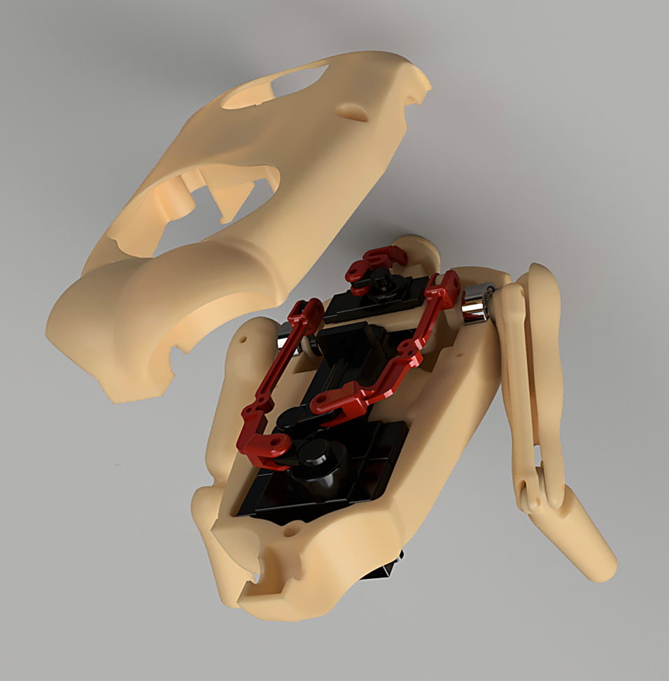

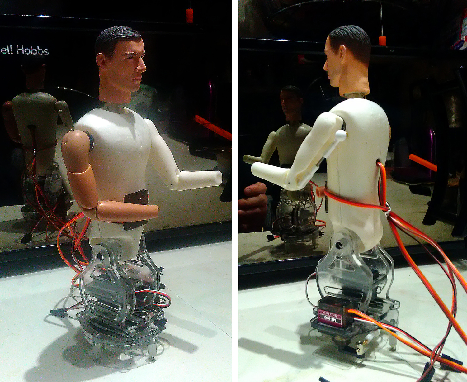

Hi everyone, I haven't been on here for a while! :)
I've recently joined the 21st Century and bought a 3D Printer and Laser Cutter, as a result I've spent the last month or so redesigning my animatronic kits with the intention of printing them rather than traditional casting. This will mean a more accurate and simplified kit that is easier to build with the added ability to adjust components to cater for customers needs. Apart from 1:6 scale I also produce kits in 1:7, 1:5, 1:4, 1:3.5 and 1:3rd scale, mainly aimed at the model aircraft market. I also have a new laser cut pan & tilt base that replaces the old cast unit (see pics below).
Thanks to those lovely people at Photobucket I have lost all the pics from my how-to threads, I'm in the process of producing new versions that will be more intuitive, so please watch this space. :)

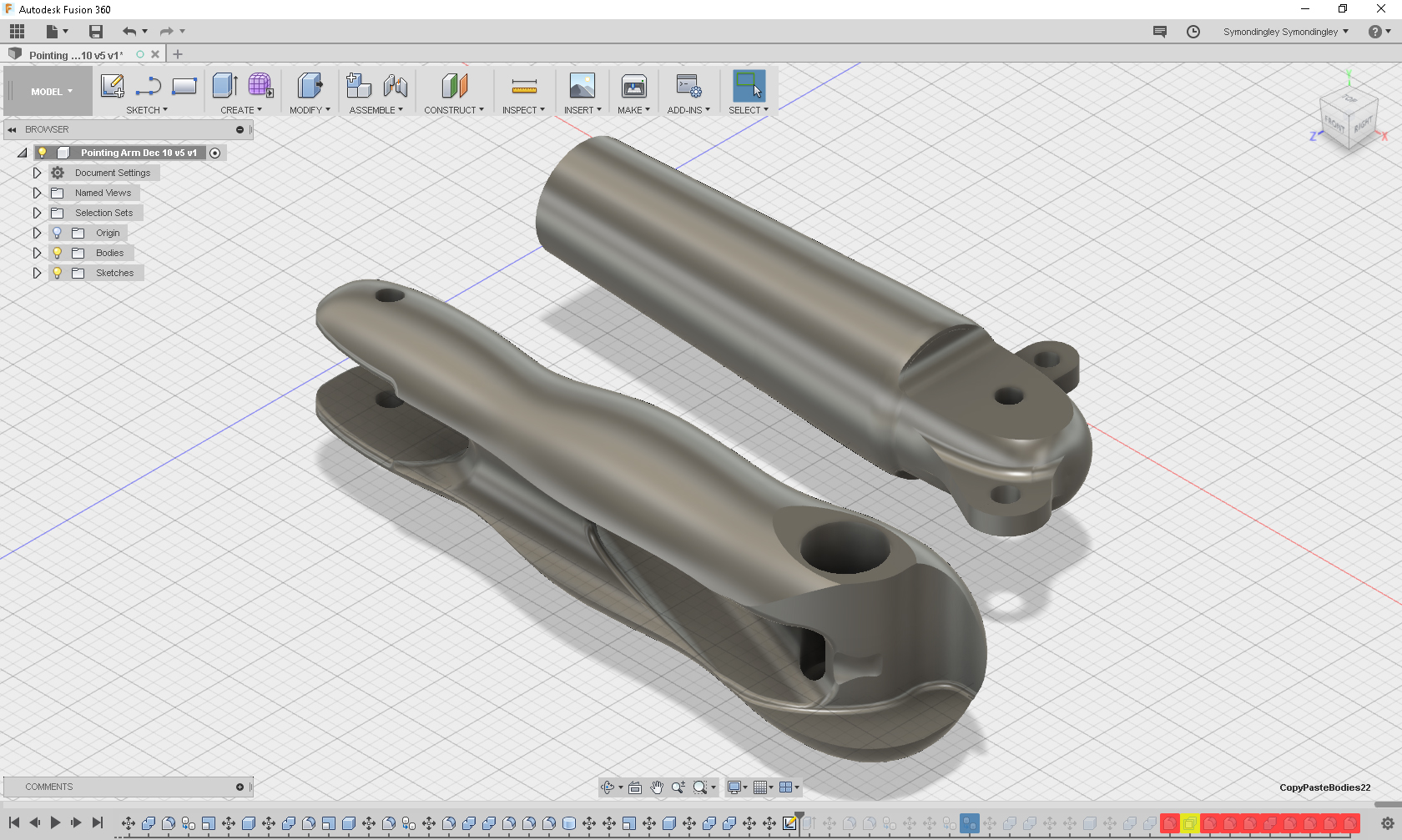

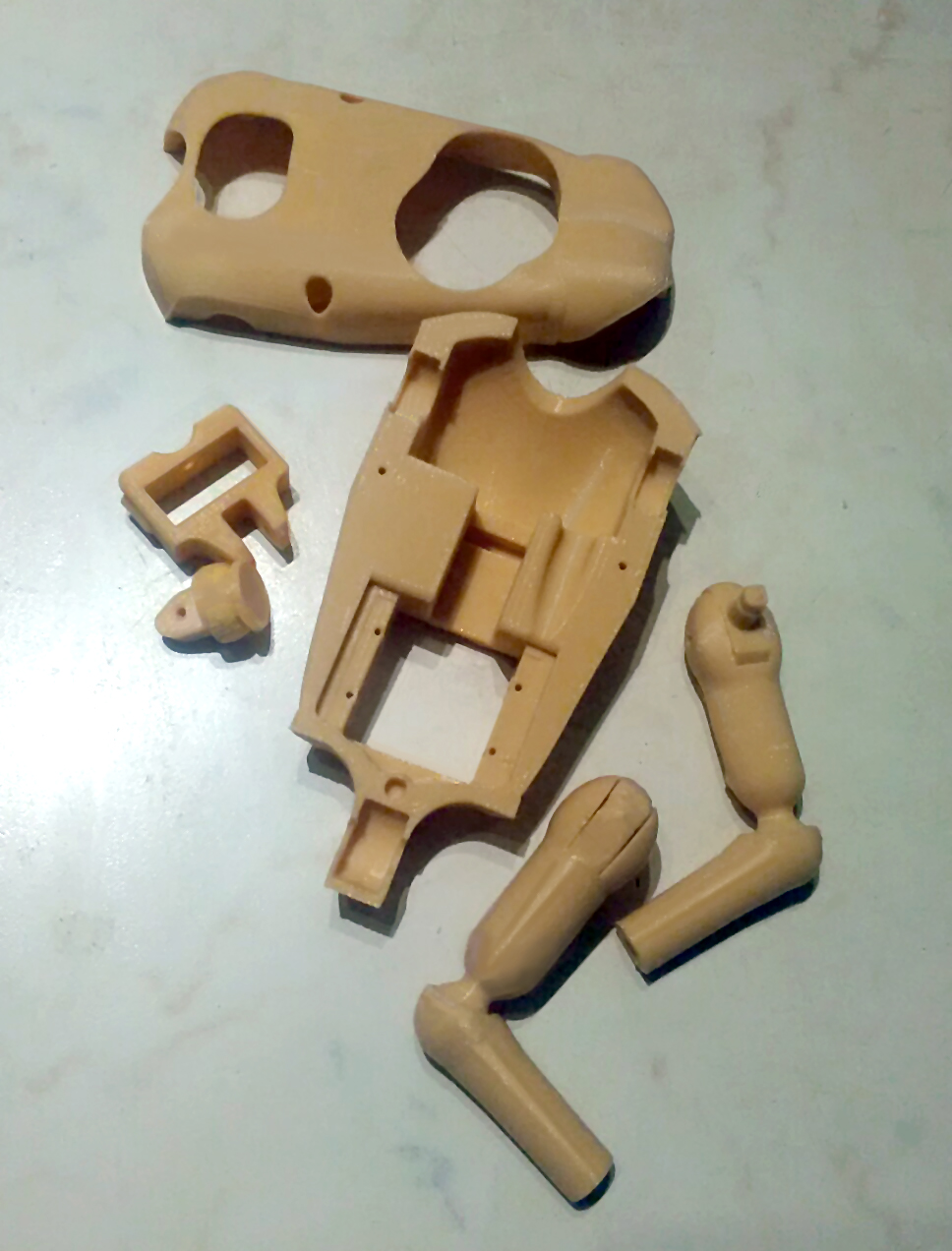

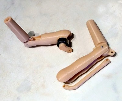

I've finished drawing all the parts for the 1:6 animatronic kits at last and have started printing the first new kits. :)

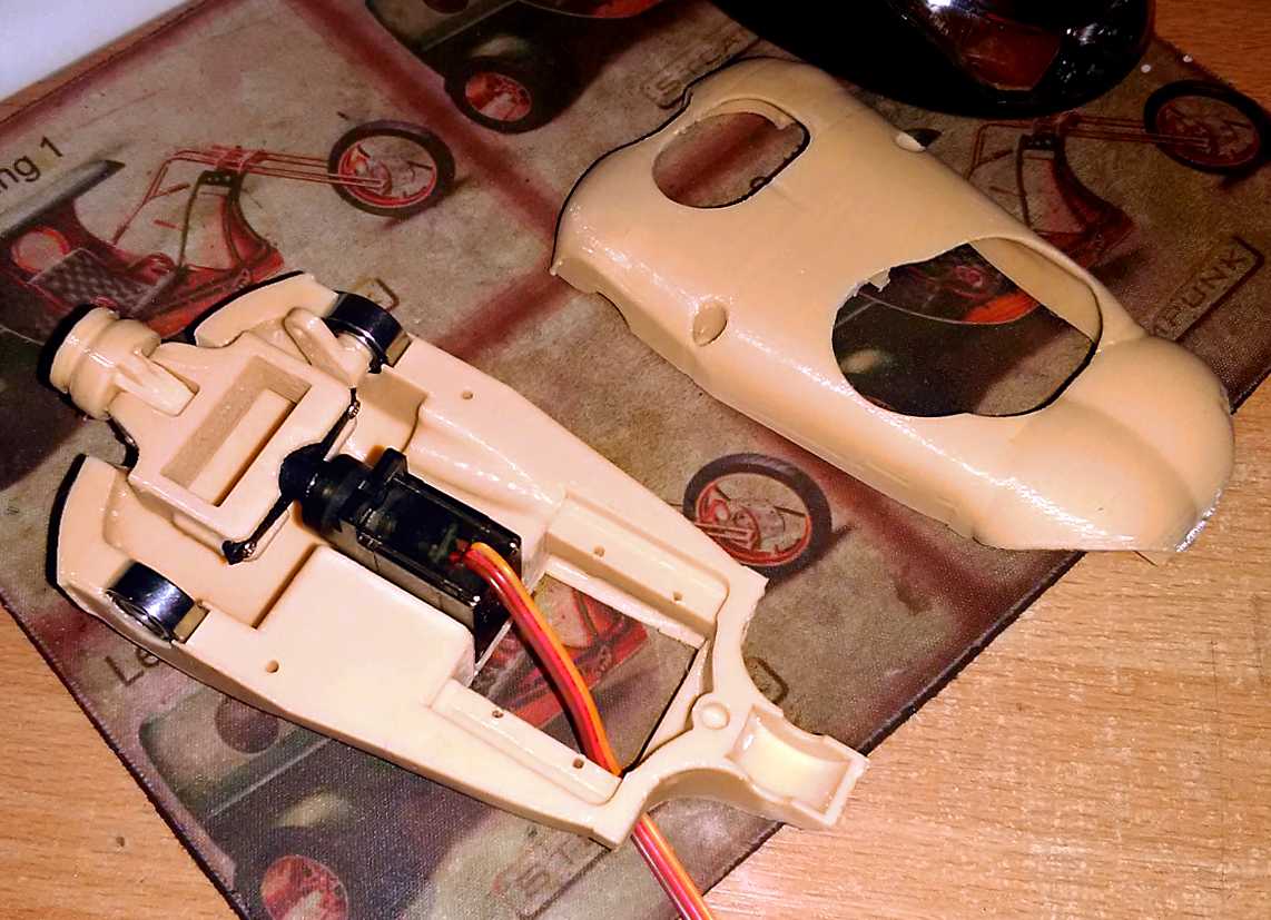

After a lot of tweaking and adjusting the new kits are now ready to go, with the first few already sent.
My key consideration was to simplify the construction, with keyed body halves, parts that lock into place without adjustment or glue and ready-made pushrods to make the set-up childs play. An added advantage of this system is that all new figures will have exactly the same throws and positioning as each other, the benefit of this is I can now offer various downloadable programs for your controller card that will work on your figure as long as you centred the servos correctly. :)
Hopefully all this should mean the average modeller can assemble and program their animatronic conversion easily within an evening.
I'm also including more with each kit...
My 2 channel figures will come as standard with two universal arms and dummy bearings. The new universal arms now come with lateral rotation from the shoulder.
The 4 channel kits have a choice of either pointing or universal arms, the new pointing arms have a choice of linkage for either a point or raise forearm function.

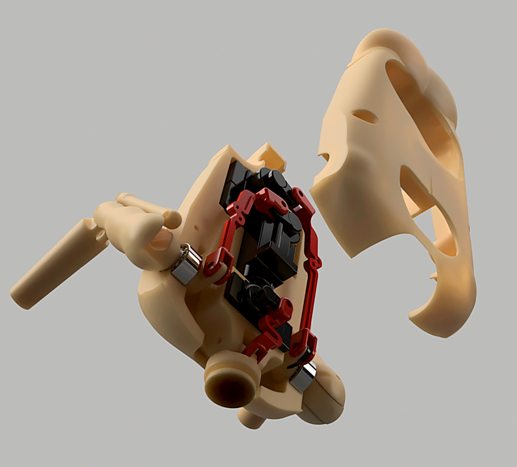

You've got to love this software, I thought I'd try some rendered grabs of my CAD work, excellent results! :)
