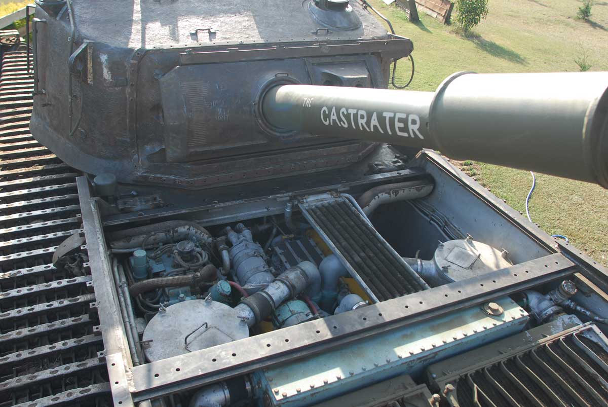

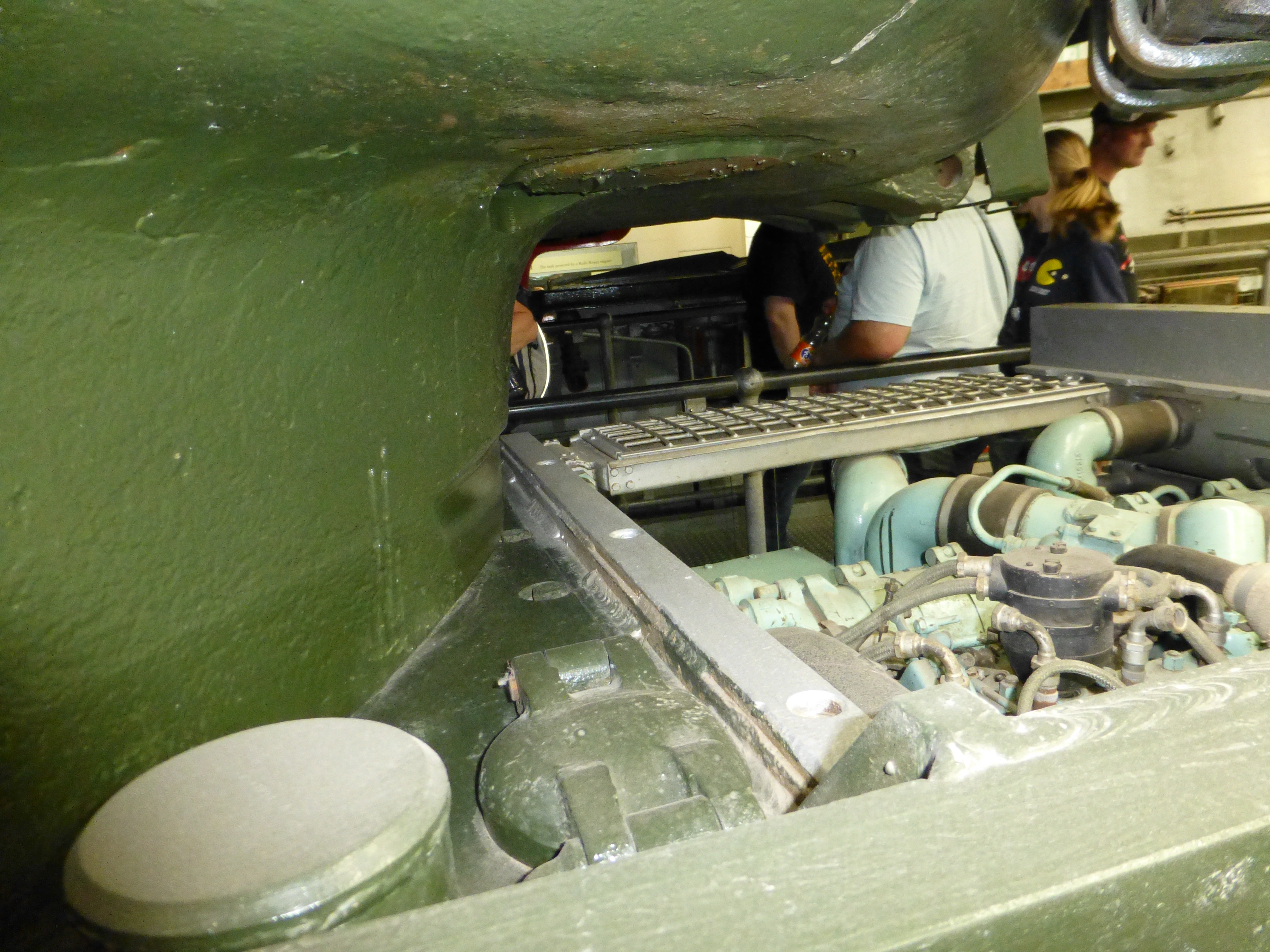

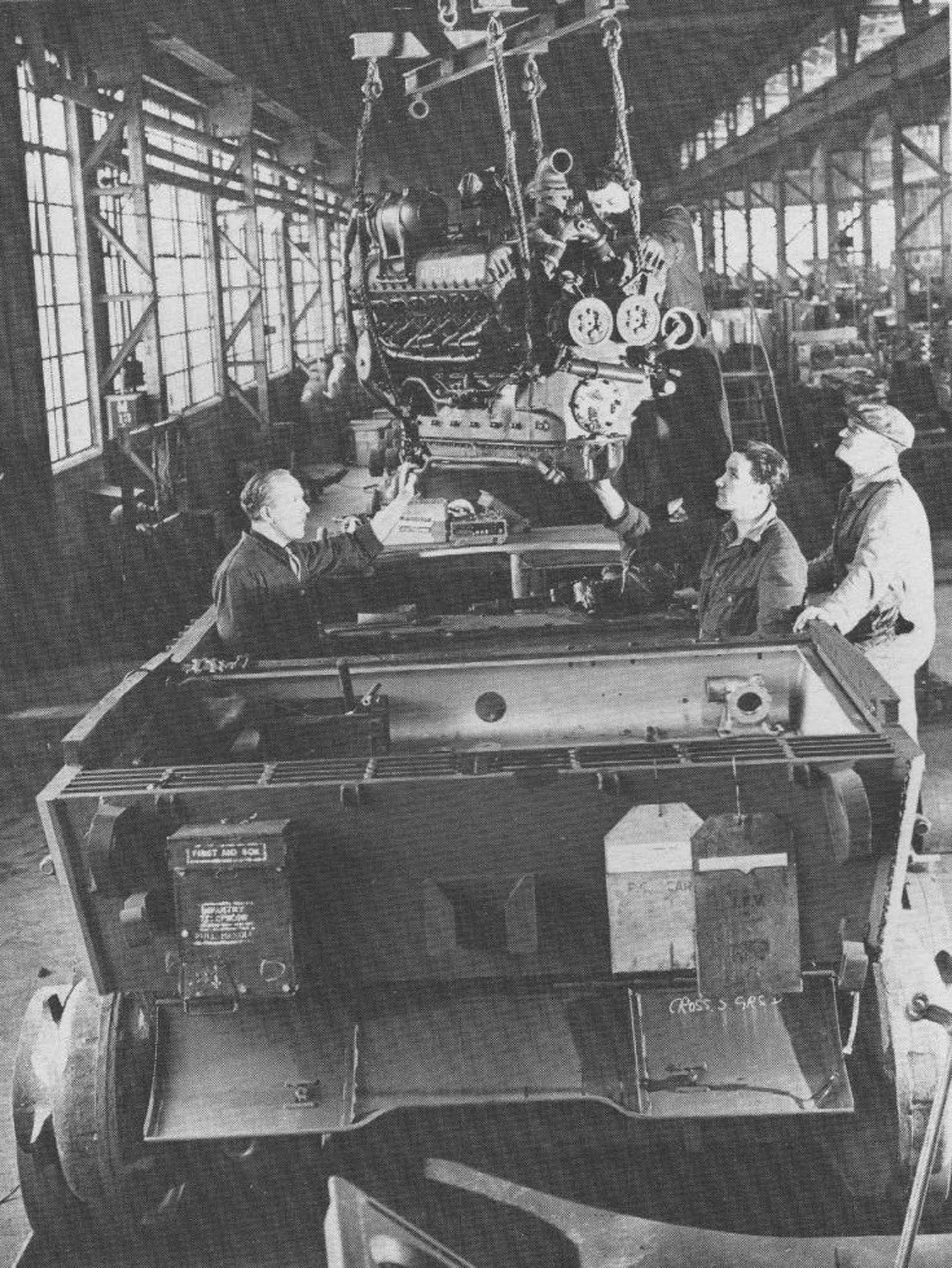

Post by Stephen White » Sun Dec 04, 2016 11:44 am
Frank
Hope these help:

Hello Stephen

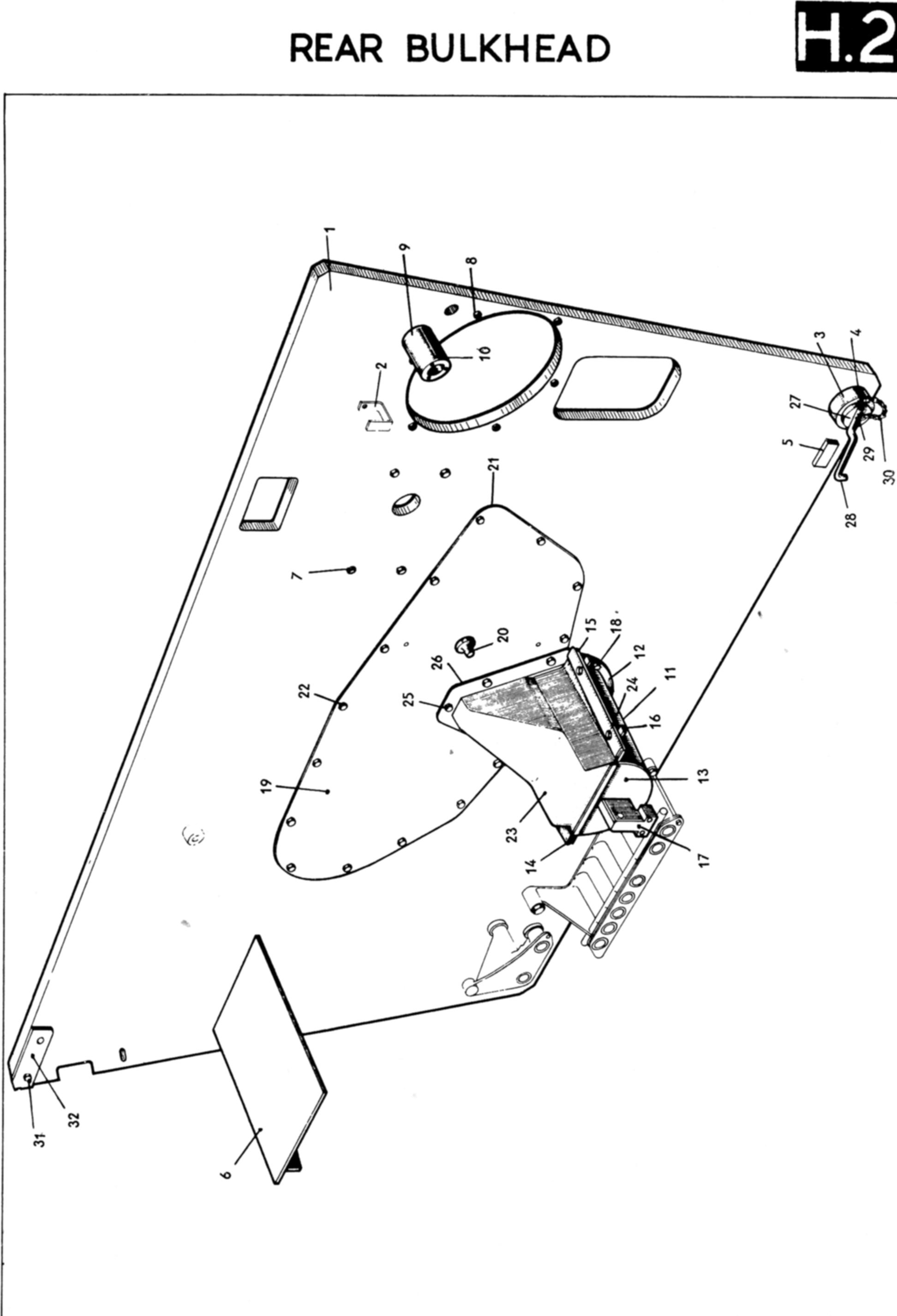

Many thanks for the pictures. Now I know more details. Can you provide an additional picture form an empty motor comartment. Actually I can not understand the design of thr bulkhead between the engine house and the gearbox.
Frank

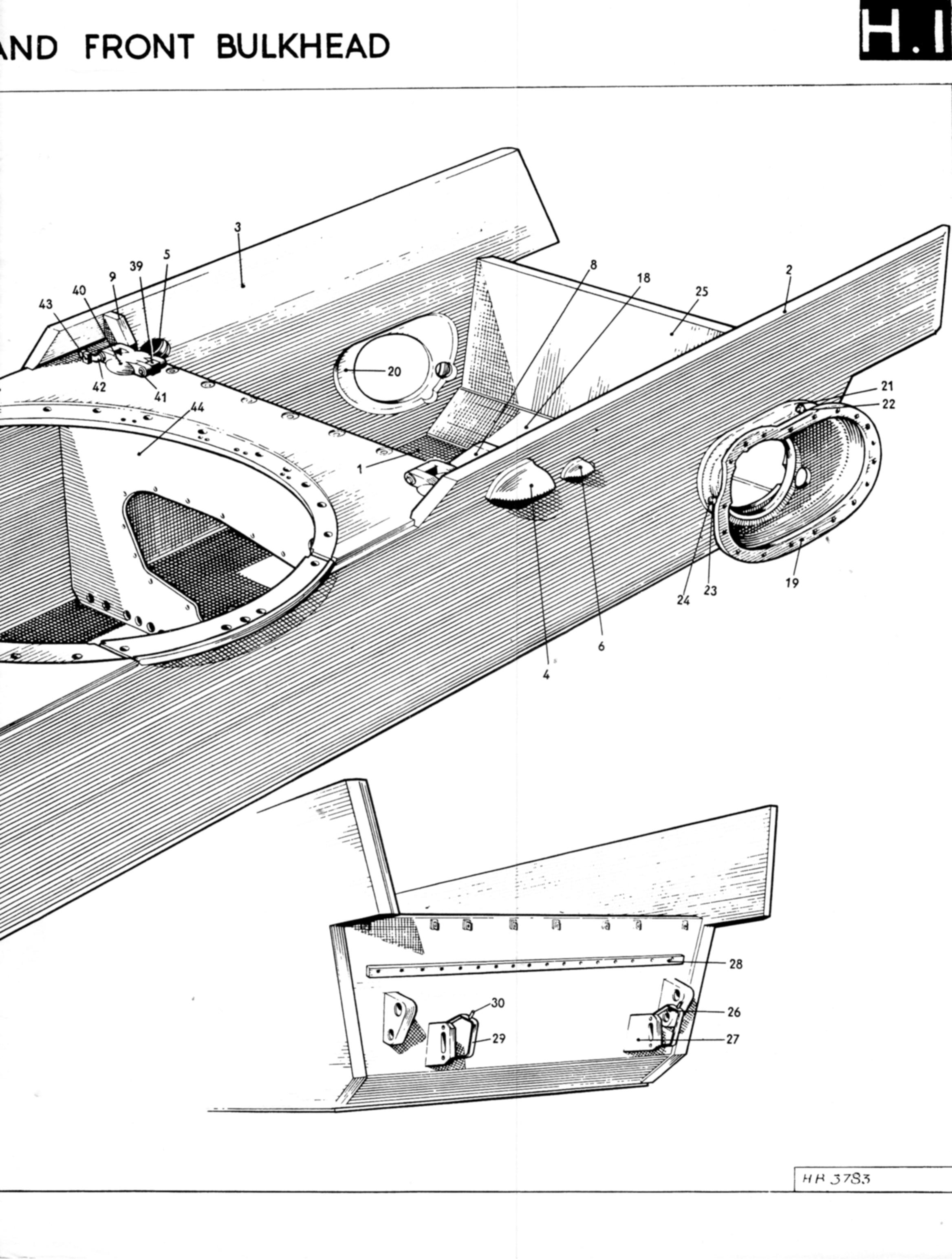

Post by Stephen White » Sun Dec 04, 2016 8:51 pm

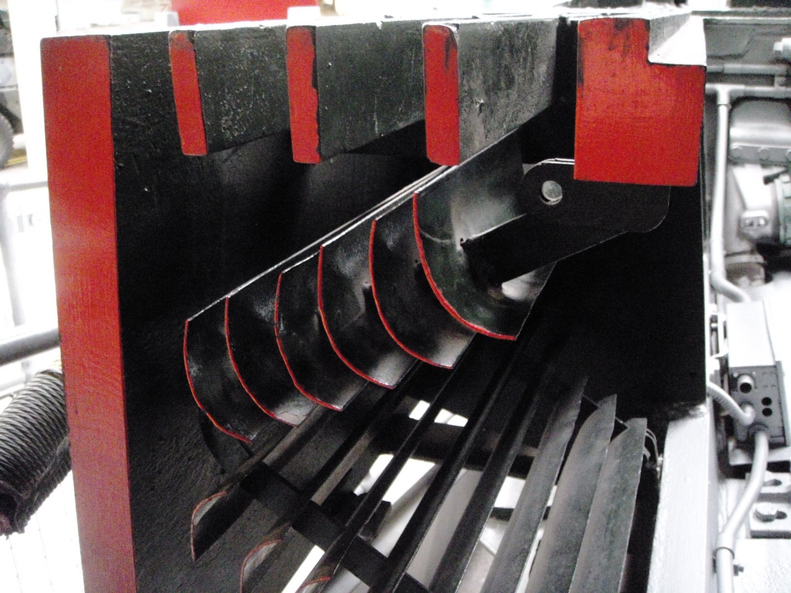

Frank, try these:

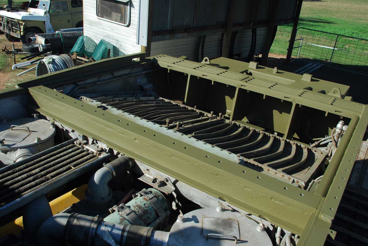

Post by Stephen White » Sun Dec 04, 2016 8:57 pm
Frank, I haven't any photos of the engine and transmission compartments empty but this link below takes you to a .pdf file of the restoration of Australian Cent ARN 169065 with some low res pictures which might help:
http://www.paratus.org.au/single-post/2 ... update-one

Fabrice: A very interesting spray. The layer thickness that I use is 0.09mm. So mostly it is o.k. for the rest I use sandpaper.
Stephen: Yesterday I study your photos. I think now I have an idea what I have to do. May thanks for your information and in advance for your PM.

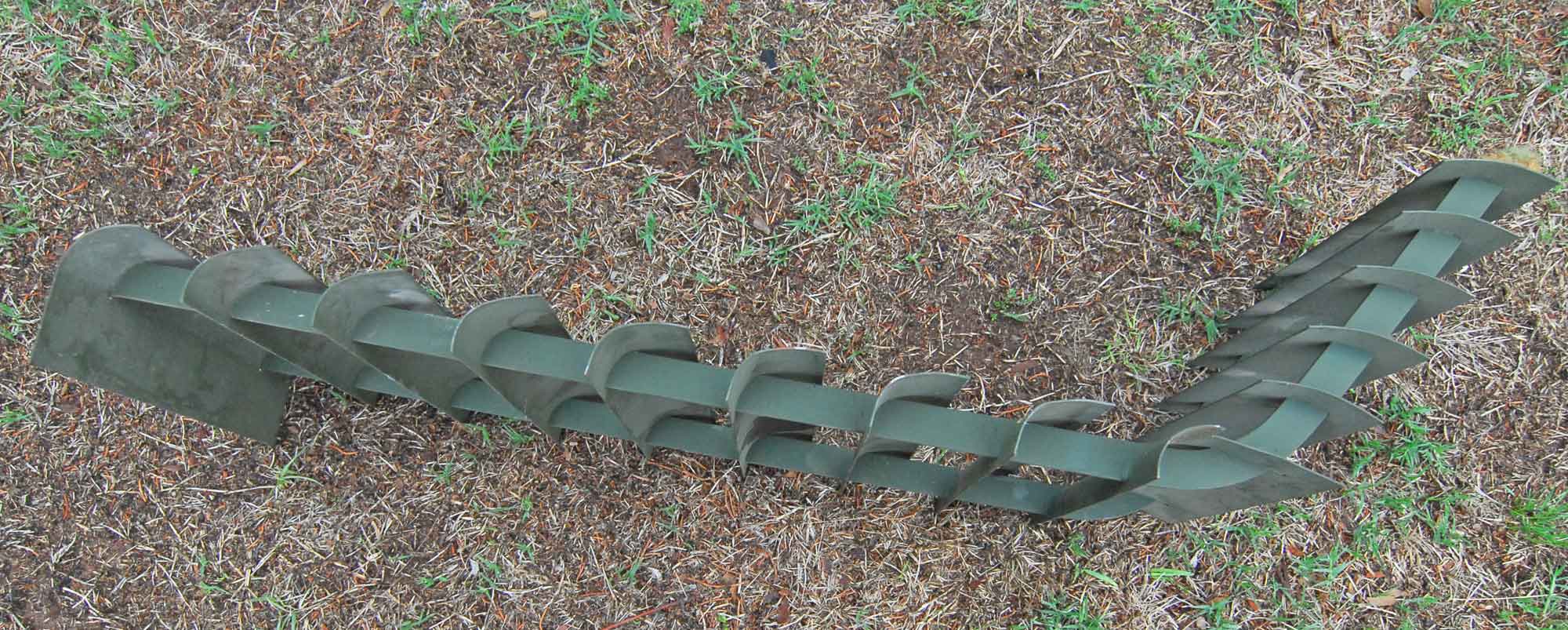

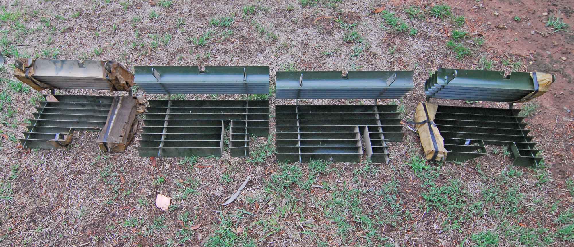

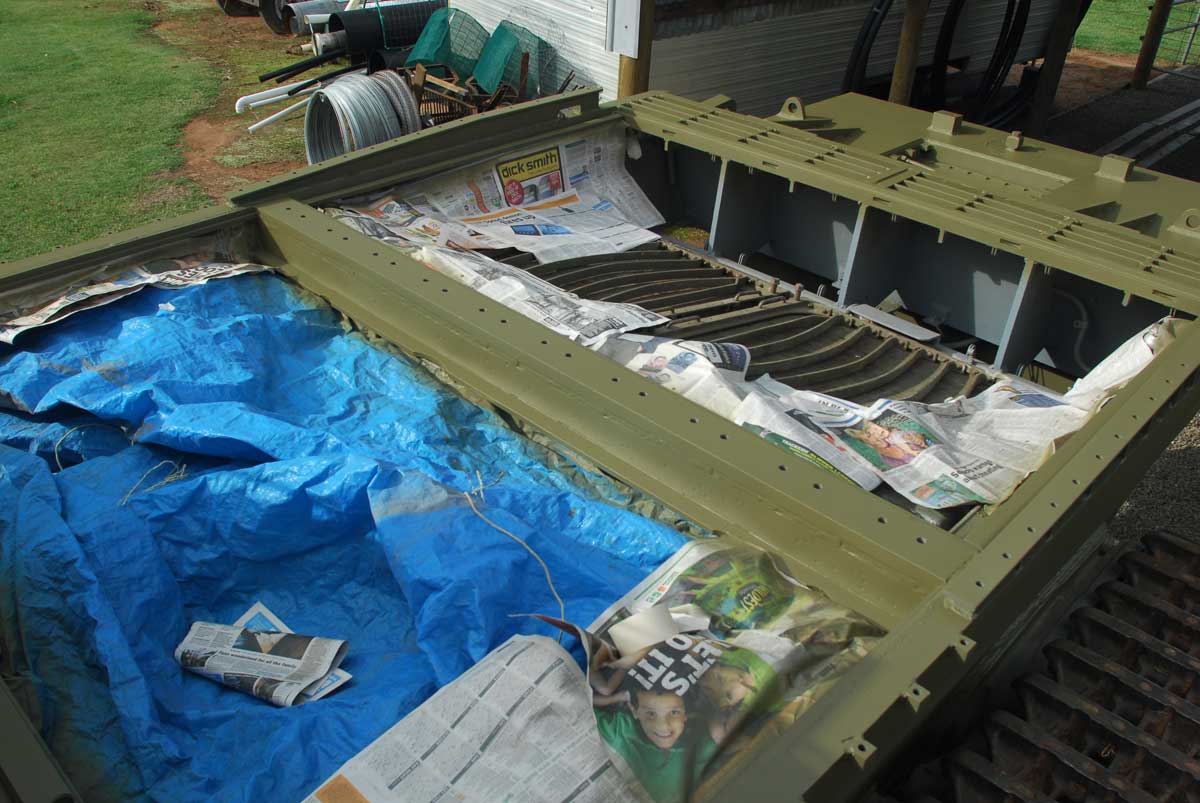

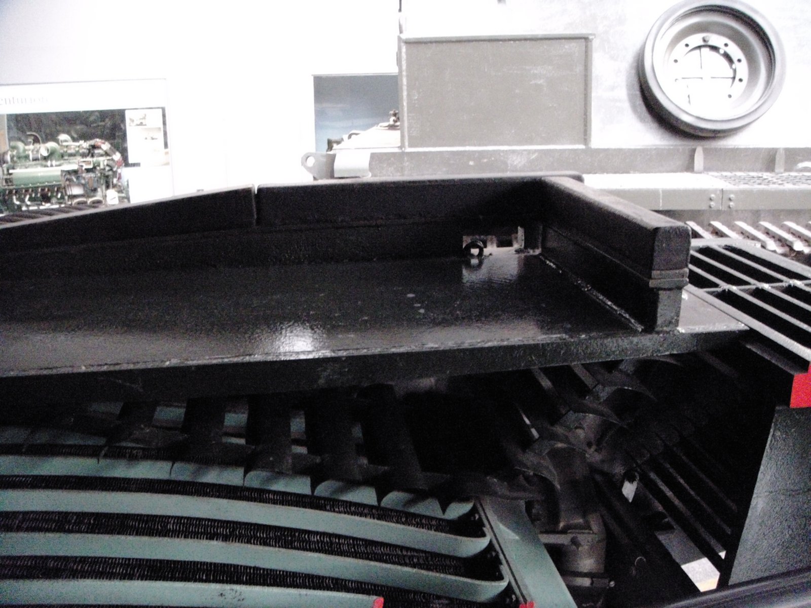

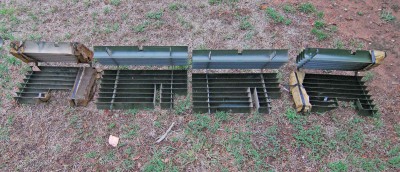

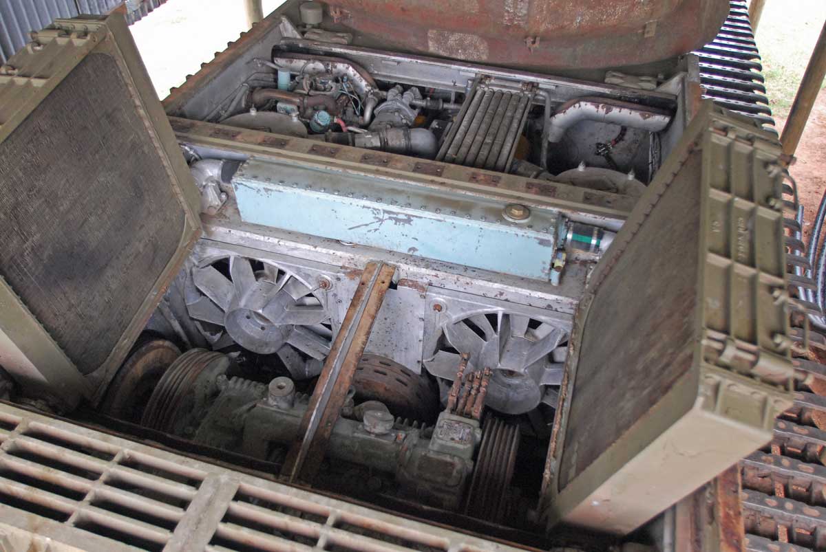

Post by Stephen White » Wed Dec 14, 2016 8:41 pm
Frank, these are the set of louvres/cooling baffles under the rearmost part of the hull. Note the differences:
These are the baffles under the gearbox covers ie those which sit on top of the radiators:
Inside the hull rear:
Hope that helps. I like the printed parts, so much easier than making them by hand. It took me far too long.
