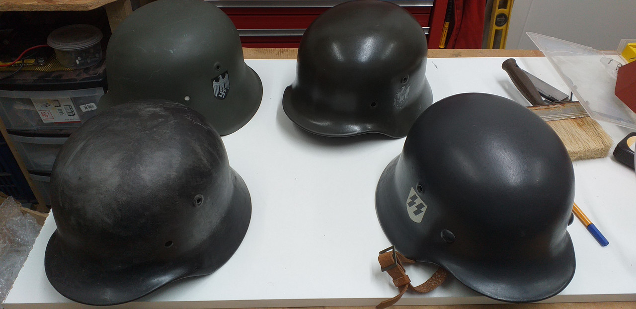

I probably should say this is for stripping paint from a number of stahlhelm I have the paint is tough on some, do you think Nitromors will still work Adrian.

Thanks for your replies this will help with my project, a number of these helmets are post war repaints in the wrong colours with poor quality cheap decals only the M42 in the top left has the correct colour.
