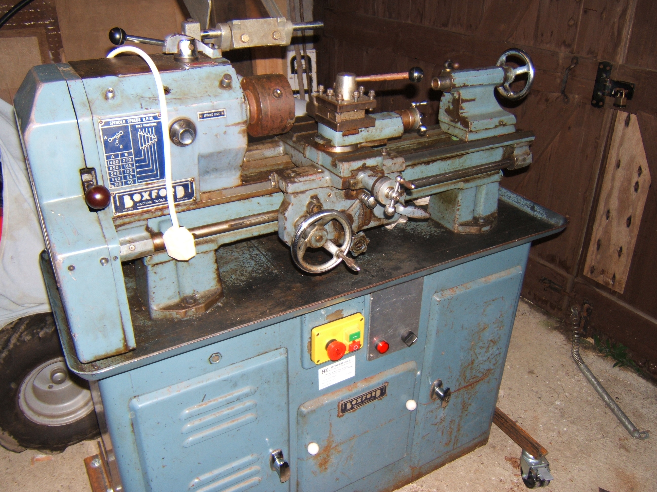

There are still a few ex-schools Boxford lathes that come up on ebay (spit) from time to time, though you will need to budget for another 200 squid to convert most of these to single phase as they are normally 3 phase electrics. Been there, done that, got one in the garage. The Myford ML7 and its ilk (Super 7, ML10) are in-betweenies because (a) they are overrated (again in my opinion) and (b) usually overpriced compared to what you get from a 'bigger' lathe. A good selection of spares is still available for the older - 1950-1980s -Boxfords, and basically the same design is still made by South Bend in the USA (but you really don't want to ask the price...) There is also some spares support for the Smart and Brown machines, if memory serves me right.
Last comment here would be come back to portability. If you put the machine on a set of lockable castors, you can easily move it around the garage or workshop. For when you drop that last M10 nut down the back.... Castors on my machine are mounted to angle irons, which are then offered up and bolted through the cabinet end plating.

Hi Francis.
Wow that's a blast from the past in the old metalwork rooms at school they had three of them in a row :D
Cheers Paul. :wink:

Similar to what I trained on in cold metals in college for my industrial arts degree.
I cannot remember the first thing about it.
