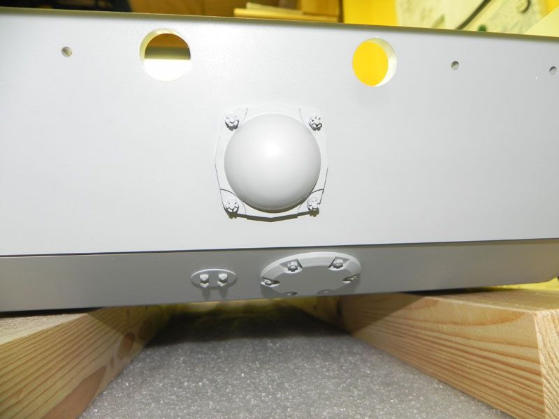

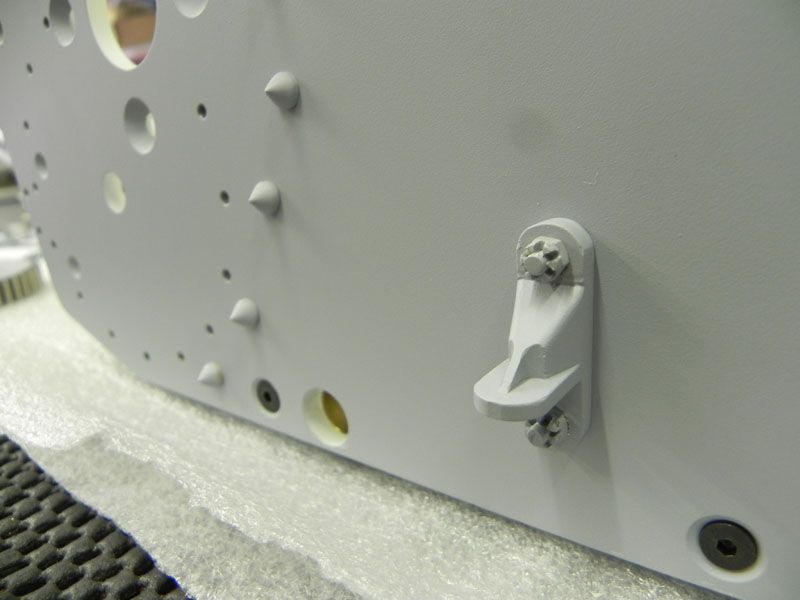

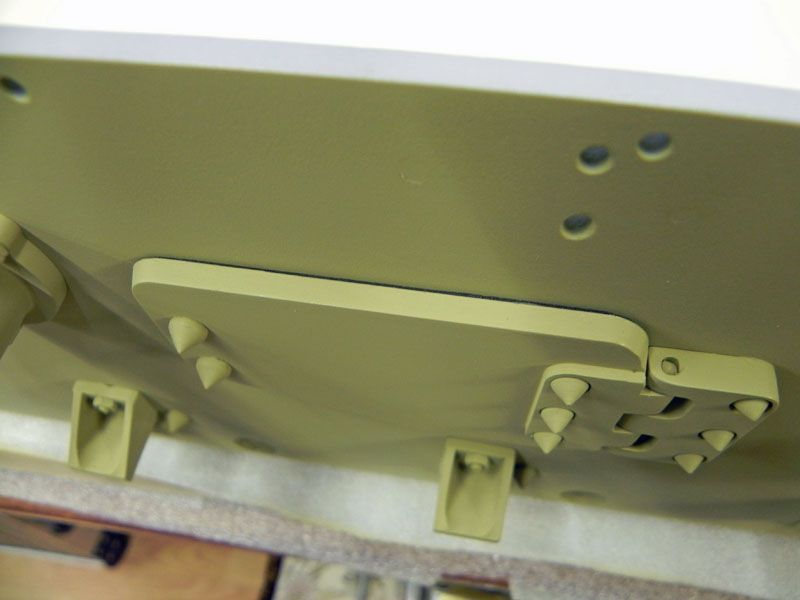

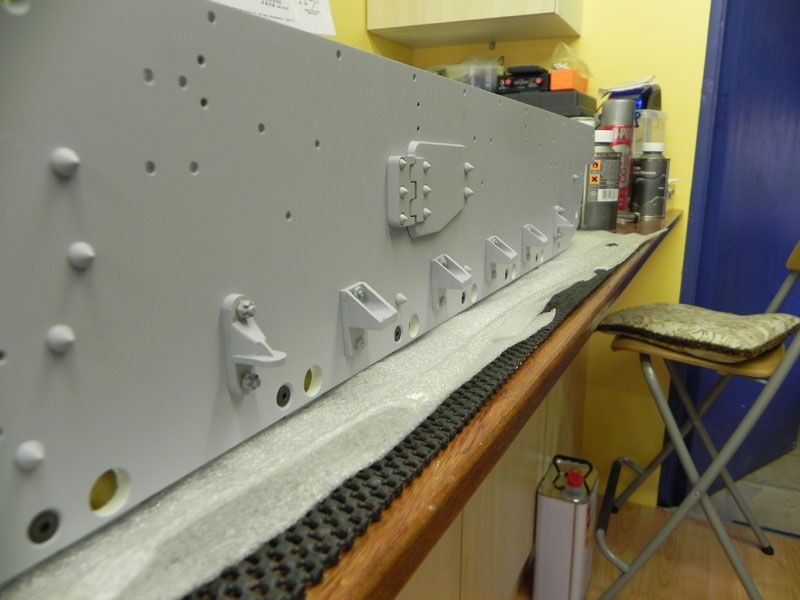

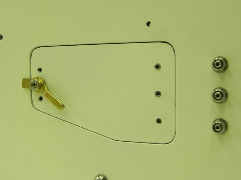

Well the Lower Hull has now been painted in etch primer and put together, at last.......
I've fitted the Cone Nuts on the Hull Sides where they should go, though I have noticed that Stephen has a few more on than mine.
The panel brackets still need a little fitting before they can have the fixing holes filled.
I'm pleased with the Starter Cover and as the thumb screws work, I'm wondering whether to put some detail behind it.
The Escape hatches fitted quite well, though I'm looking for some thin rubber to act as a gasket to stop any water getting through the gap.

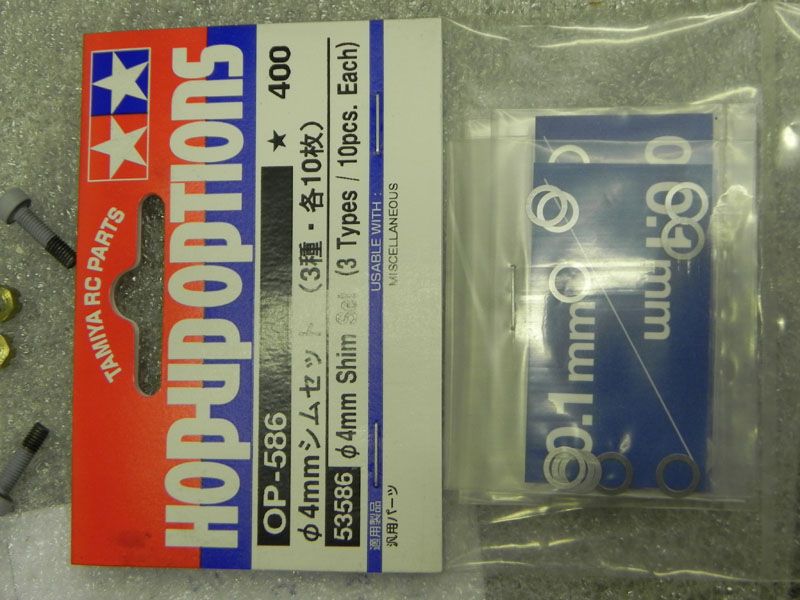

When the Return Roller housings were assembled I found I needed a spacer to stop them from binding. I used these 4mm shims, which worked out great, 0.4mm behind each retaining washer. The pack includes 0.1, 0.2 and 0.3 mm shims.
More later on.

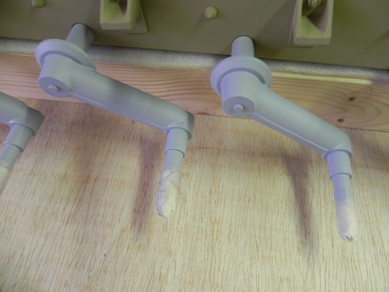

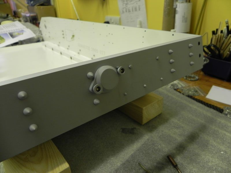

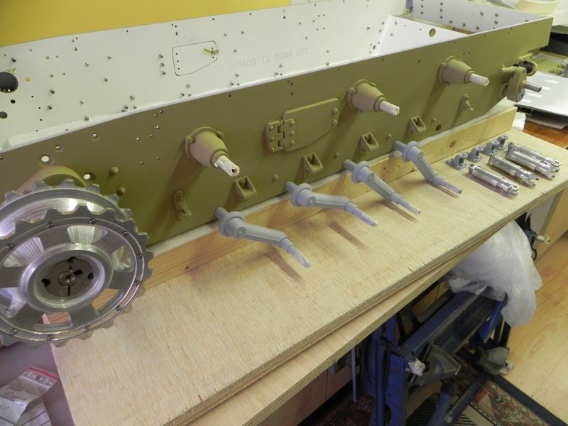

My Panzer III build has come on recently. I've managed to spray the hull in primer and it's base coat, along with quite a few other component parts.
I've finally got round to add the strip along the front of the suspension arms, which represents the casting line, and also apply some primer as well.

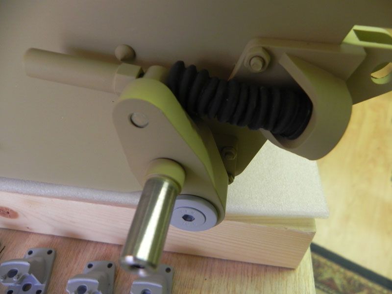

I've also added small bolts to the suspension units, I still need to add the covers with the big 'O' to the front yet. The wide angle lens has distorted this picture a bit, the suspension units don't actually bend!
I managed to find some rubber gaiters to cover the idler adjusting bolt.
I also added a thin gasket to the side escape hatches.

Looks great Sarah, a very clean build. Your suspension arms are excellent!.

Well Done Sarah . All your hard work is paying off , The detail is spot on . How are you doing your fake welds ? . I love your suspension arms . Dale

Excellent looking part. as others have already said, your swing arms are clean and perfect looking.

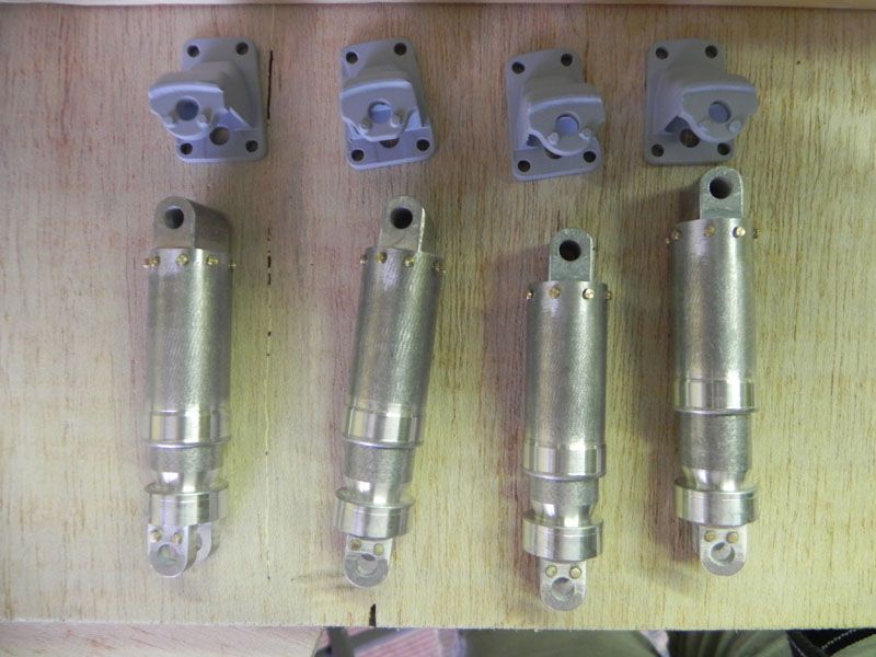

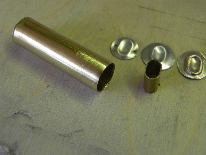

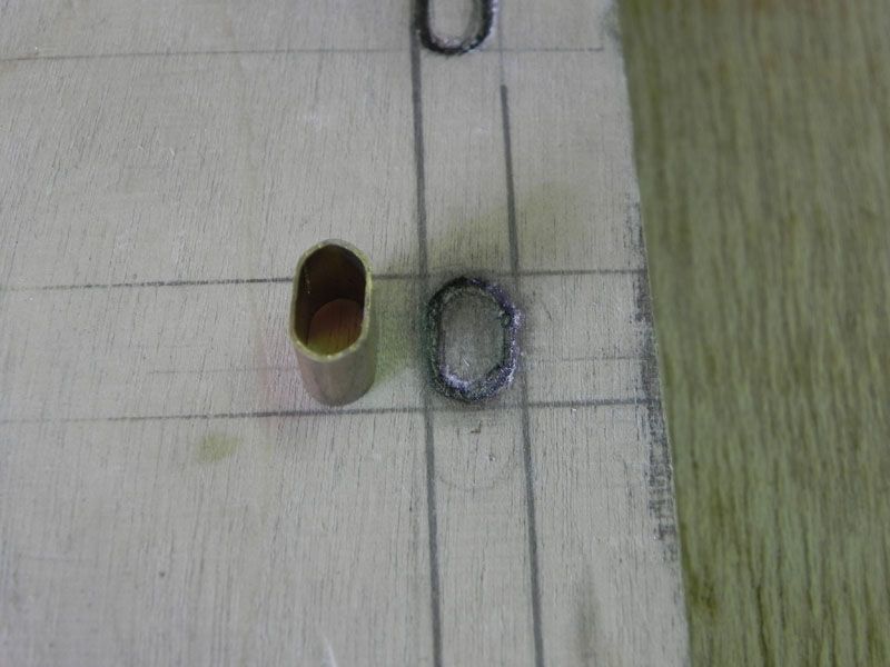

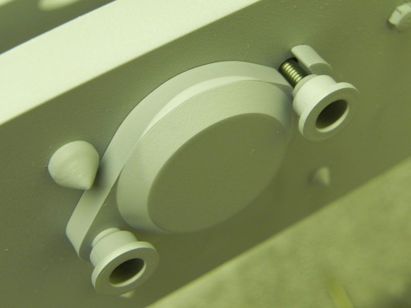

I did struggle with getting the embossed 'O' on the inspection plate on the suspension units. I eventually came up with a method which works reasonably well. Fist get some brass tube and shape it to for the correct profile. Then draw around the brass tube on a piece of wood, cutting a shallow recess into the surface:

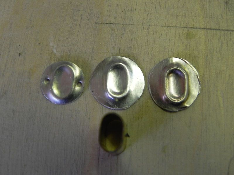

With a bit of aluminium sheet over the recess and using pencil marks to align the brass tube, tap it gently so the aluminium is shaped into the recess. A bit of trial and error is required to get the correct amount of embossing. The aluminium sheet needs to be oversize at this point, otherwise the material gets very distorted.
It might be best to make more pieces than you require and then select the most similar. The pieces shown in the photo below are all trial pieces, the best ones went on the shocks.
Cutting the inspection plate out with scissors proved a little difficult, so I sharpened up a larger diameter brass tube and used this to cut the inspection plate out.
The inspection plate on the suspension unit:
I hope this is of some use.
