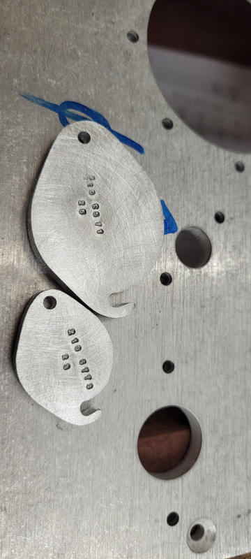

Masters are ready they are designed as the original to lock into place on the rear plate, they will be going away for casting this week

Hi Mark,
They look wonderful, two sets please.
