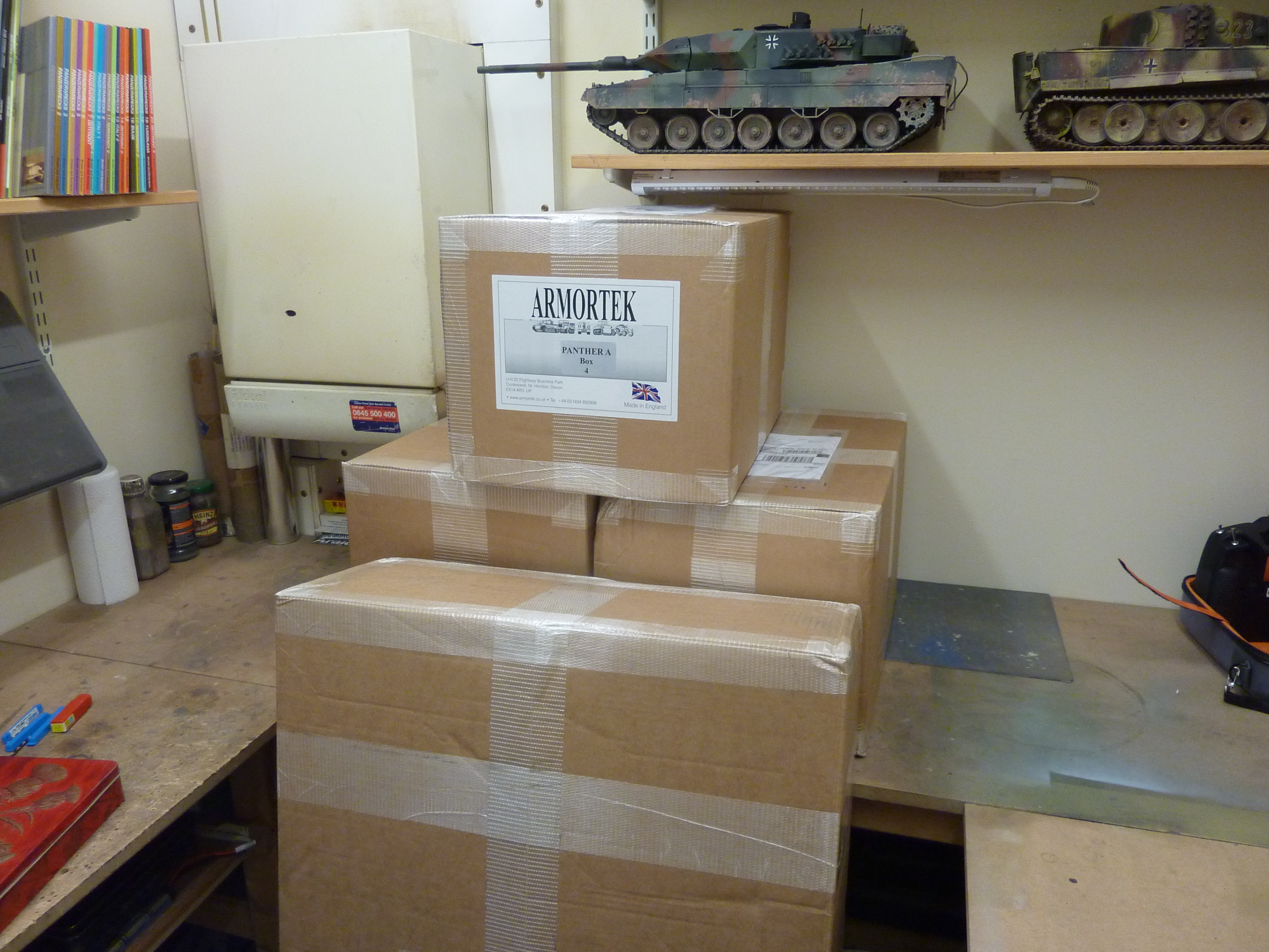

It's arrived !
Awaiting unpacking and hopefully a build log as things progress.
Ready to get started

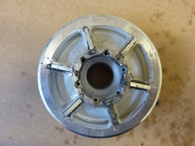

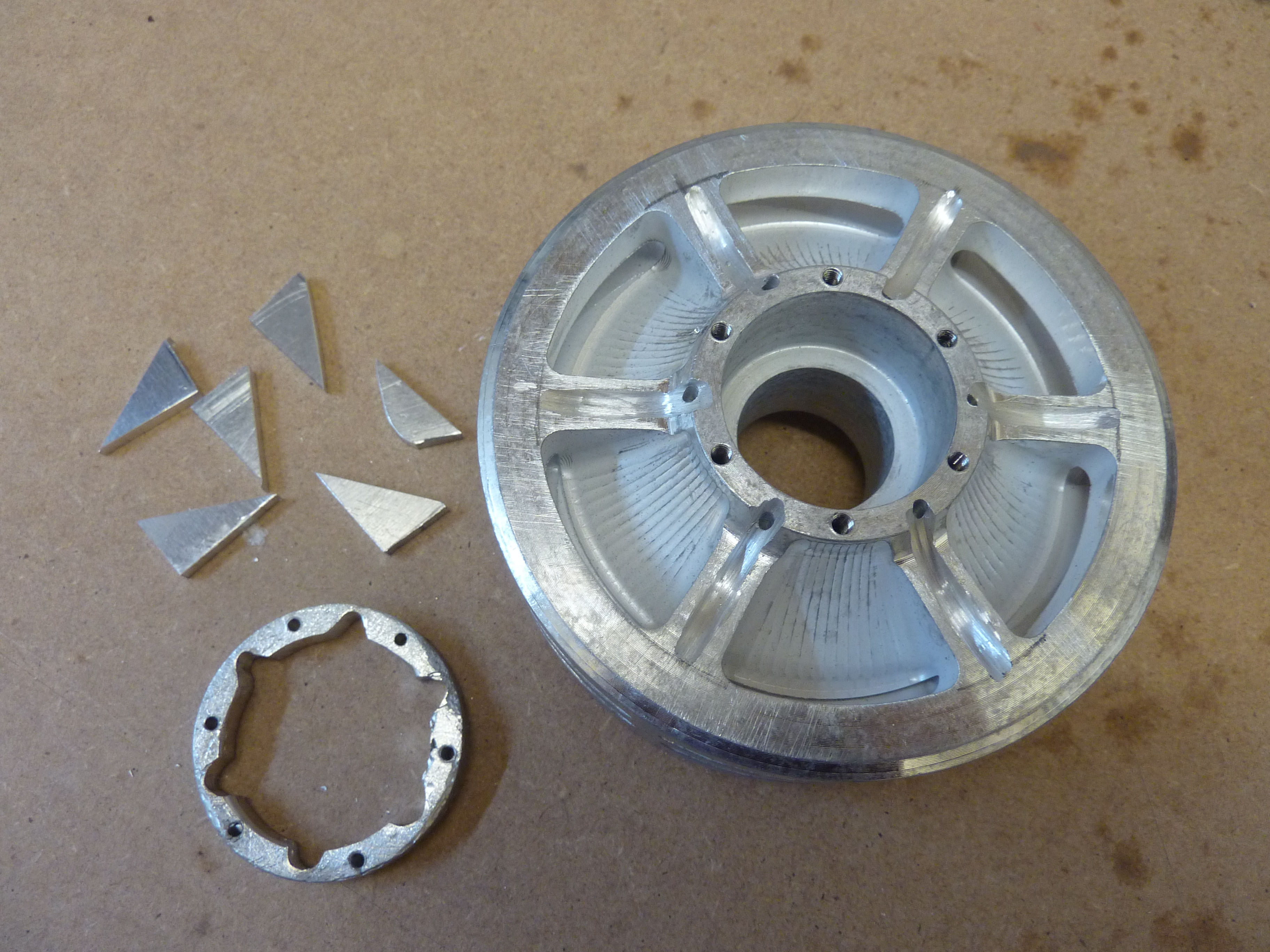

First step in my Panther build.
I know it's a little out of sequence but I felt it was a good place to start with some corrections and a bit of detailing
As supplied the idlers have overly thick reinforcing webs and the central boss does not stand proud enough.
My plan is to add a 6mm extension to the central boss and more in scale webs .
I have cast 2 white metal extensions for the boss which will be bonded and pinned to the idler, new 3 MM thick webs will then be bonded into slots cut into the webs.
The new boss extension and roughed out webs. The original webs have been thinned using a Dremmel and these will be blended into the new webs with some filler.
More to follow

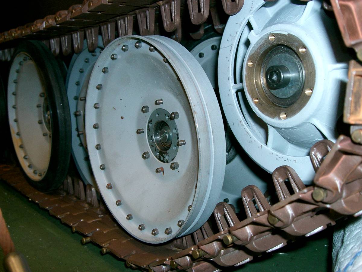

Regarding the Ausf A idler, have you notice my own?
Night be useful regarding the bits and bobs.
(scroll down a bit)
http://www.armortek.co.uk/Forum3b/viewt ... &start=195
Kind regards
Kent
It´s all in the details!

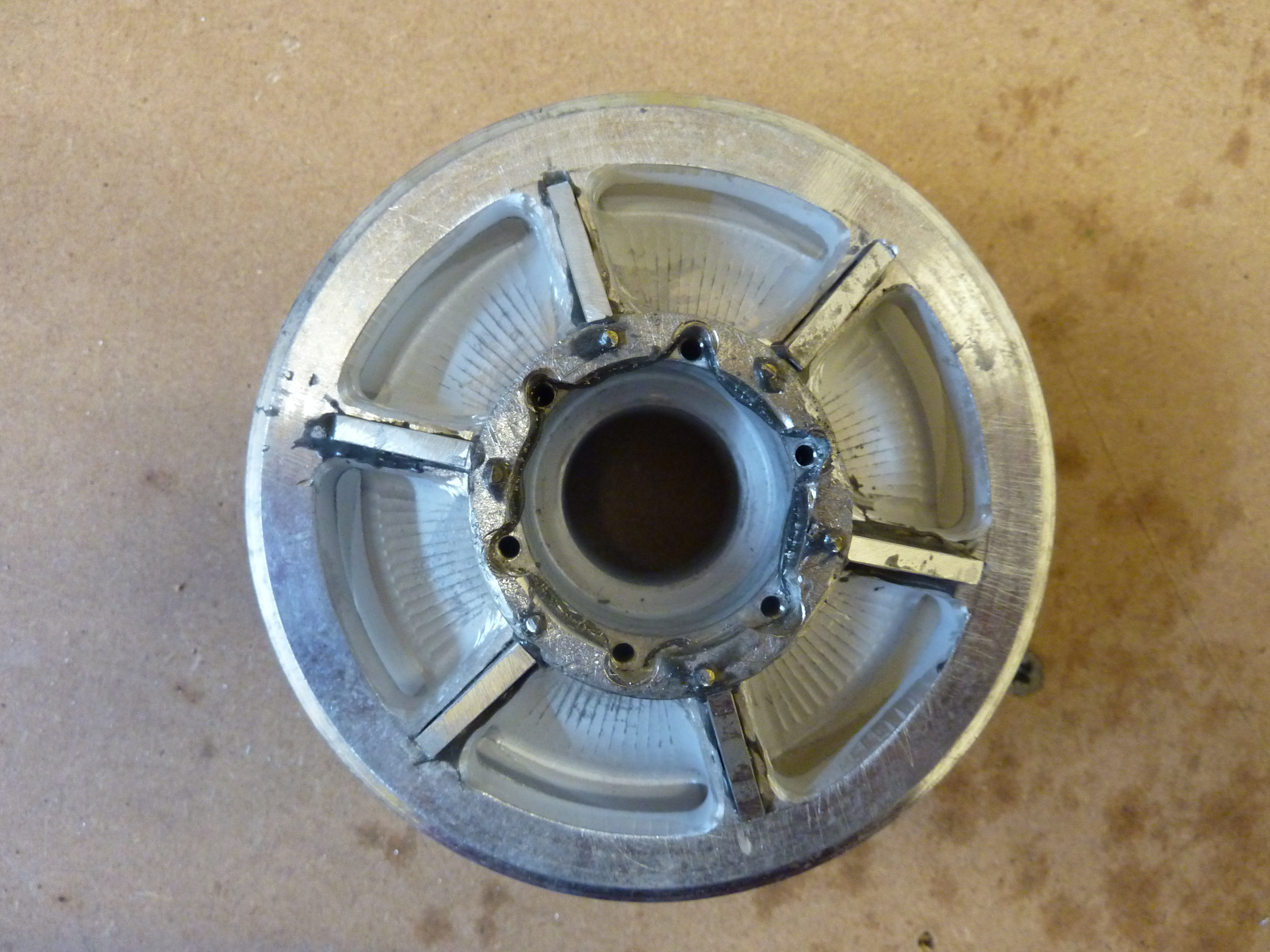

Steve Norris
Posts: 921
Location: Manchester
Been Liked: 107 times
Re: Steves Panther A
Post by Steve Norris » Mon Apr 03, 2017 6:51 pm
Hi Kent,
Very nice idler and just what I need. Unfortunately my idlers will need work to get them somewhere near. As far as I know there are no aftermarket idlers available so modifying the supplied ones is the only option.
Central boss and 3mm webs added, the real webs are 15 mm thick so 3mm will be close enough.
Another shot showing the boss extension.
Final profiling and filling still to do

Steve Norris
Posts: 921
Post by Steve Norris » Mon Apr 03, 2017 7:57 pm
Hi Tim
I will see how the hub and spokes turn out first before going mad on the detail, your right the spokes are still a bit thick
(scale 18mm as opposed to actual 15mm) but the starting point was a long way out.

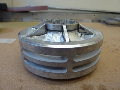

mark lawson
Posts: 487
Location: Solihull
Has liked: 1177 times
Been Liked: 84 times
Post by mark lawson » Mon Apr 03, 2017 9:27 pm
Here are my own idler wheels they need finishing off, I know there is work to be done on them before they are fit to be fitted.
Werkstatt - 5 Panzer parts. werkstatt.five@gmail.com
RAG Militärmodellbau
IG Militärmodellbau

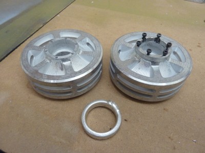

Bodo Langbehn
Posts: 109
Joined: Wed Jan 06, 2010 11:07 am
Location: Germany Black Forest
Been Liked: 3 times
Post by Bodo Langbehn » Mon Apr 03, 2017 9:56 pm
Hi all,
sorry, I cannot resist to post my scratch built Panther A idler wheel too!!! :lol: :lol:
Cheers Bodo
