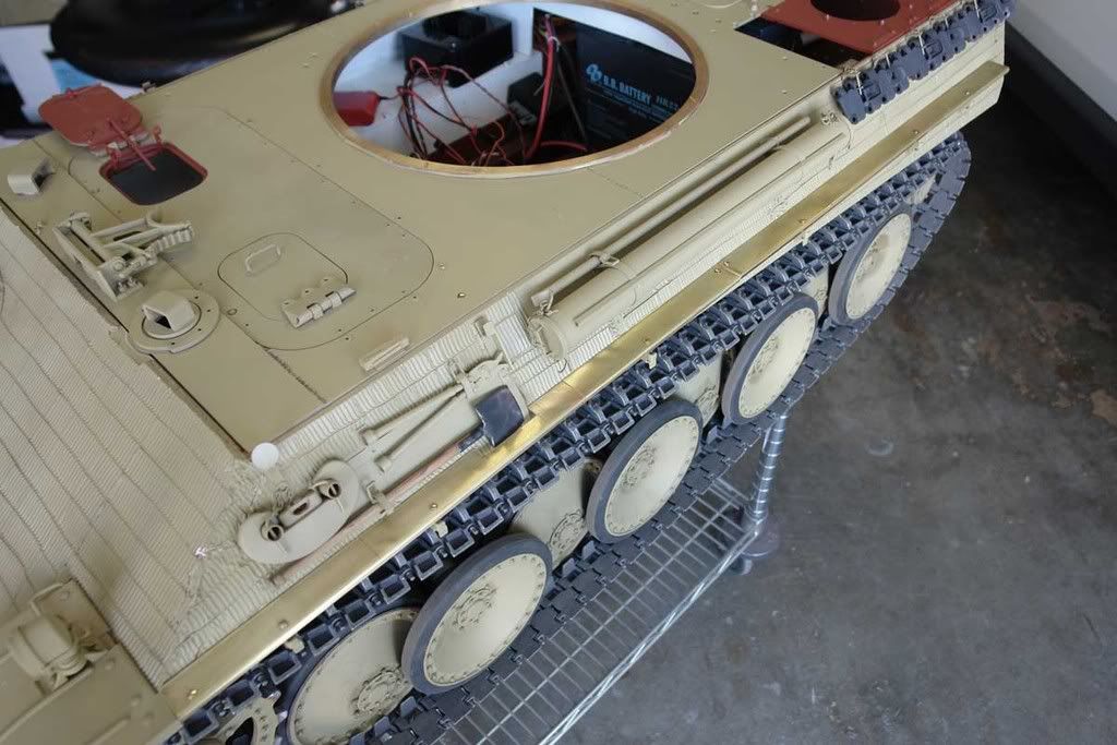

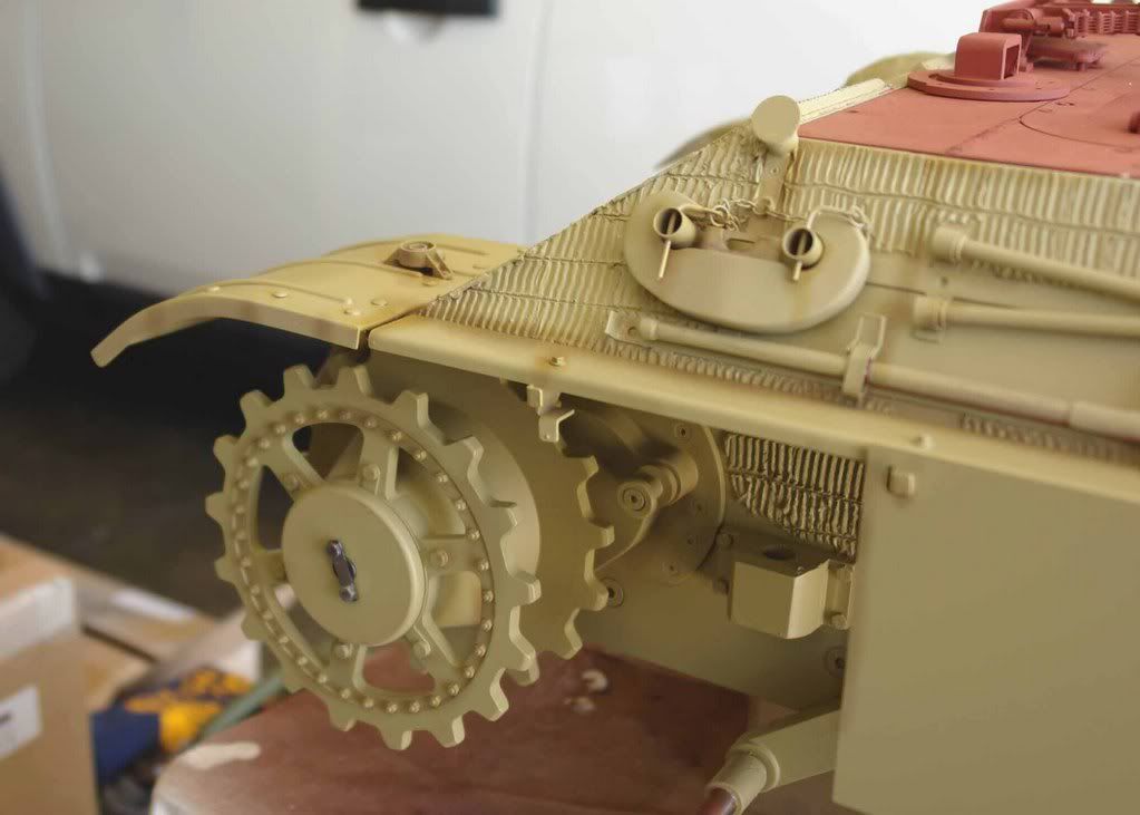

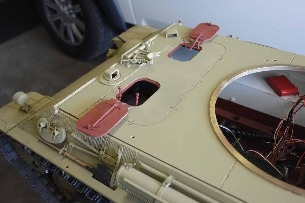

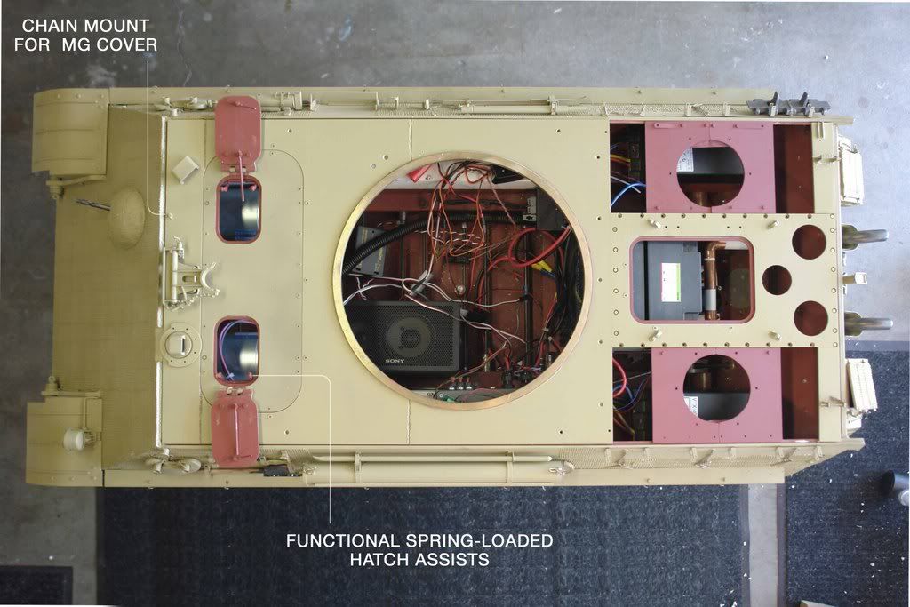

The armor at the very front of the deck is slightly thicker then the rest and had a weld on it's back edges and sides. Think I only added a 2mm plate there but can't remember exactly.
The glacis plate corner does extend up past the forward deck height. Its simply at a right angle to the glacis front plate. Thought I had that addition shown on my old build but I couldn't find it. Mine was done by simply epoxying an angled piece of brass along that top edge, flush with the front plate. Some filler and paint and it looks like it is part of the glacis.
Some pictures that show it. (NOTE: The first three of mine are early photos and the deck plate had not yet been added since at the time I was wrestling with the same question you have. But, you can see it on the last one) :)
The corner is notched at the driver's vision port for obvious reason.
I'm sure someone has done this much better then I have but as no one replied yet to your question....
