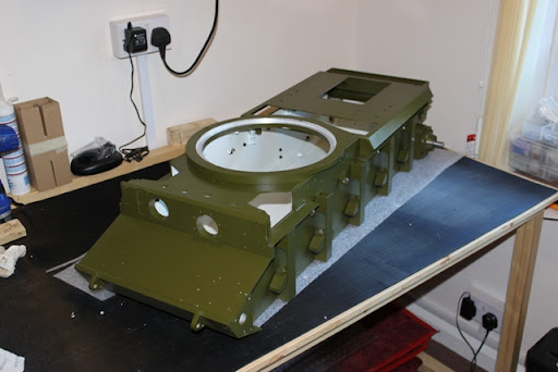

Got mine too.
John Davie
Posts: 97
Joined: Wed Jan 13, 2010 9:55 am
Postby Derek Attree » Thu Sep 09, 2010 8:48 pm
Wow John
Thats a quick build. Looks real nice and the colour
is great. 8)

Postby John Davie » Thu Sep 09, 2010 10:19 pm
Hi Mick,
I'll think about creating a build log thread with photos.
I had to lay some paint on it as you get to the point where places will become inaccessible as the build progresses so it was a case of pre-assembly of the inner hull making everything fit nicely then disassemble some of it to get the first paint on then re-assemble.
I use cellulose (automotive) paint sprayed with a full size car spray gun - I prefer this for the base coates as it covers well and is touch dry within five minutes!! The colour is British Olive Drab, BS298 with a slight sheen finish. I get this colour-mixed by mail order for around £20 per litre and although I use spraying cellulose the supplier does make up aerosol cans as well which I think are around the £9 mark for 400ml.
If you want my supplier details then let me know and I'll dig it out.
