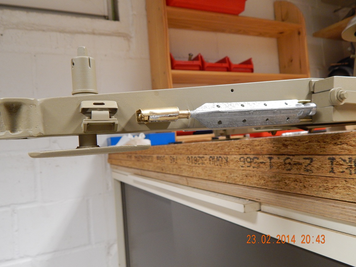

Some small news from "Kölle alaaf" :lol:
Next week starts the "crazy time" in Cologne and I'm sure to be pretty busy with certain "beer quality checks" with my buddys at our local pubs :roll: :lol:

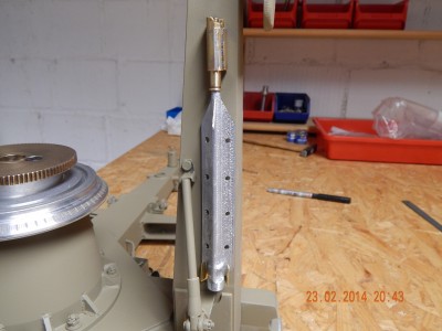

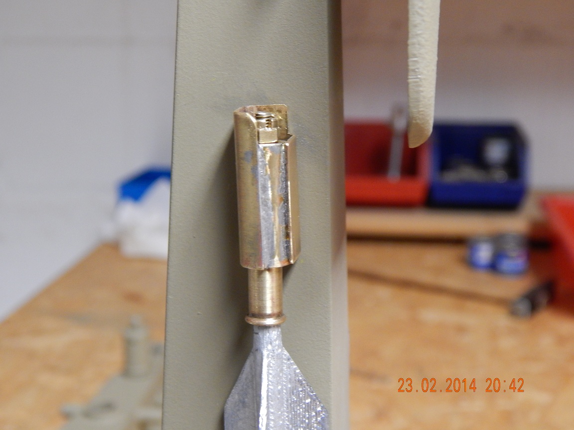

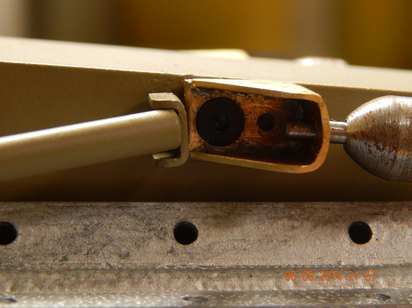

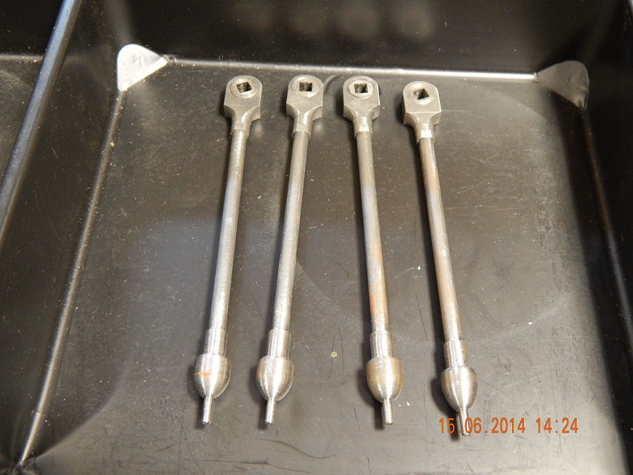

Over the weekend I could realize my "interpretation" of the spring-loaded spike holders on the folding arms.
Turned out quite nice thanks to a local shooting club, some used smal .22 cal shells and Steve's excellent castle-nuts 8) :D
The weldings and paint will foillow once the still missing tools and its holders are ready :roll: Hope I can convince Steve to make me a Set of these excellent leveling tools :idea: :wink:

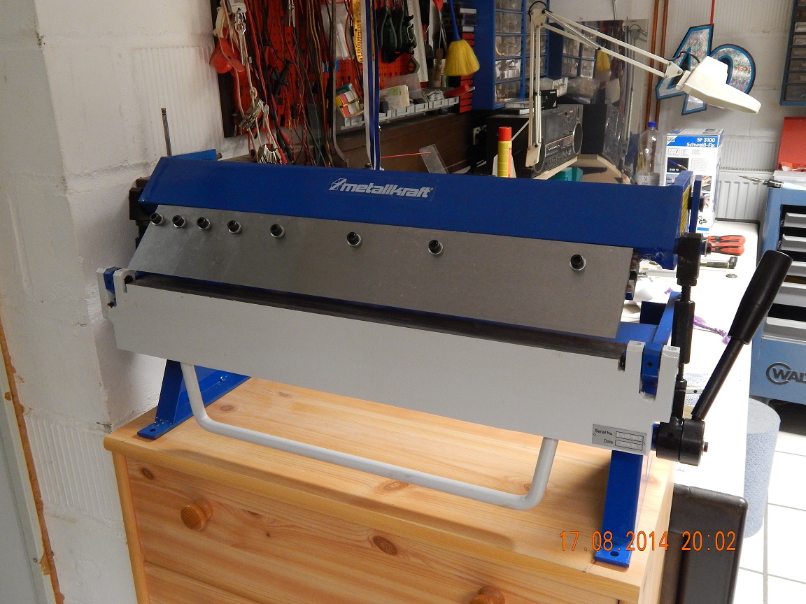

Post by Uwe Gerstenmayer » Mon Aug 18, 2014 10:07 pm
Just to say a quick "Hello, I'm still alive !" :lol:

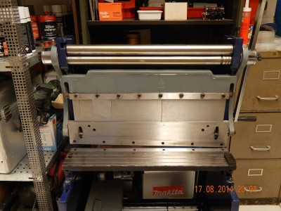

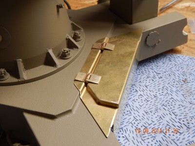

My wifes Priority "Kitchen-KIT" turned out in a complete house conversion and took all of my rare time over the last month... :shock:
At the end we're all quite happy now and inbetween my travels there is now again some time left for my hobby :D :D
Last week I got after "endless time" my long desired tools to create some sheetmetal parts 8) , so the missing boxes on the cruciform are the next little projects :D
A long time ago now I received as well the excellent first upgrade sets from Tim and the brilliant tools from Steve. So for the next weekends there is for sure a plan to go ahead again with my Flak :idea: :D

heavy stuff universal 3 in 1 machine
my little new bender

Post by Adrian Harris » Mon Aug 18, 2014 10:53 pm
Even so, it was nice of you to buy her a mangle, or is it a large pasta roller :?:
:lol: :lol: :lol:

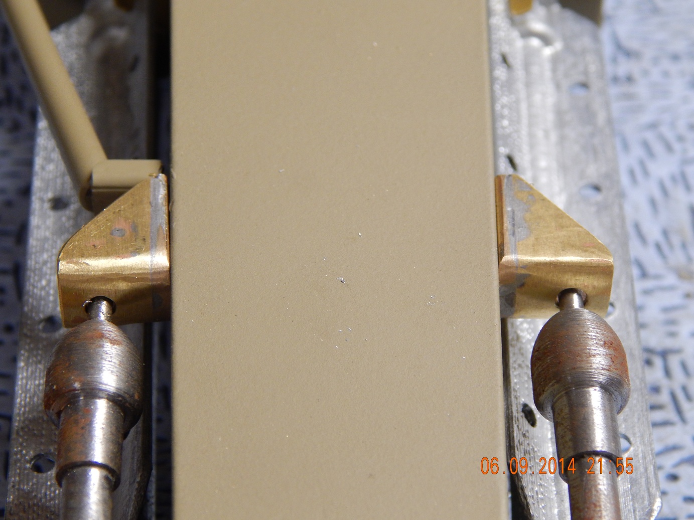

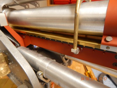

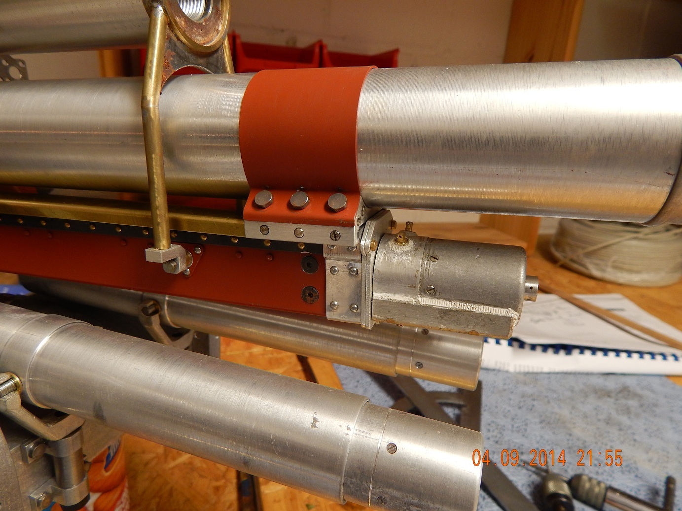

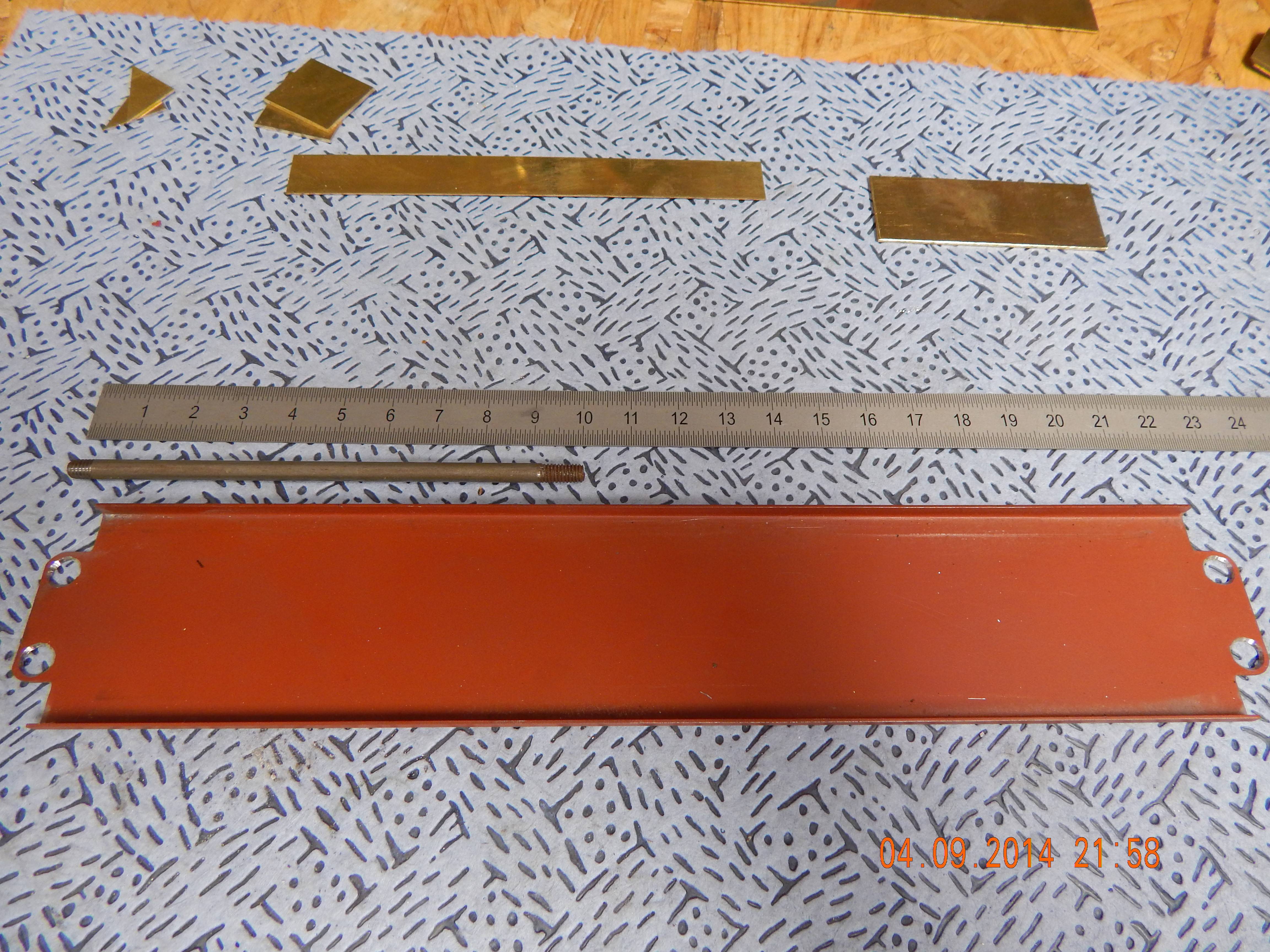

Post by Uwe Gerstenmayer » Thu Sep 04, 2014 10:29 pm

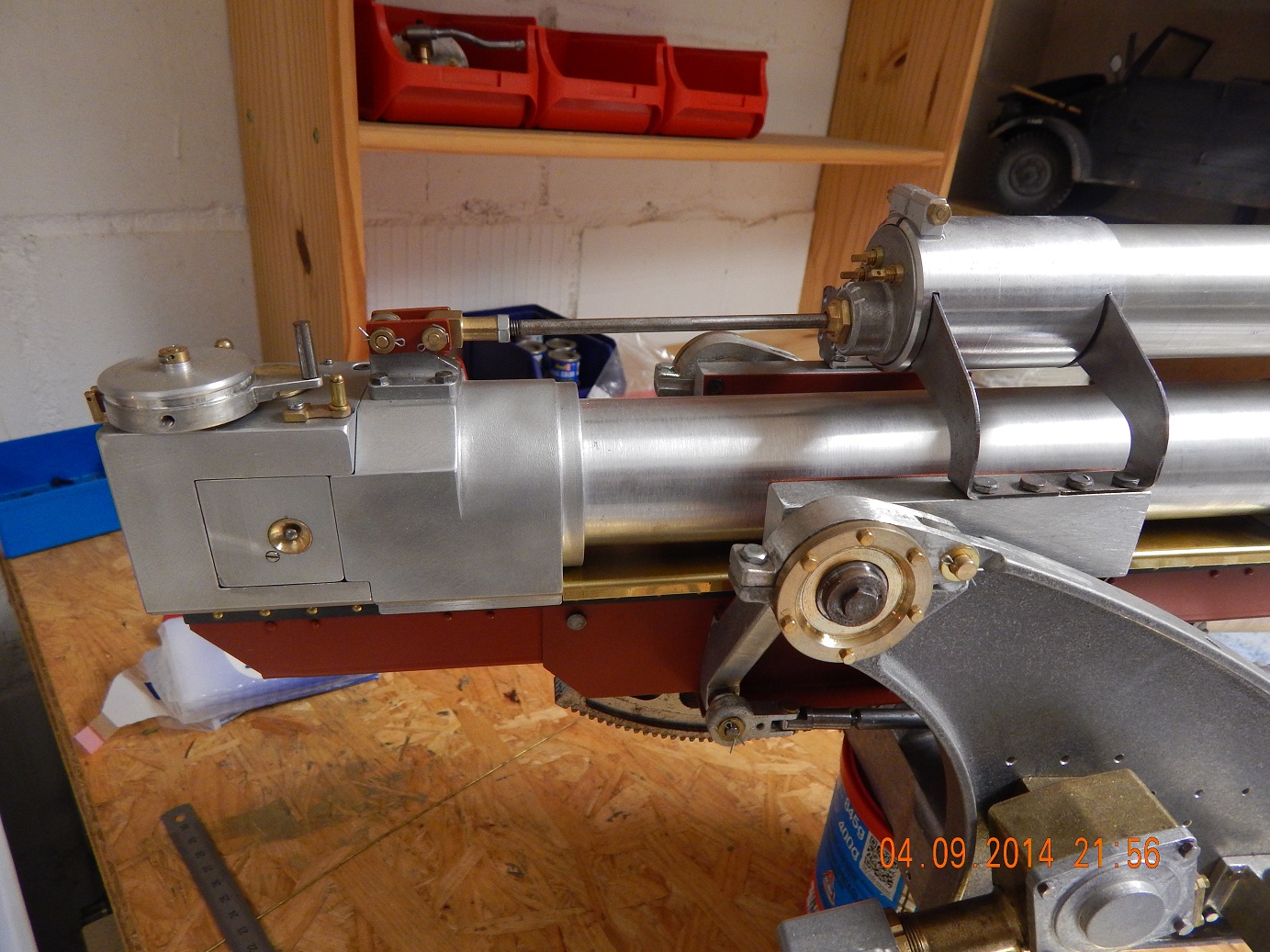

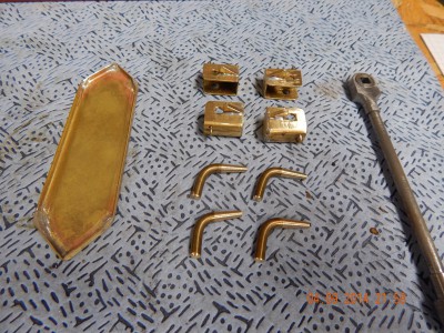

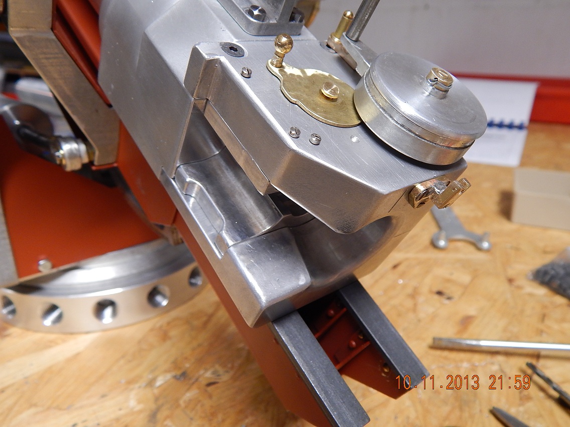

After a longer break and the recent arrival of my "mangle" and the bender I've been curious what I can do with it and had a start.., No Noodles, no Pasta :shock: :lol: :lol: .
The last days I could realize to increase the gun travel and better end-positions on the gun carriage.
I made a new longer cover, enlarged the bore in the "Rückholer-Zylinder" by 40 mm,and replaced the piston with a longer one.
The top end position is perfect now and the lowest recoil point is much more to the real one now.
My brackets for the leveling tools are in good progress, and will be finished once its bolts and locking mechanism is finished. Just had a start on them with the rough contour..
My little E-Box Cover for the cruciform is ready except the hinges. Here I have to look for some suitable ones :idea:

Cover and piston replaced with new ones
new made longer carriage cover 1,0mm brass
Lower position before the changes
Lower travel end position now
Top end gun position before
Top end gun position now
e-box cover and the tool brackets in work

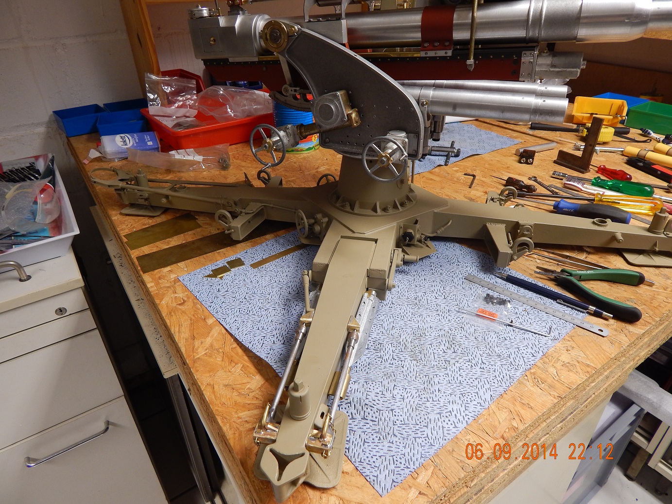

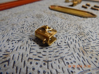

Post by Uwe Gerstenmayer » Sat Sep 06, 2014 9:56 pm

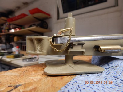

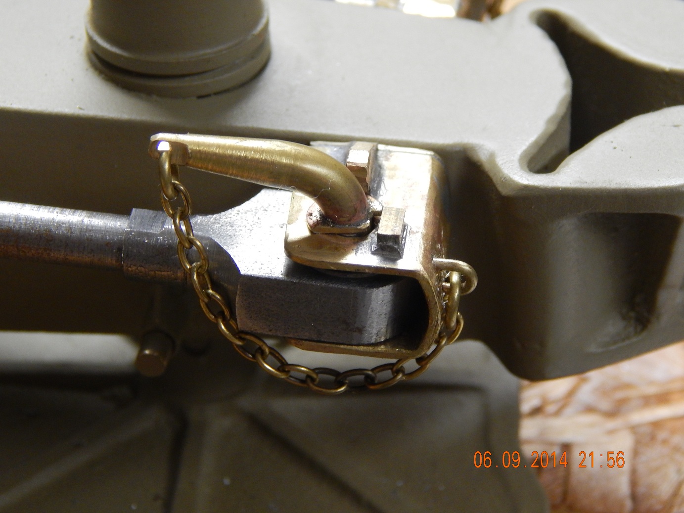

Today I made some progress again on the cruciform :D
I could finish all the brackets for the Leveling Tools and fitted them to the folding arms.
I'm pretty happy with the result so far. Thanks again Steve, the tools are looking that good now on the folding arms 8)
Some paintwork and the weldings will come later then :D
The front bracket details where quite fiddle work, so it took me a bit longer :shock: :lol:

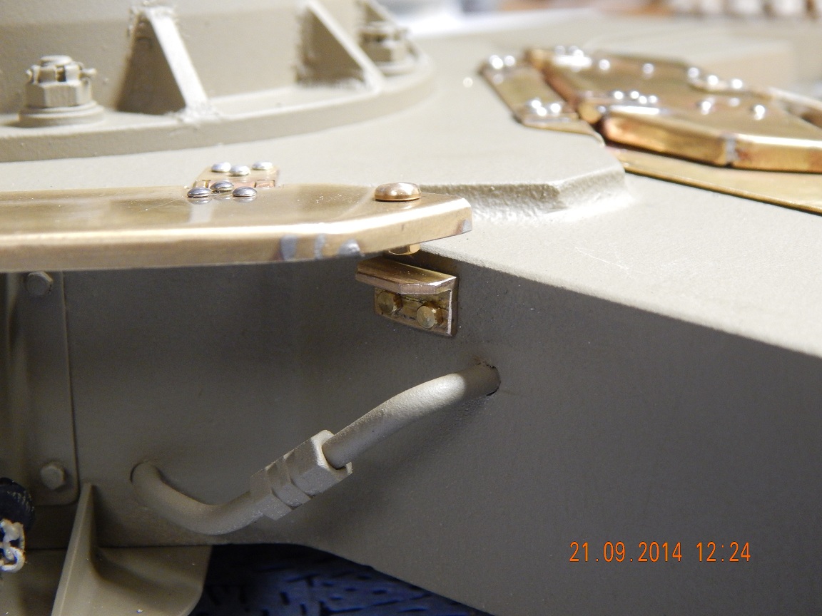

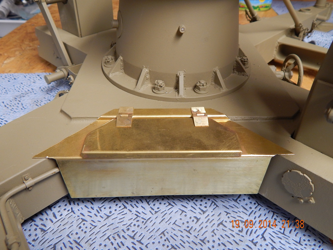

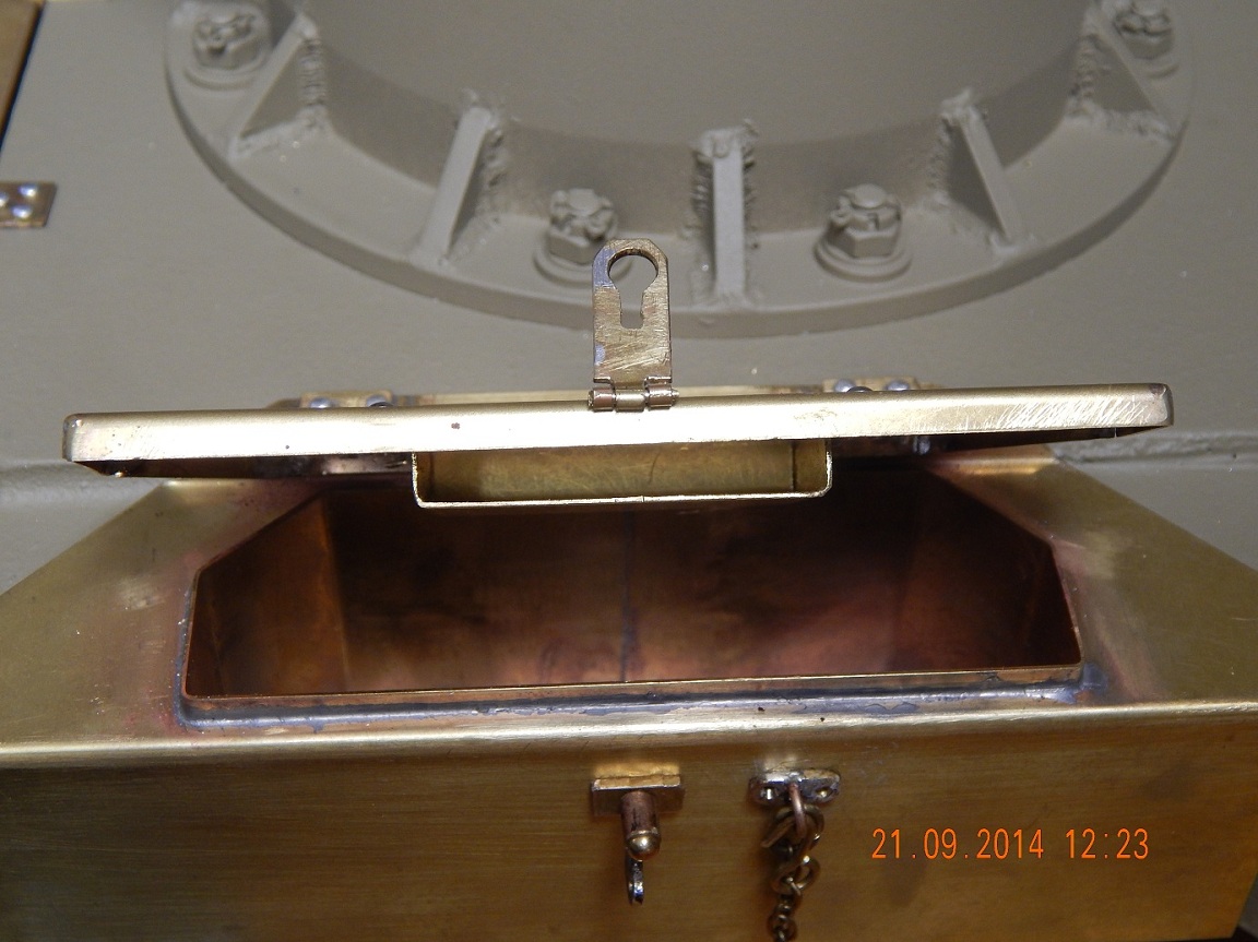

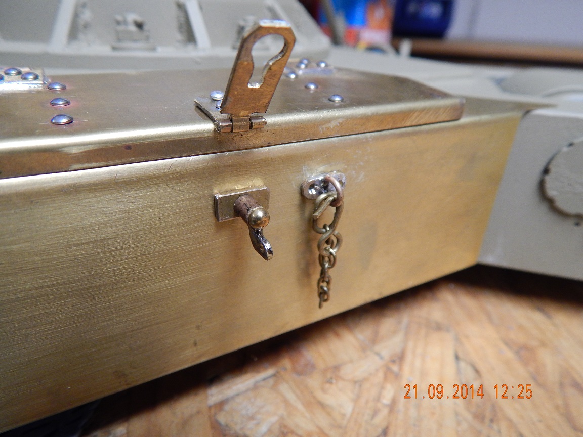

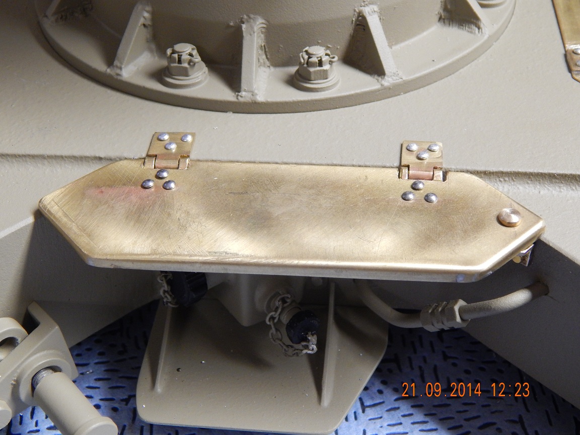

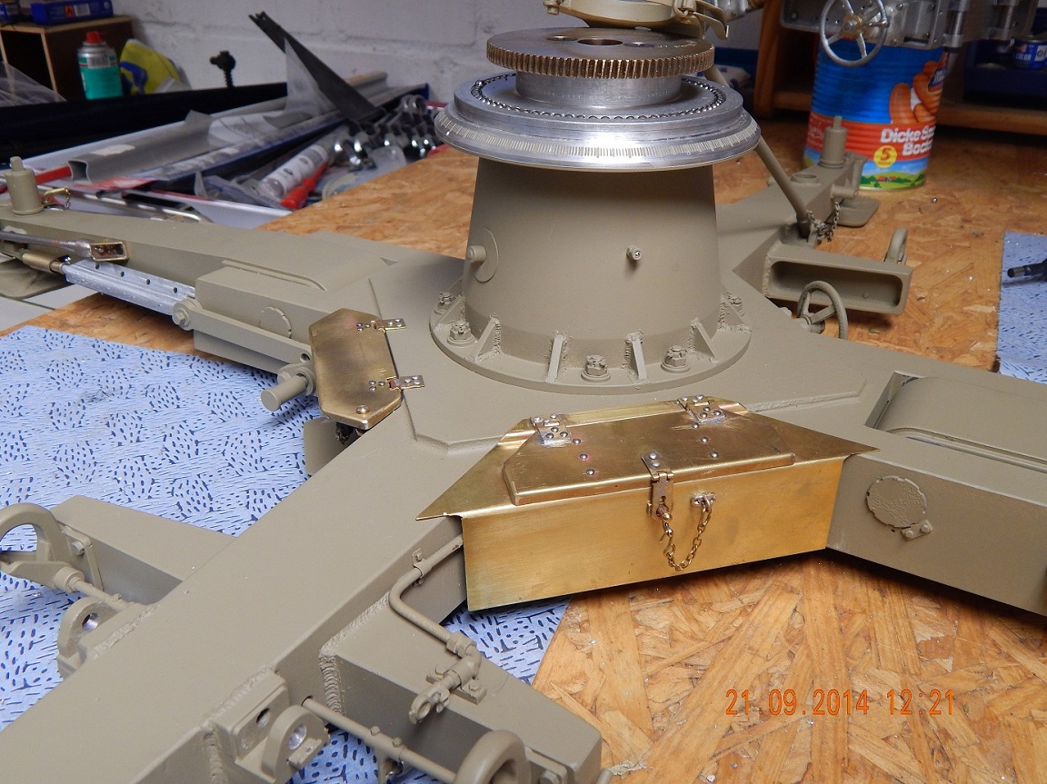

Post by Uwe Gerstenmayer » Sun Sep 21, 2014 12:29 pm
Hello Adrian,
Thx for the flowers :) Confirmed now not to be used for kitchen stuff :lol:

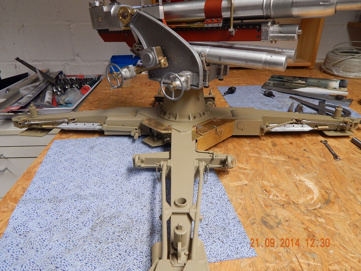

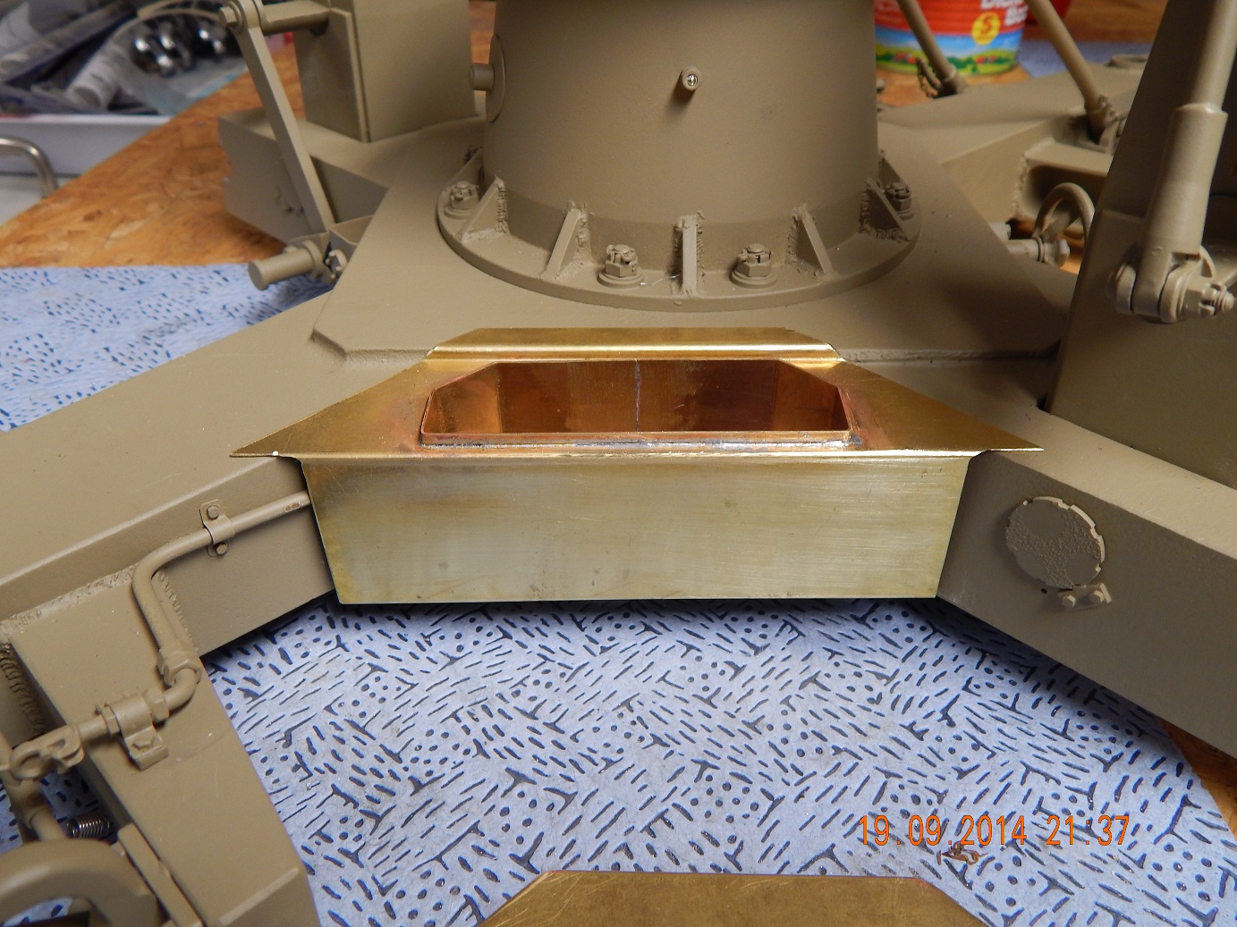

Yesterday I could finalize the work on my chest and E-Box Cover :D
I'm pretty happy with the results so today just a bit clean up and at least some etch primer.
The hinges and "locking pin" of the chest have been a challenge :shock: So small , three times flown away , only when my "Mr.Frusti" met the wall, after a cold beer and some good music the fourth attempt turned out OK :twisted: :lol: :lol:
Hope you like the result :wink:

chest locking mechanism and hinge made
chest cover with tray for manuals ??
E-Box Cover attached
E-Box Cover "block bracket"

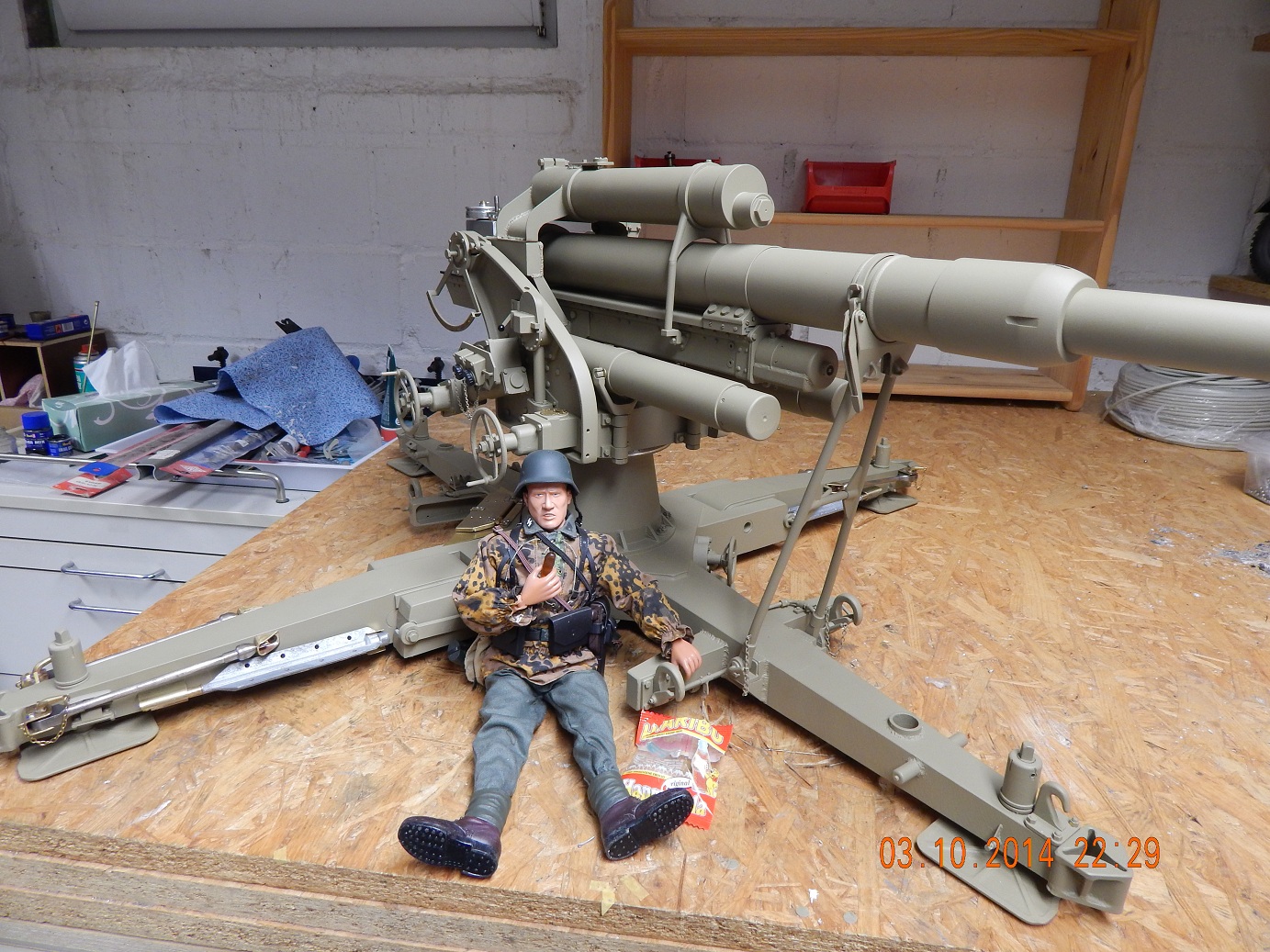

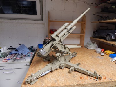

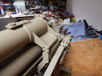

Post by Uwe Gerstenmayer » Fri Oct 03, 2014 11:01 pm

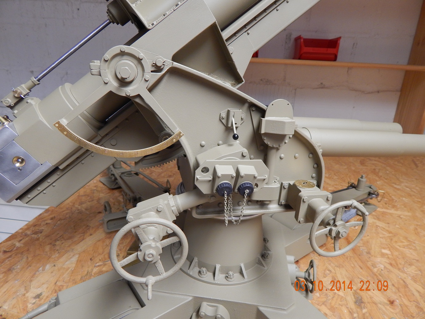

Just a Hello from Cologne with some news. :D

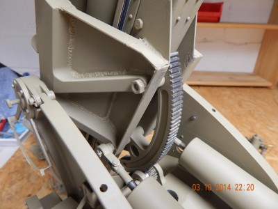

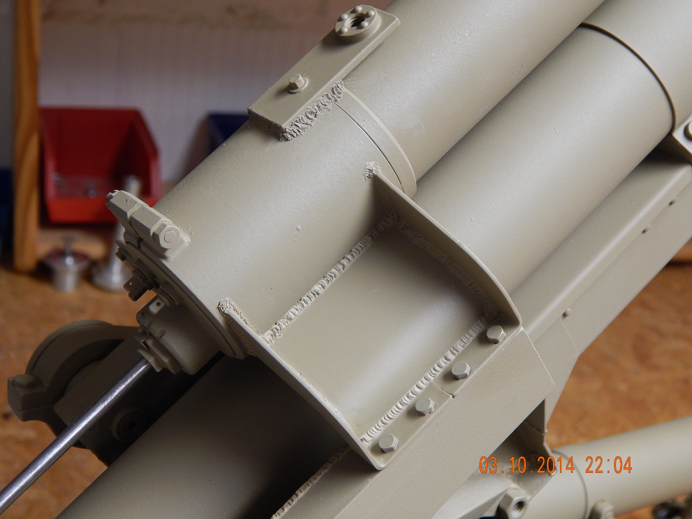

I could realize some progress on my FLAK over the last days.
A lot of small bits and pieces but the major one was to get the base paint work done :D
Still just pre-assembled to the cruciform since there are the base-levelers still on the bench, but now it looks much better and I'm quite happy with the results so far.
I ran out of paint so there is some time left for the other small , looks like never ending, bits and pieces to be done :wink:
Hope its still of interest and you like it,
cheers,
Uwe
Here's my FLAK as it is now , quite happy with it :-)

Lots of Weldings made on the gun now
Coverplates made of 0,2mm brass
Coverplate and tube made lhs
Time for a break now :-)
