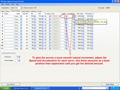

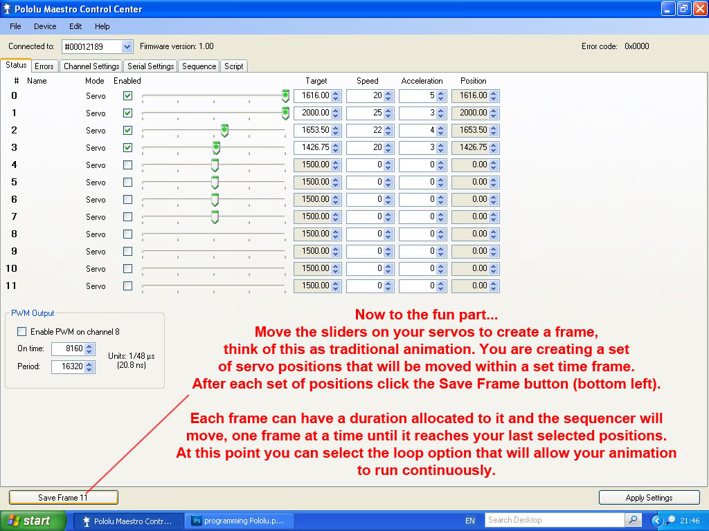

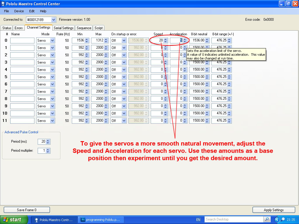

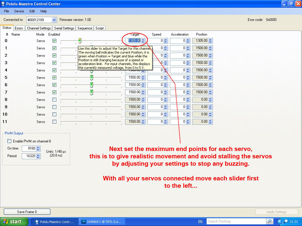

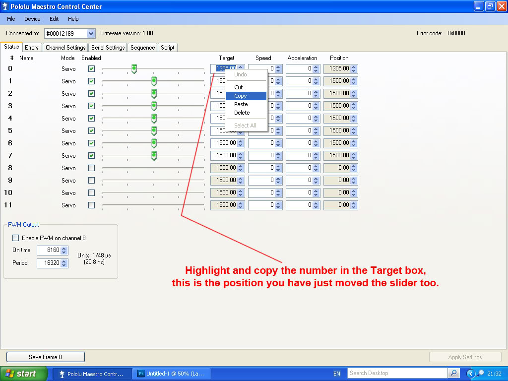

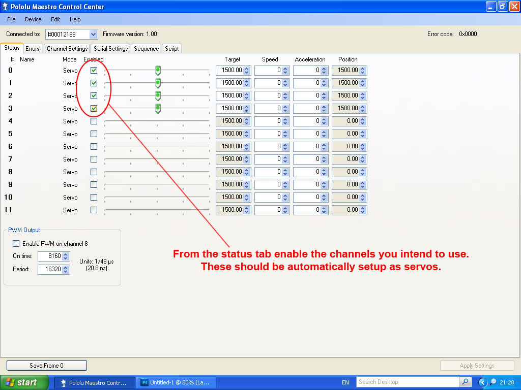

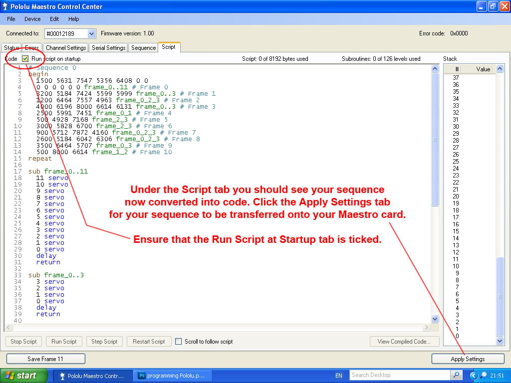

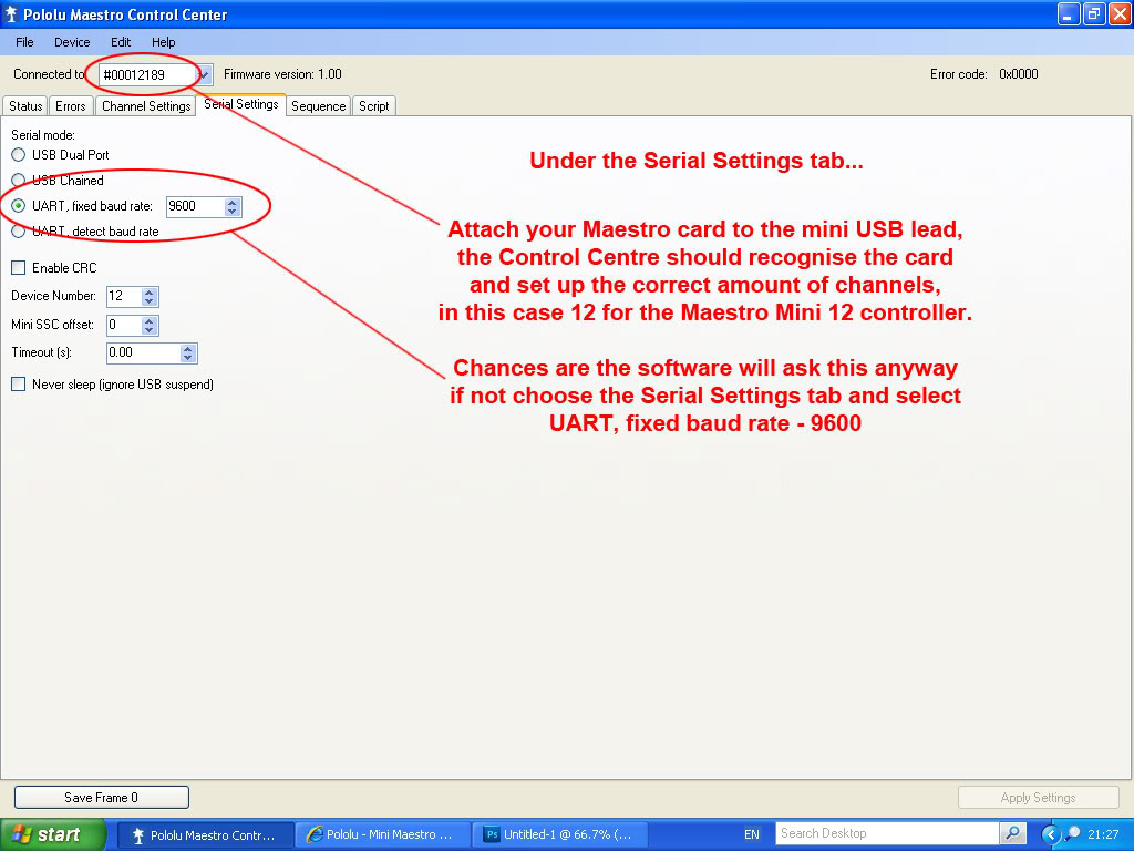

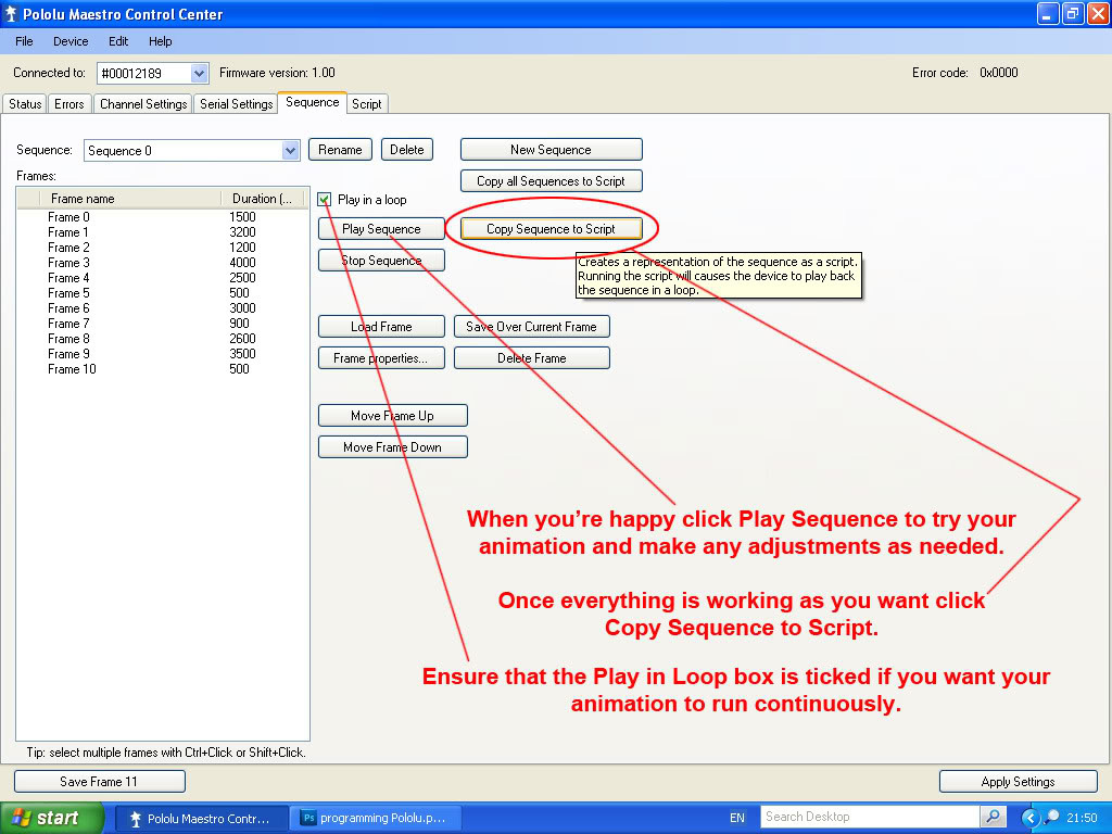

I've eventually got around to posting a basic How-To for the Pololu range of Maestro controller cards. You'll need the software and drivers available free from the Pololu website.
I don't profess to be an expert with these cards so if anyone has any input regarding their experience then please jump in. Similarly if you require further explanation on any or all of this thread then post your questions and I will do my best to help.
Once I've finished programming the latest figures that these screenshots were taken from I will share the file in case anyone wishes to use it.

I followed this processes from Sym, and got some tips from a professional I know, one thing he pointed out to me, some moves are better made together in one frame, i.e. binocular arm down, head turn, this then leads to the next frame for the body turn in the same direction as the head. I was told, if in doubt go through the moves using your own body, and you will notice that when you turn, your head always leads. This lead to what I think is the smooth programming of my tank commander.

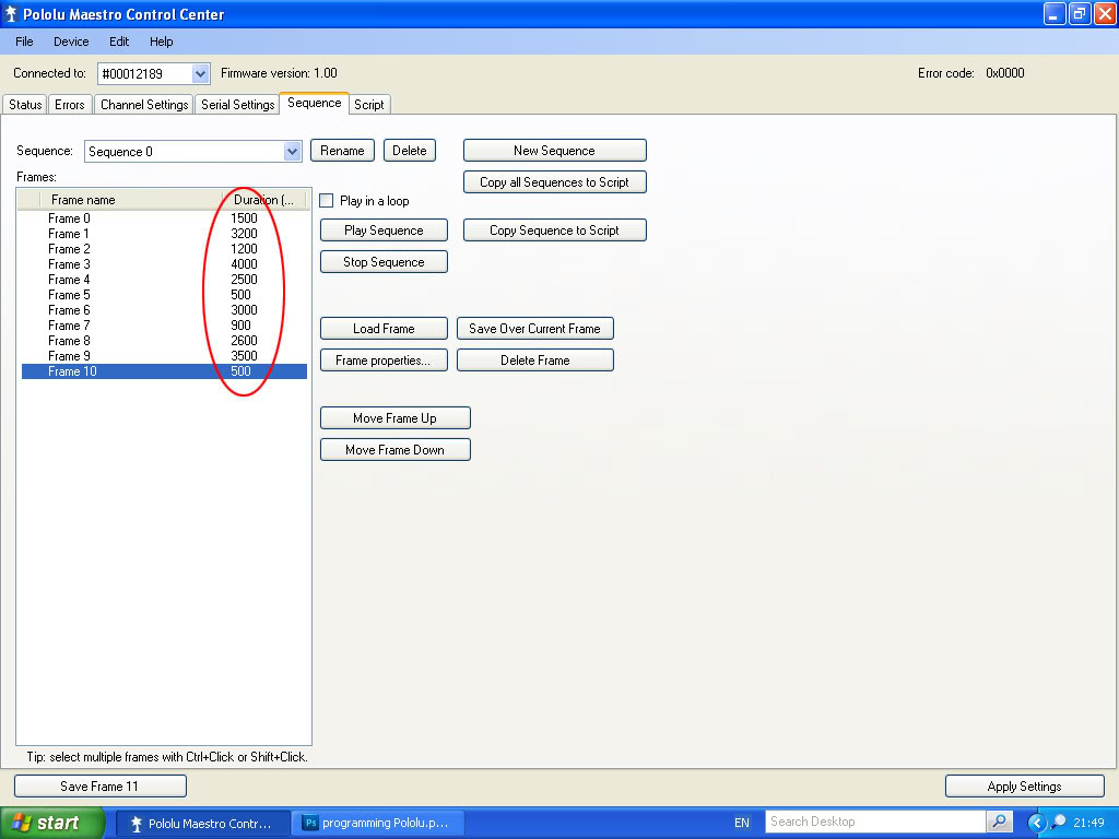

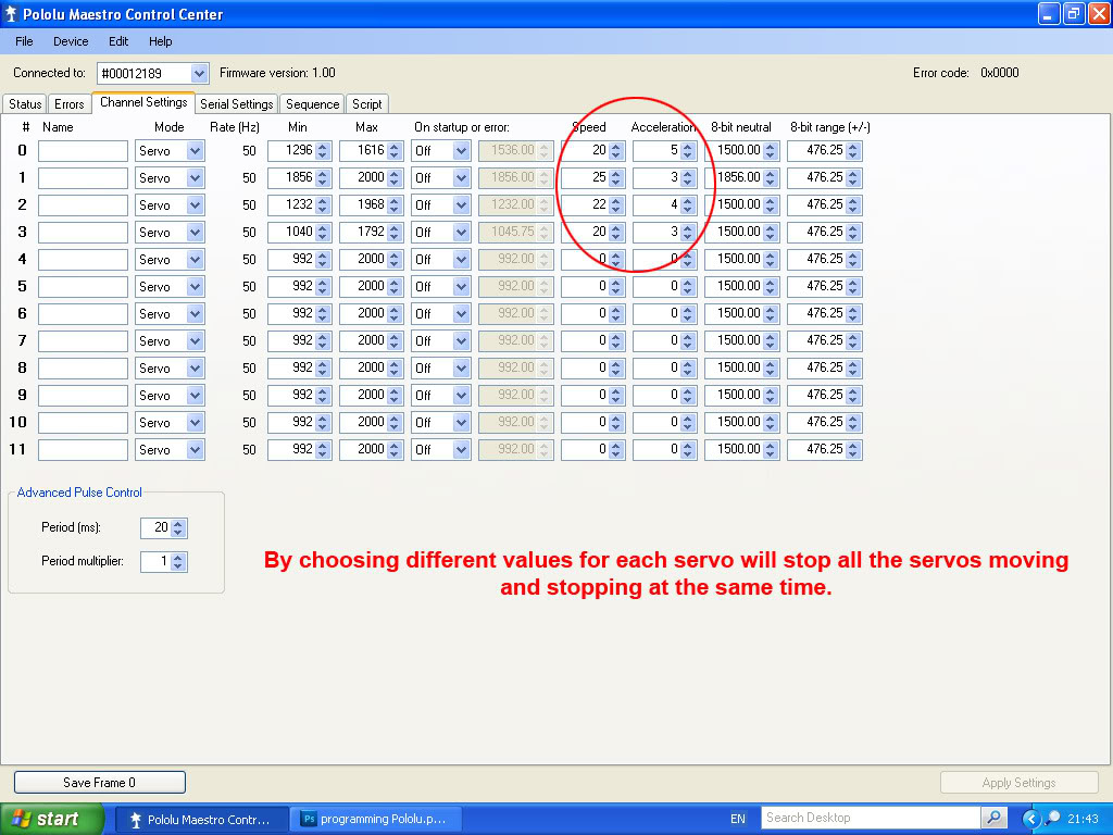

One of the moves I like is to turn the base one direction with the head moving the opposite, in essence the head keeps tracking forward while the body turns. Then on your next frame swing the head around to match the body.
Also if you have 2 frames with different servos on each try setting the duration for each frame to a low value, say 500ms. This will give an overlap of movements that will give a more fluid look to your animatronics.

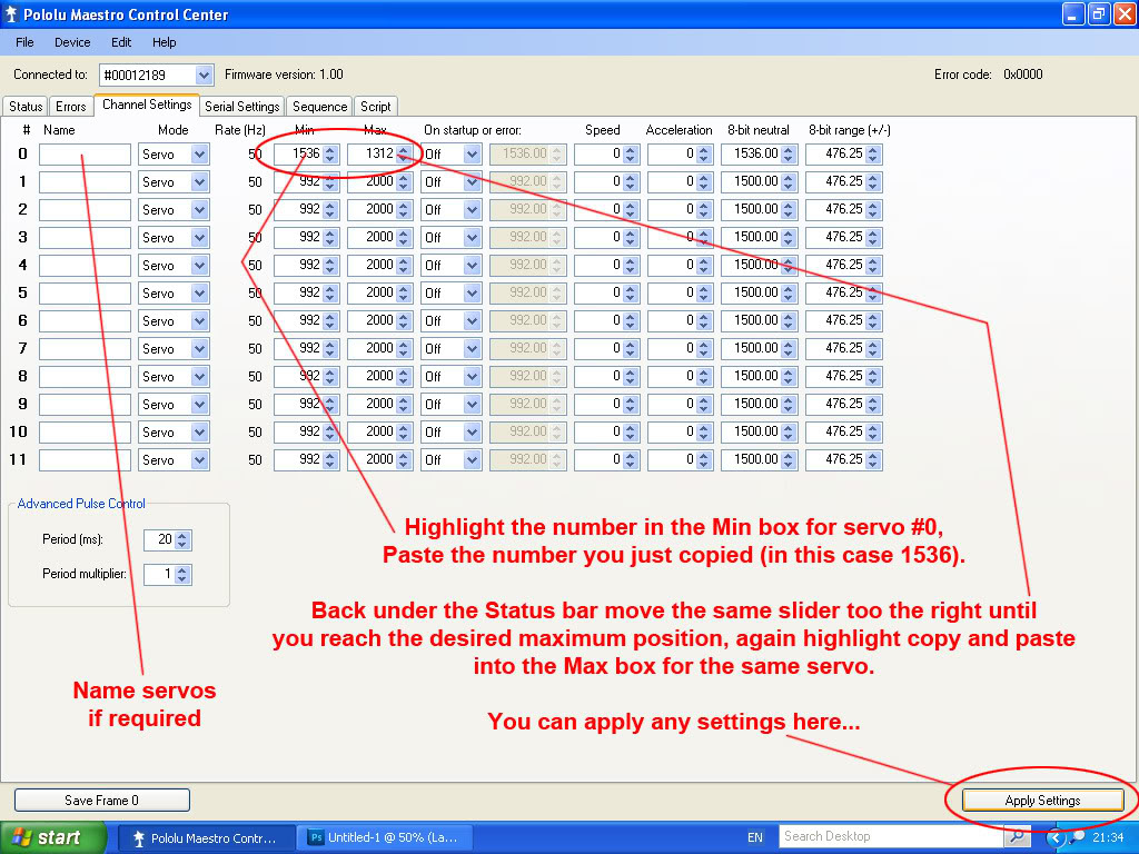

Post by Churchill Creations » Thu Aug 18, 2011 8:13 am
Another point worth mentioning is that of end points. The program has preset values of 995 and 2000, these aren't maximum throws.
While setting up the binocular arm on a figure I was struggling to get maximum movement due to a thick leather coat over the joints. I shortened the servo horn to increase torque through leverage but found the servo throw was now insufficient.
By making the lower value 60 and the higher value 2400 I now had all the throw I needed with increased power to overcome that ******* jacket! :D
Be sure that you only use enough throw to do the job as pushing a servo past its recommended end points can cause problems. Obviously any buzzing is going to put the servo under undue stress and increase load.
Sym.
