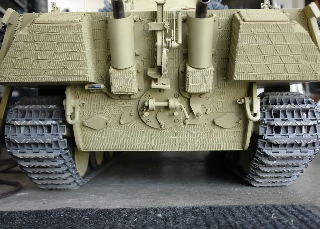

Post by Tim Bowman » Thu Feb 28, 2008 3:58 am
Hi everyone

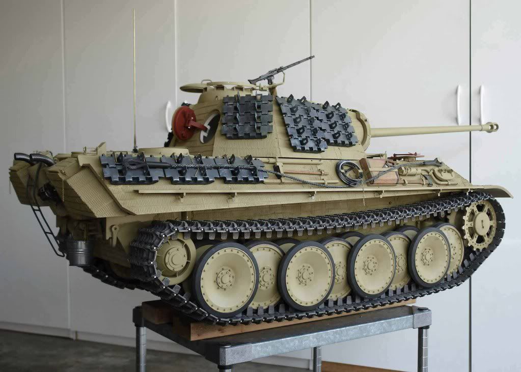

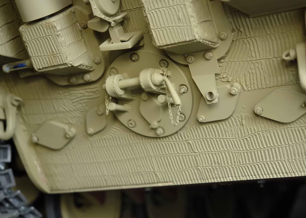

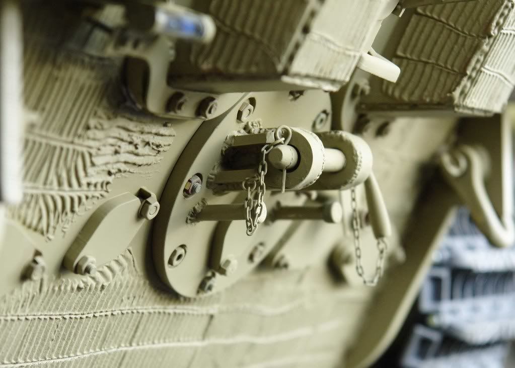

I finally got around to finishing my engine access cover. The mounting bolts will be evened up this weekend. :oops: plus I did some other detailing I've been procrastinating on. Starting to think about camo pattern. : )
I know the starter posts are not correct but I'll fix later.

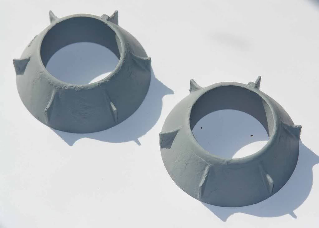

The center piece for the idlers are texture and I will be putting cast numbers on one of them this weekend then into the mold. Still waiting to hear back from a machinist on the main part. My texture is not as good as yours Kent but I referenced as many real photos as I could find and did my best.

Post by Dale jordan » Thu Feb 28, 2008 5:06 am
Amazing workmanship Tim . I can't wait to see the camo!!!. Tim has your right hand fake weld cracked .. Where your side hull plate meets the rear plate ???? Dale
Tim Bowman
Posts: 1756
Location: Northern California
Been Liked: 2 times
Post by Tim Bowman » Thu Feb 28, 2008 5:31 am
Hi Dale
Good eye. It's along and horrific story but I'll make it short. Several months ago my Panther had a spill off the stand that it's on in some of my other photos. 18" off the ground onto concrete. Bone headed, Rookie move on my part trying to adjust radio settings while Tank is sitting on it's tracks. (Usually, I had it on blocks) It launched off the stand with one track at full throttle in a hard left turn. Made quite a sound at 11:30 at night as it contacted the garage floor.
Good news. It actually sounded worse then it was and damage was minor. Some suspension had to be reworked and the right hull side separated. I had to re-fasten it as best I could. The gap is what is left. I'll fill it.
OK, it wasn't short after all. :lol:
I won't make that mistake again though! :oops:

I just love to watch your photos of that truly amazing Panther.
The zimmerit is spot on and I simply love that tank and the work you put in to it - awesome, and a huge source of inspiration for me not coming quite so far in my own build... :oops:

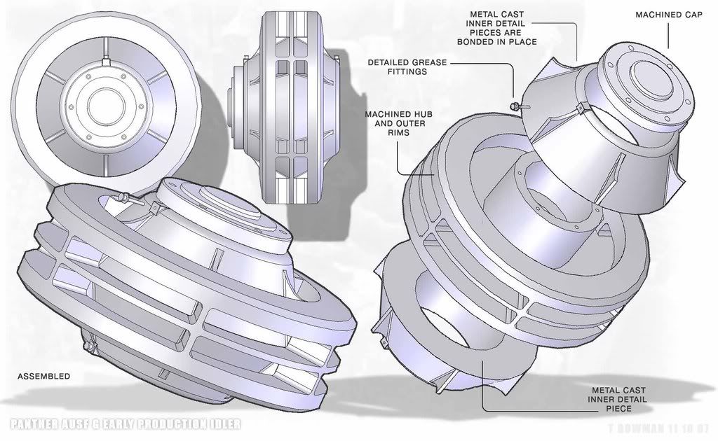

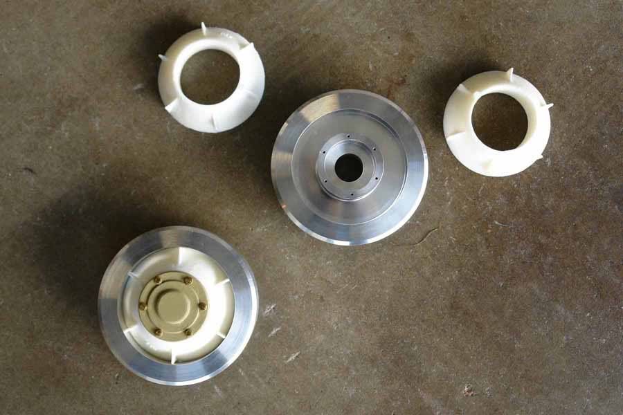

I needed a break from work today so I finished these up. They are part of a multi-piece design I did to save some cost on these idlers. These parts are the center piece of the idler that will be bonded to the main, machined wheel. They slip around the hub center and the spokes line up with the ones on the machined parts.(per drawing). The end result is a descent representation of the real thing but not 100% accurate. It's a compromise.
I attempted to make one of them sort of rougher then the other that way when mounted, I can choose which side faces out. Working on grease fitting plugs tonight and they will be a separate, removable part. Sorry for so many photos.

Wow Tim!
That idler will be a masterpiece - absolute stunning!
That cast surface is spot on.
Not 100% accurate? My friend, not even my eyes :wink: can spot were you have cut corners.
Very, very well done!

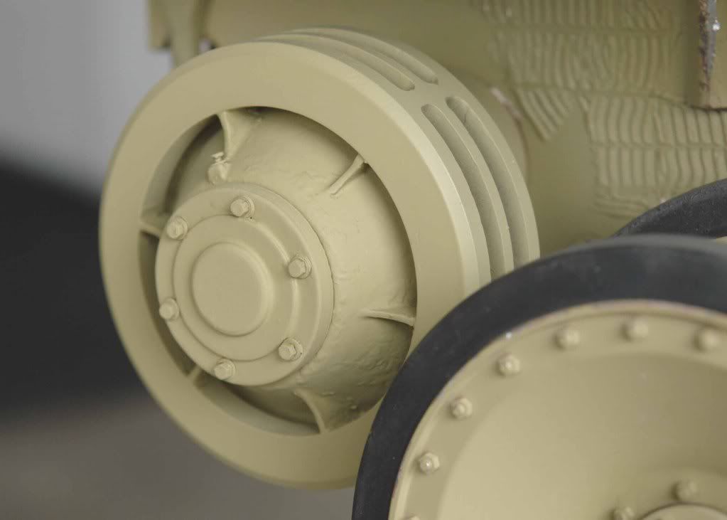

Post by Tim Bowman » Sat Mar 15, 2008 11:59 pm
Making progress. Like a herd of turtles, but progress. :)

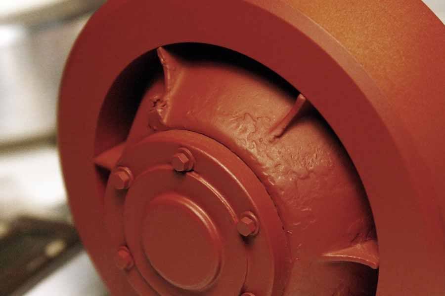

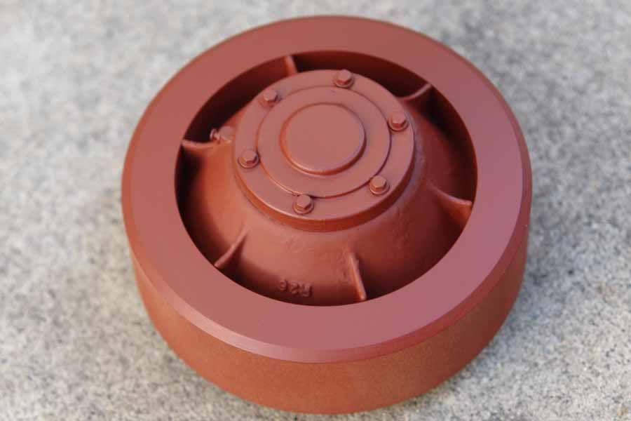

Fist step, fit proto machined wheel to cast hub-centers. Thankfully, it fit perfectly.
Next step, machining the slots/openings around the perimeter. Hopefully I'll muster up the courage to do that this week.
With grease fitting and some quick primer. I couldn't wait to see what it looked like.
Kent Wiik
Post by Kent Wiik » Mon Mar 17, 2008 10:38 am
Absolutely fantastic!
That idler is one of the top 5 1/6th tank parts I have ever seen.
It is hard to see that primed one of yours is not a 1/1 relic - stunning!
Your skill in this is amazing.
Kent

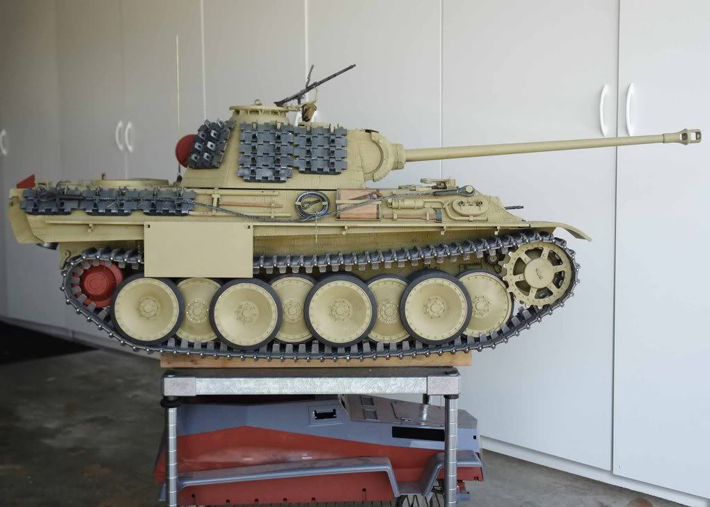

Post by Tim Bowman » Wed Mar 19, 2008 10:00 pm

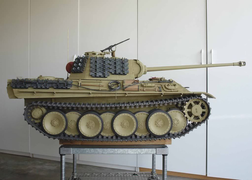

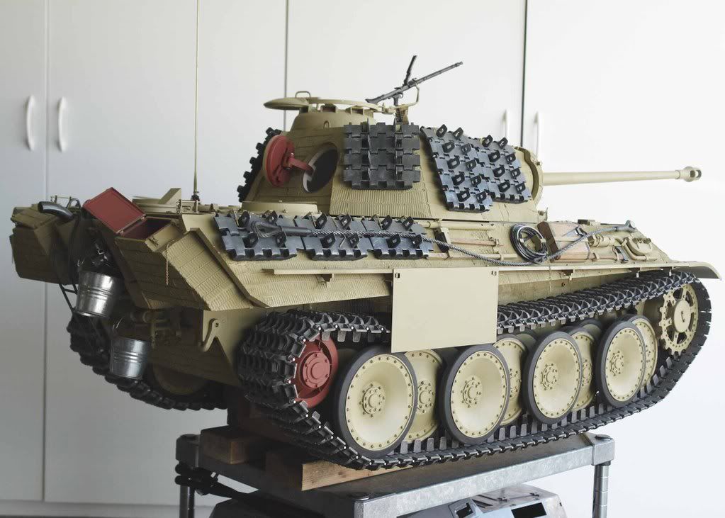

Thanks Dale and Kent. By the way Dale, this is the stand it drove off of.
I had to mount one today and see how it looks. Began machining the openings around the perimeter of one of em.
TIm
Kent Wiik
Post by Kent Wiik » Thu Mar 20, 2008 10:45 am
Very, very nice!
Your photos are candy for my eyes :oops:
Has now that mid photo as my new screen background.

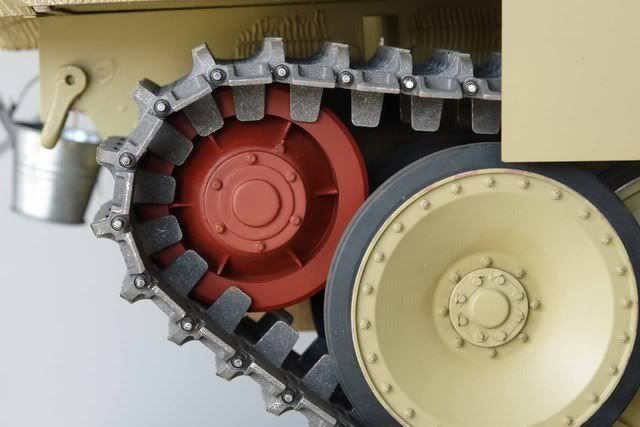

One tiny thing - the inside of the loaders hatch was painted Dunkelgelb on zimmerited Panthers.
Engine- and storage bin hatches (not so frequently in battle open hatches) had the red oxide inside.
Sorry Tim, just my rivet counter eyes noticed this... :oops:

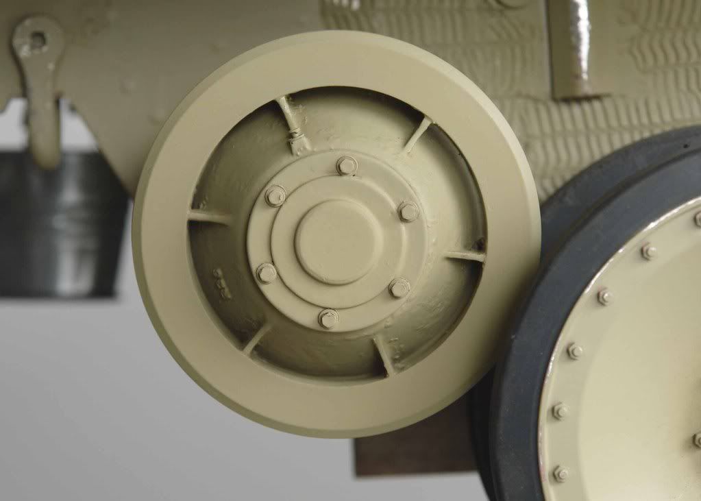

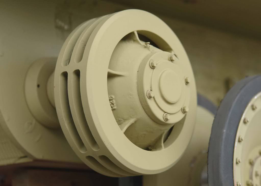

Post by Tim Bowman » Thu Mar 27, 2008 7:44 pm
Slots completed on one and painted. Hope to complete the left idler this weekend and give them a spin! I left more material between the slots then originally planned because the removal of so much was making me nervous.(strength wise) They still look OK and with tracks on you don't really see much of them anyways.
regards
